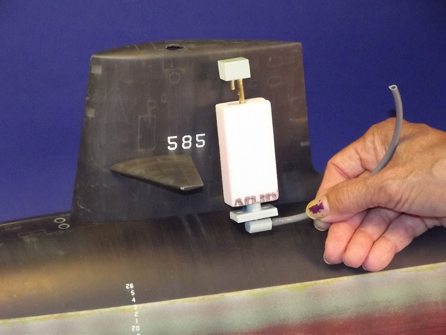

    I would like to know how to keep my snort float free moving. Would I be right to put silicon grease on the main induction tube? Would this need to be done after every sailing?
    Regards
    Pawly
    By 'free moving' I have to assume you are talking about the sliding action of the float with the induction tube running through it. Do not grease or oil this as that will gum up in cold water. Use no grease or oil on the induction tube or the brass tube that makes up the bore of the float itself. If there is binding in the mechanism when it's installed, then you likely the float is making contact with the inside of the sail somewhere.
    If there is binding off-model then run a 1/8" round-file (most big box stores carry them -- used by chain-saw users) through the floats brass tube bore A few strokes, then wad up a piece of scotch-bright pad and push it through the bore a few times.

      Thanks David. Will do that this week.

                            Thanks David, went that little bit extra and Brasso'd both tubes, works great.
