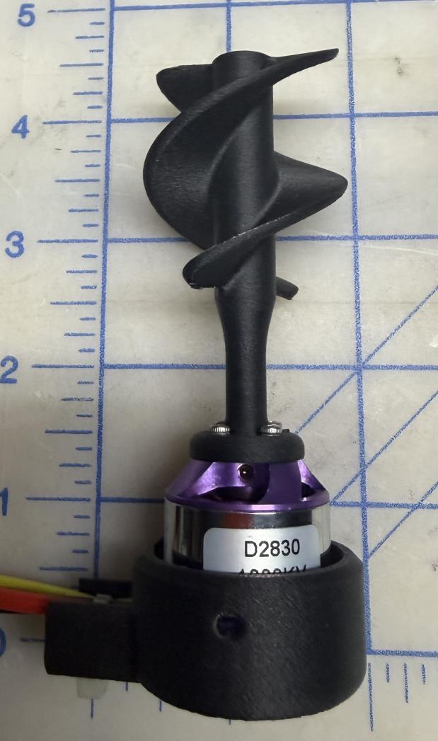

          D2830, 1000kv, 2” diameter, 3”pitch - 3 blades not the two blade pictured Click image for larger version

            That's your problem then. Huge amount of pitch at unloaded speed of 11000RPM+
            You want a motor around 300kv-500kv for a prop like that on 3s. It should still be rapid. or consider an inline gearbox of 2:1 or higher. Also consider reducing the pitch of the prop to square or less.
            Alternatively, with your existing drive train consider running a much smaller diameter and pitched prop, something around 1.5" diameter and 1-1.25 times pitch.

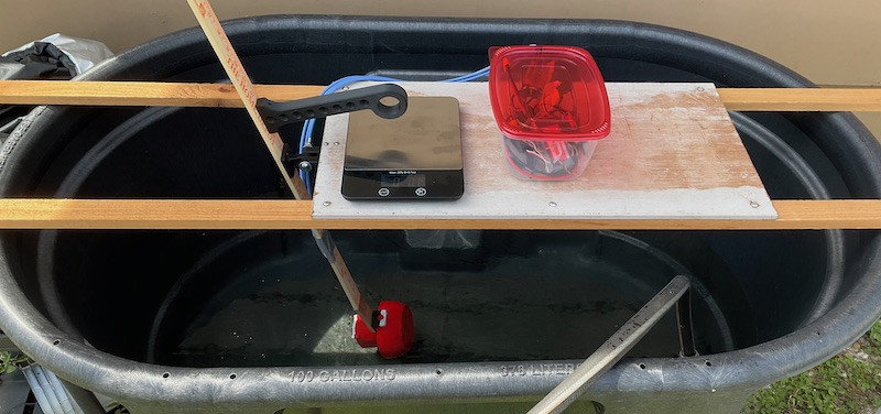

                  Thanks for the info, i wanted to somehow quantify results and came up with a makeshift setup to get me better info. Attach the drive to a yardstick with a pivot, one end is the drive the other end a finger to push on a scale. Add to that telemetry giving current measurements. To start using ~2 inch prop - already have the mount for it. From there modeled and printed two props a 2 blade and a 3 blade - both with the same pitch. the two blade gave almost double the thrust with only 20% increase in current. Now starting with the 2 blade as a reference do another with double the pitch and then finally smaller 1.5 inch diameter to see what is the best balance of current and thrust .
                  Click image for larger version  Name:	IMG_0333.jpg Views:	0 Size:	92.9 KB ID:	197136
                  Click image for larger version  Name:	IMG_0337.jpg Views:	0 Size:	51.3 KB ID:	197137
                  FYI the throttle is being limited to 70% output via transmitter curve. I use the same 650KV motor for my ballast pump , limit it to 25% output and it draws a little over an amp. Anyone else measure current on your drive? what kind of current draw are you geting for normal running?

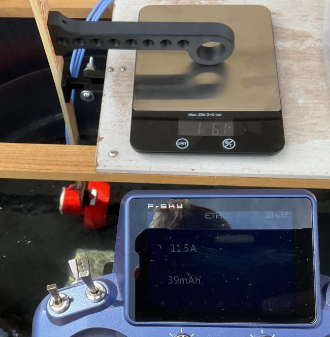

                            Using the feedback here have a rough idea of what to shoot for. So far a 2” prop with a 1.5” pitch has had the best results so far putting out about 1.5 lbs of thrust with about 12 amps.

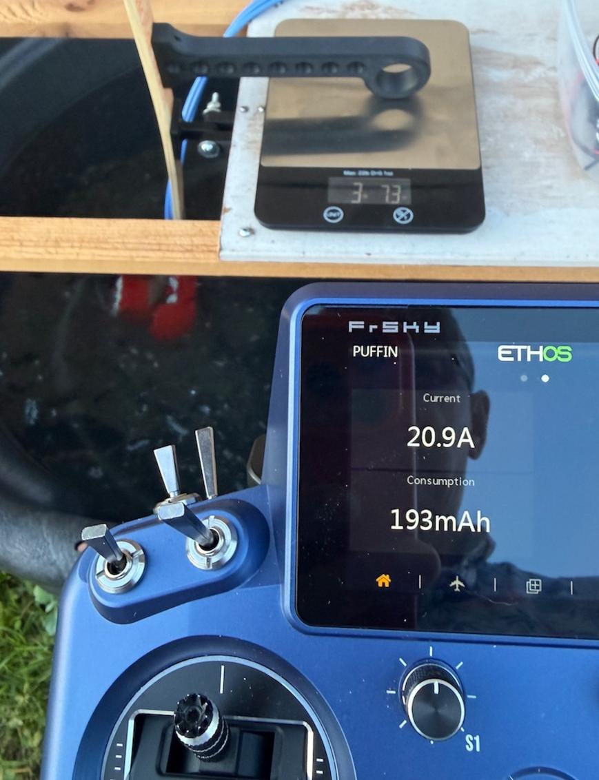

                            After a while googling - started getting help designing a prop only to be corrected that it should be an impeller for a jet drive. something it suggested thru questioning is to have the impeller OD as close to the jet tube ID as possible to minimize blow by. Two simple changes made a huge difference in performance. first increased the length of each blade to complete the circle from the end view - no open free space, (traditional props have about 50% open area) same pitch as above. Second printed the impeller at 2” and sanded the perimeter until it was a slip fit into the tube.
                            his two small changes made a huge difference. Thrust went to about 3.5 pounds (21 amps, max throttle) - not seen in the pic is its bending the yardstick. Taking a couple other points hit 1 lb at about 3 amps, and from that what appeared to be decent flow but less thrust at about an amp.

                              You're going to need some very good batteries to supply 20A with consistency. Does the shroud have some vanes to counter torque roll from the prop, otherwise handling might be interesting.
