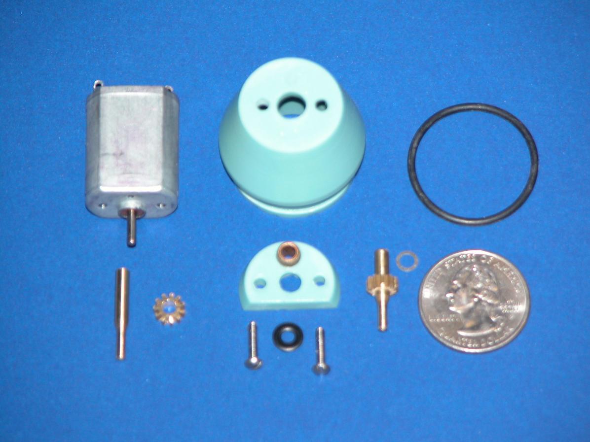

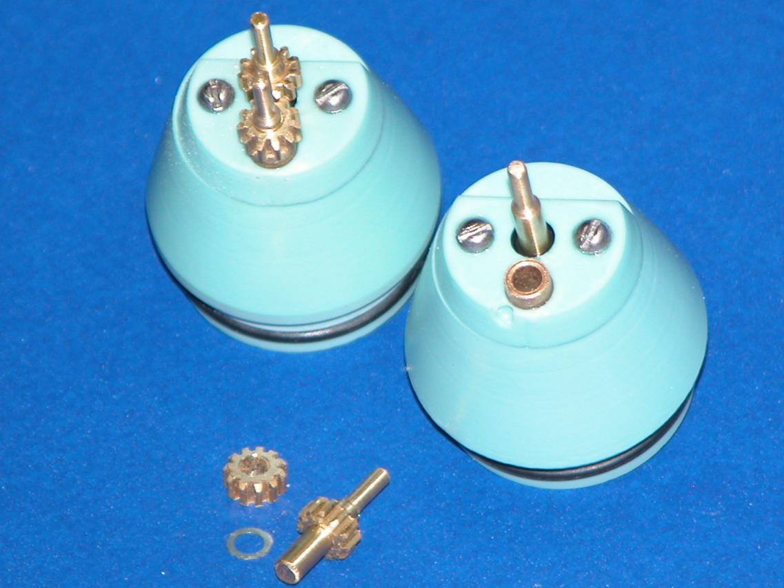

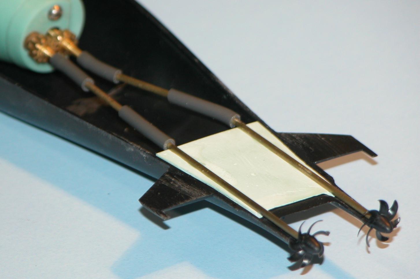

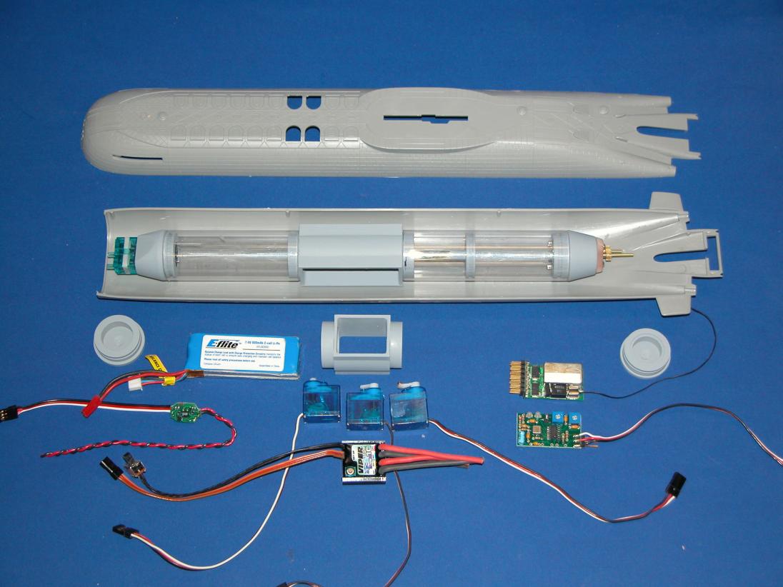

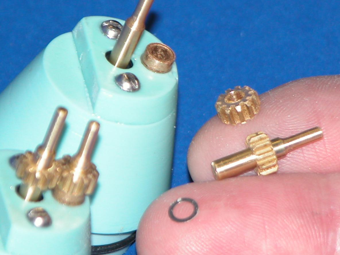

                Just get the 1.25" SD. Since the SD has a single motor and Type XXI has 2 propellers located on the stern planes , you can either make then operable ( more complicated) by using gears to counter-rotate them or just simply do what this guy did with a Trumpeter 1/144 scale Romeo class submarine...
                  • 13951
                  As you can see, I've designed the basic single-shaft 1.25 SD so that with the simple addition of an idler gear equipped with a shaft, I can produce two counter-rotating shafts from the basic 1.25 SD motor bulkhead.
                  Powering a two-screwed submarine? ... No sweat! Been there, done that, got the T-Shirt!
                  So, so many little plastic submarine kits out there to convert to r/c ... so, so little time!
                    Any more secrets up your sleeve David :p? That is absolutely amazing!
                    I see that it now has a snort system up front. My dream of seeing a static diving Revell U99 someday isn't too far off.
