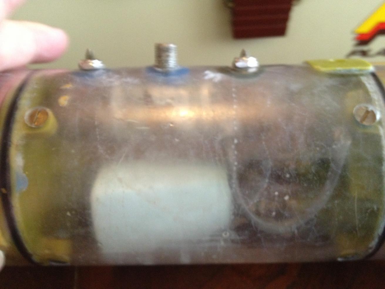

                        The hose is my first suspect since my hose already has a small balloon aneurism in it close to where it fits on the servo valve. Can that hose be replaced without taking the ballast tank area apart? I might need some long very thin needle nose pliers or those surgical scissor like clips. I can really see the blow valve seal so I can't tell if its dried out and leaking.
                          • 14010
                          It's the hose. Send me your address and I'll send you some along with some other goodies you might need to make that lump of Lexan work.

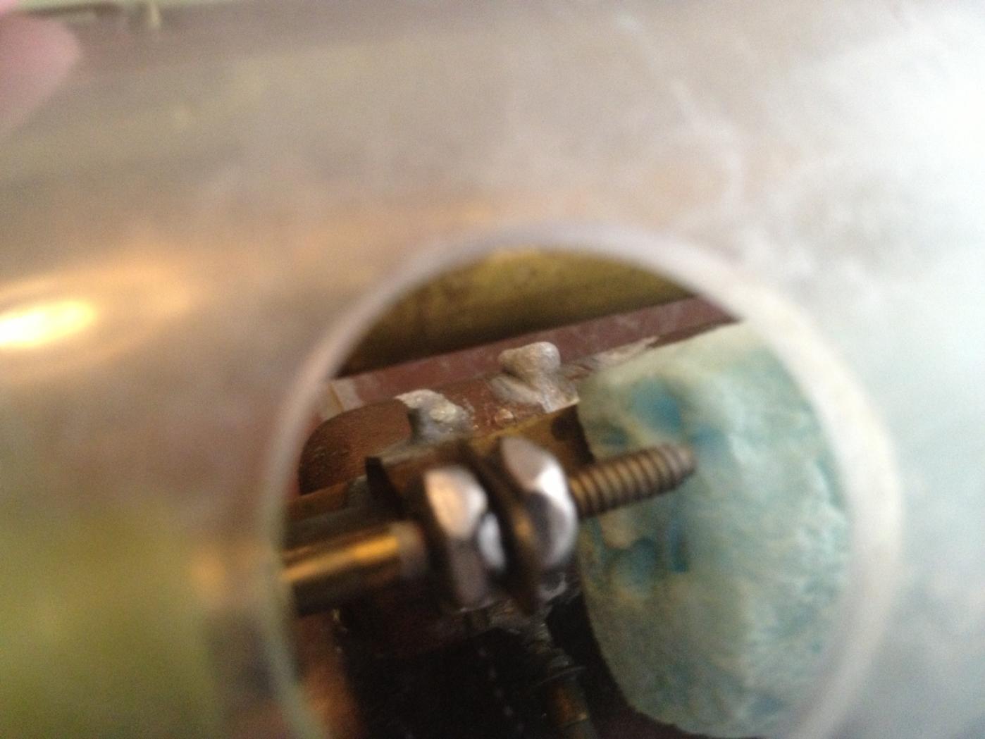

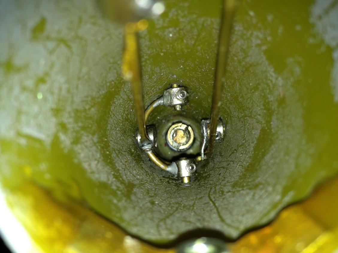

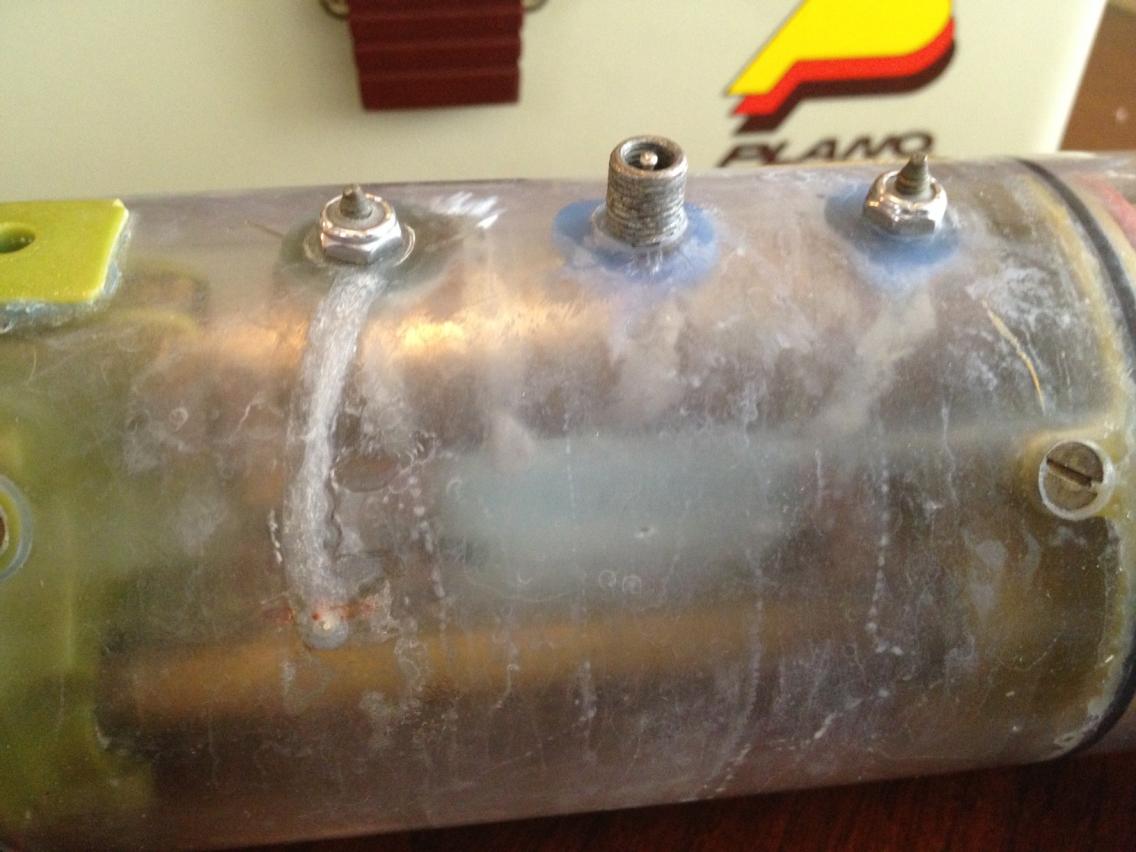

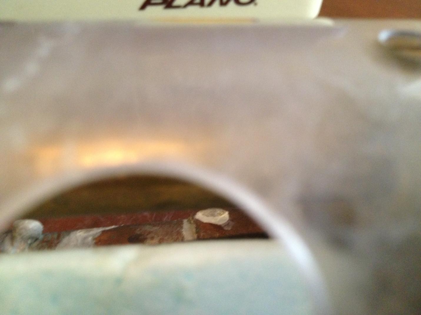

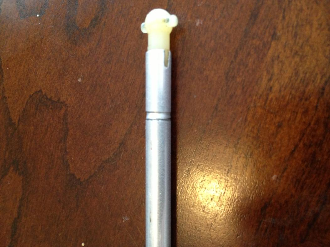

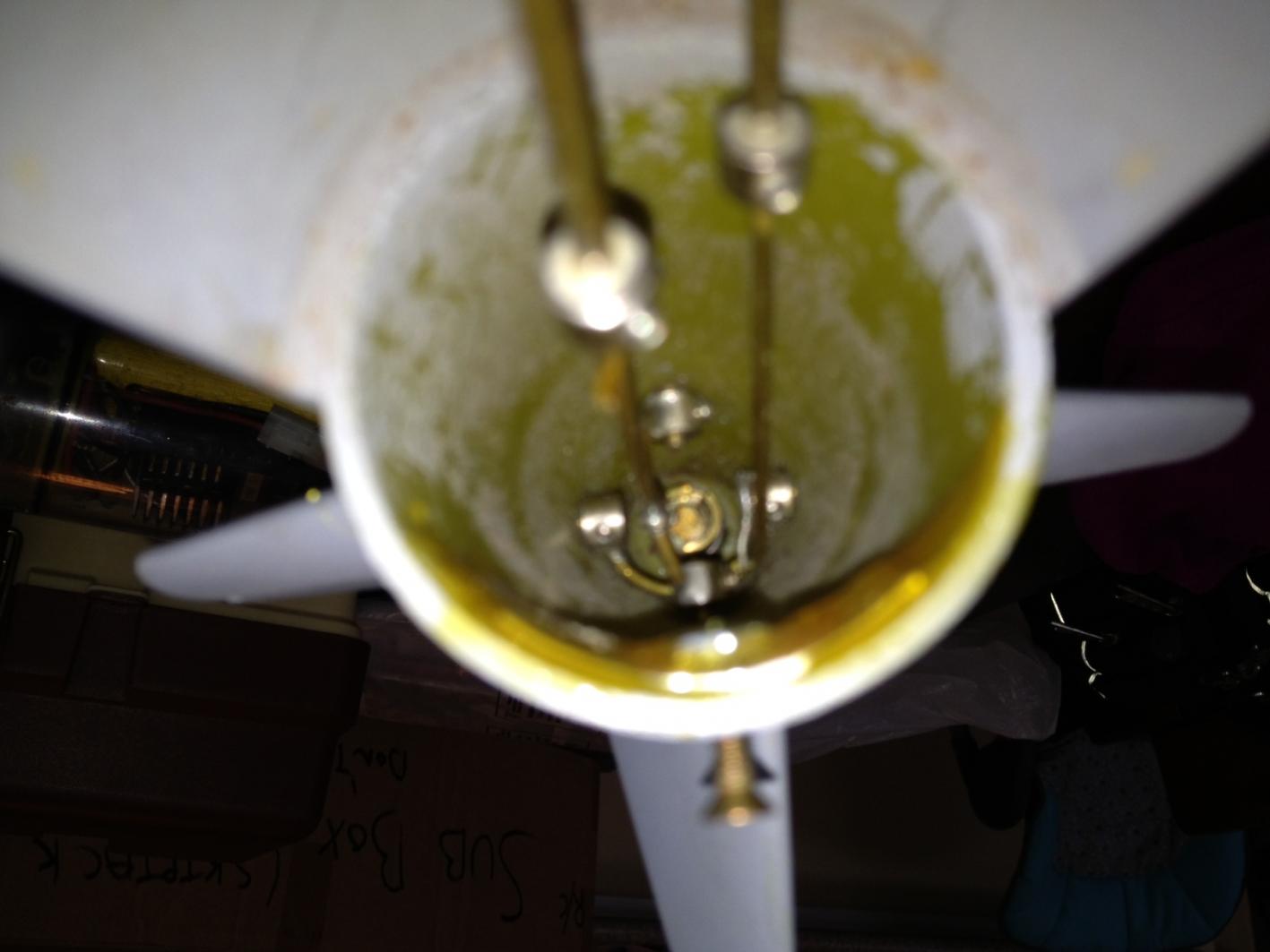

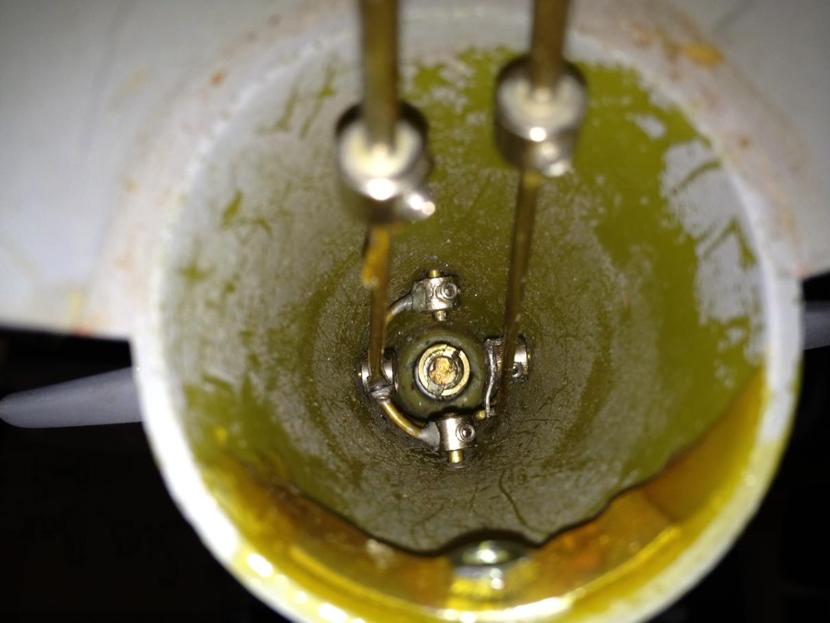

                            Hemostat, right! I was having a senior moment there. Anyway here are some pics of my WTC ballast tank area. There are some weird gray growths on the solder areas of the pressure tank. you can also see the ballooned area of the hose. The plastic tank itself has some whitish deposits on the inside and I can see some minor crazing/cracking. Here is a pic of my prop shaft. it appears to be a 3/8th" aluminum tube that has some wear rings at each end where it must have been rubbing on the rear plane linkages. Not sure if its a rudder or a dive plane interference. I will have to check that out.
                            • llangston1
                              • Sep 2013
                              • 84

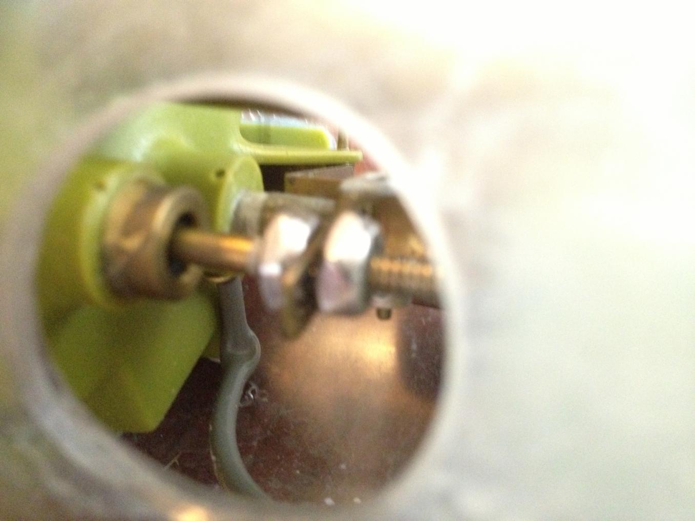

                              Here are some pics of the rear compartment with the prop shaft and rear plane linkages. the prop shaft interference has to be from the rudder linkage since that is the only one that comes near the shaft as it travels. I'll have to readjust that linkage. I might also have to resolder the linkages since they look cracked but that might just be cosmetic or poor picture lighting. The pictures are actually upside down. The rudder linkage show on the left is really on the right side of the boat when looking aft.
