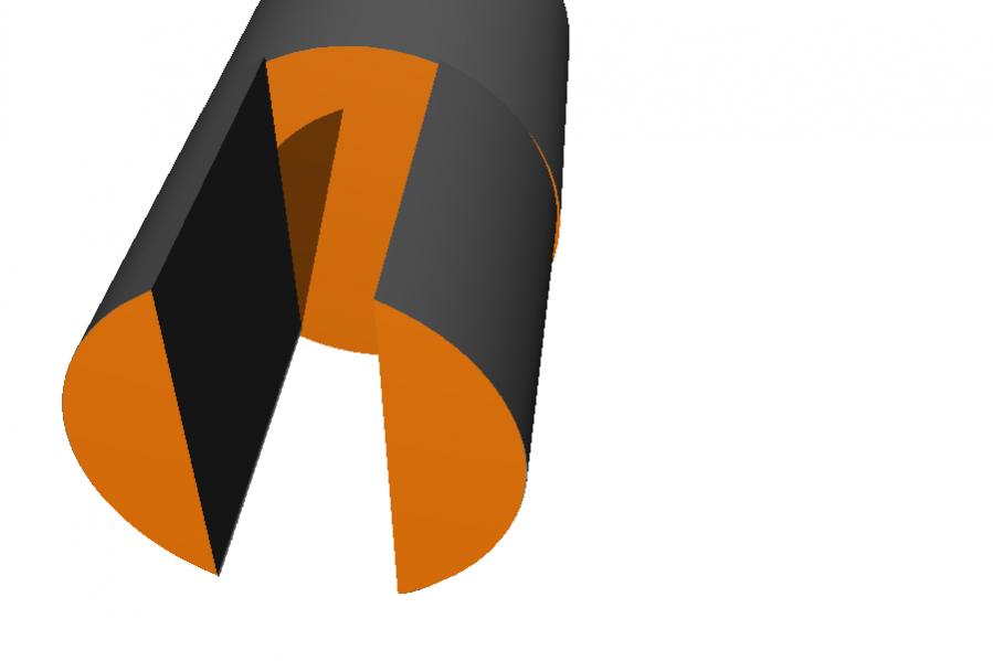

                      a regular Schrader valve can have the center piece removed. There are tools you can buy for that

                      or take a brass rod and cut out a channel. Like this:

                      Now, if you do not see any leaking from it, leave it alone. If David says do not touch it then I would not.
