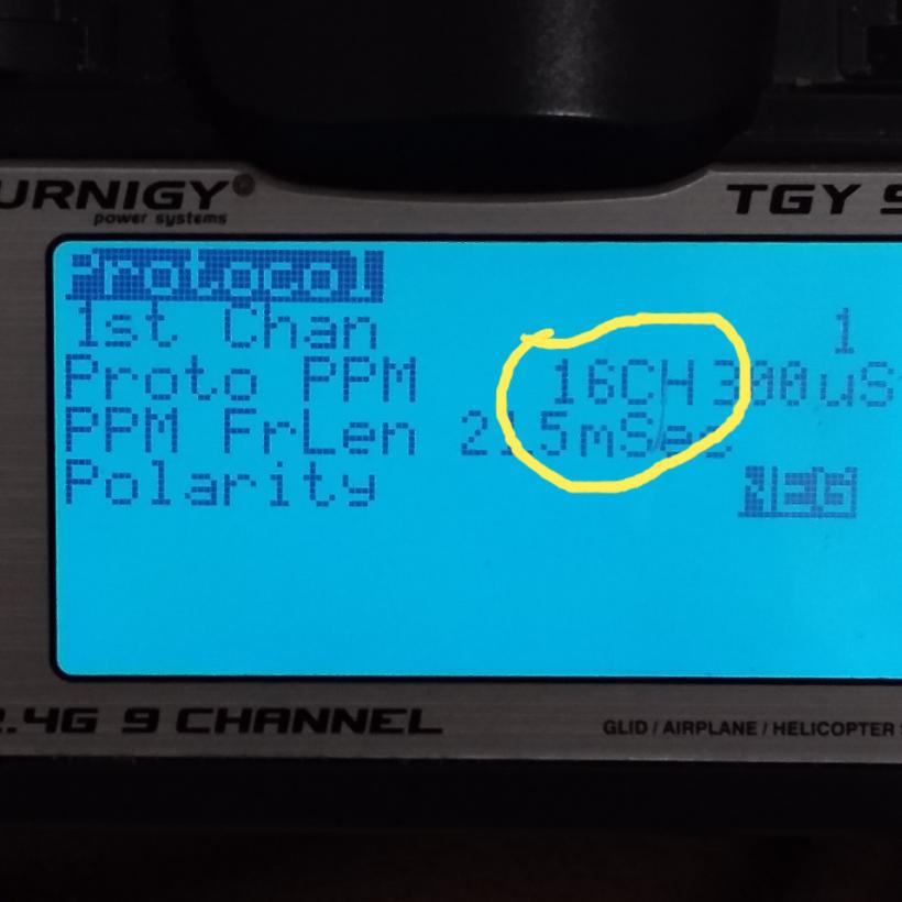

                That's going to be hard to unload my junk.
                16 channel any one.
