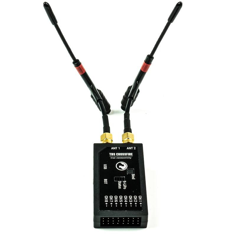

          Please note, not all 900mhz radios have pumping power and signal sensitivity good for subs. So far the best I seen for both is the TBS crossfire 915mhz. Some expressLRS 915mhz are good too. The main problem for is these system were designed for long range drone flying and you need to solder a PWM Converter daughter board to a drone receiver to get 6 or 8 channels for servo use. There are some 10 channel board to. However TBS crossfire system has a prebuilt 8 channel 915 mhz receiver with 2 antennas.

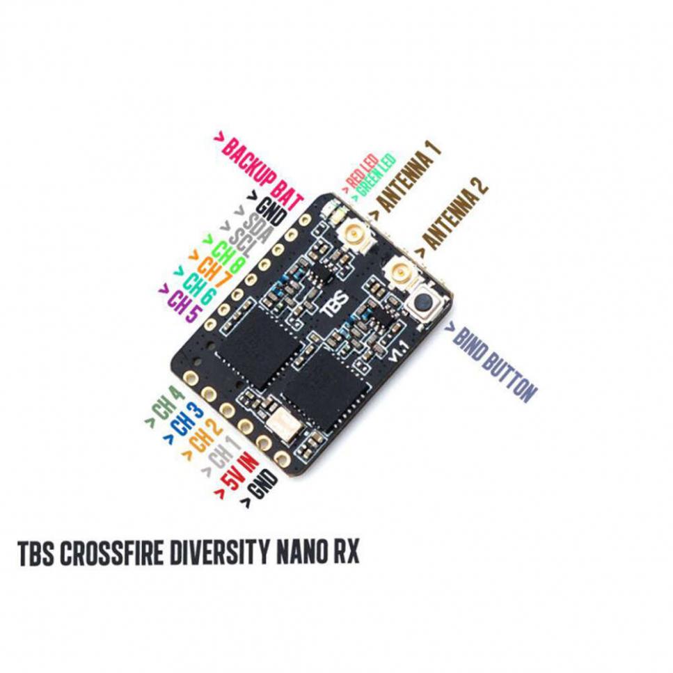

              They also sell a 8 channel that you solder together. The receiver goes on top of the daughter board and is solder on very easy as it fits like a glove. i both receivers you can add stabilizer or anything you want. I have both receivers for testing in subs. Also the antenna are smaller in this version. So far both receivers have passed the tests, just have a few more tests then I will make a video. The reason I like the prebuilt one is, there alot of older guys who run RC subs and soldering tiny things is a bit harder for them.
              Click image for larger version  Name:	DSC01529-ga.jpg Views:	0 Size:	59.5 KB ID:	168608
              Click image for larger version  Name:	A7300300.jpg Views:	0 Size:	85.5 KB ID:	168607
