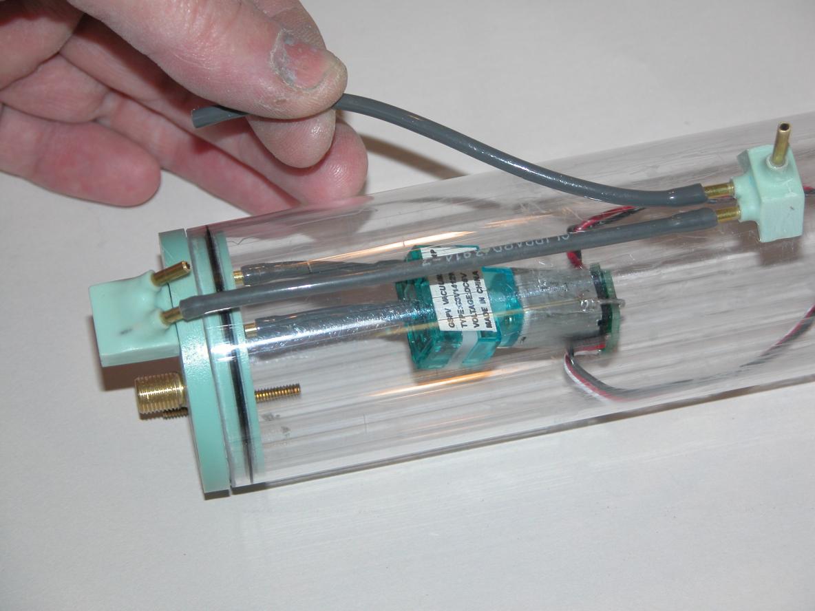

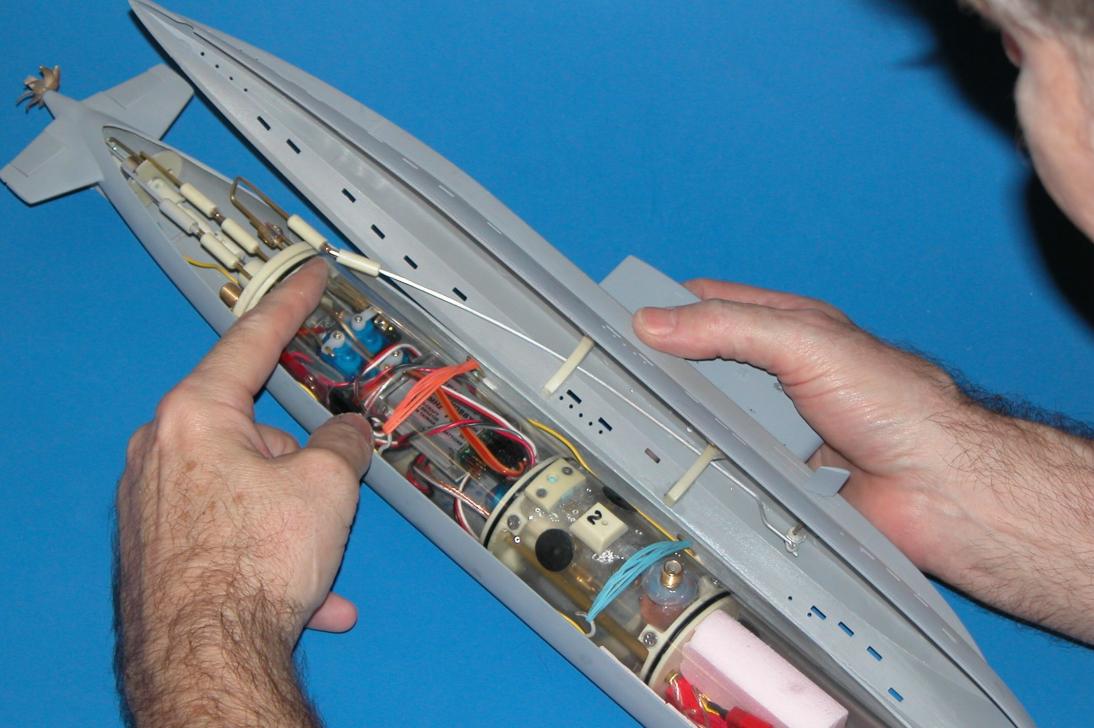

      Yes, the KILO SD has space and fittings for the LPB. I have five complete RTR KILO's here and each one is equipped with the LPB and the mini-switch Kevin McLeod developed for us.

        My subdriver looks like the one in your fourth photo (cream colored resin caps) and doesn't have the fiitings that appear in the first two photos. I'd be glad to buy the pump, but I think it wouldn't do me much good without the cast in plumbing.
        I see from the Caswell site that all new Kilo subdrivers are snort ready--that's a great running change to an already excellent product.

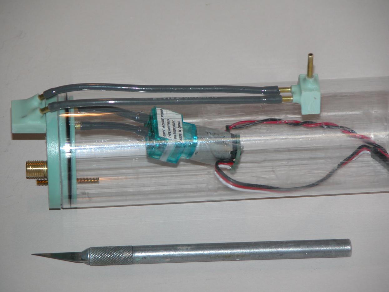

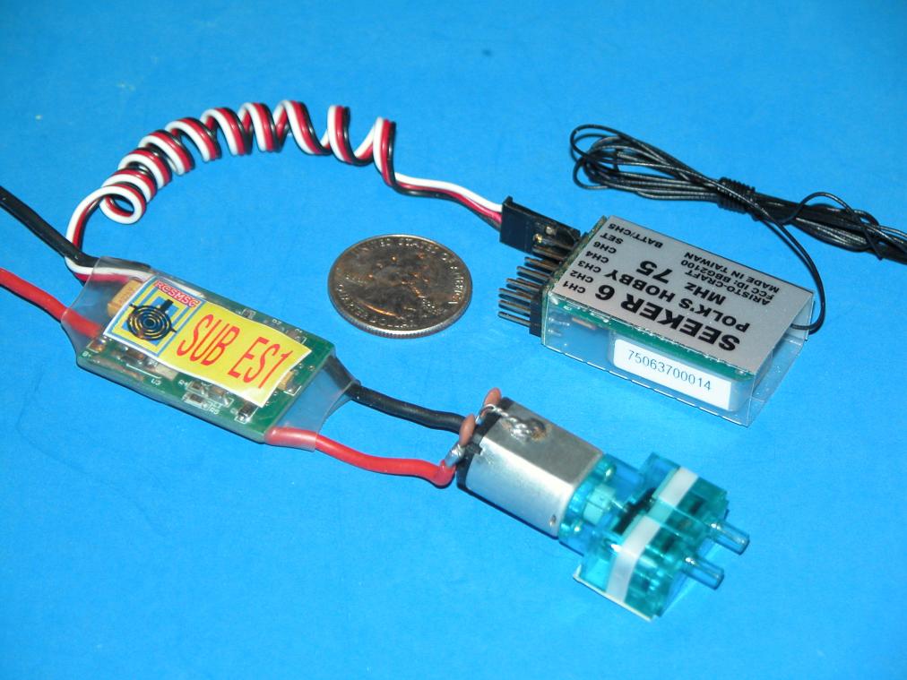

          Notice the snort pump in the 3rd picture is hooked up to a BH model's ES-1 switch. How does it compare with Kevin's MPC?
            • 14012
            Actually, using the BH, ES-1 switch is a miss-use of that product -- but was the only recourse till Kevin's much more practical and job-suited electronic switch came around. The ES-1 is much more suited to high-current, on-off jobs than to drive the little LPB motor pictured.
            Kevin's switch has a much, much smaller foot-print and is dirt simple to install and set-up.

              I too have the Kilo kit and Subdriver. My SD has the cream colored resin end caps and no fittings for a snort sysyetm.
              So let me pose a few questions:
              *Would it be best to put in a Snort in my Kilo for better/easier prefromance?
              *If so, would I have to buy the Snort fittings kit and drill 2 holes in the aft end of the SD to install the Snort?

                  Dave,
                  I am looking the aft end of my Kilo SD, and there seems no room for the 3/32" brass tubing to fit for the snort. And if there was, I don't see how a snort cast resin would fit there.
                  My three push rods are all the way at the top of the cast aft cap, then there is the motor shaft. Which leaves no room for a cast part. So I don't see how a fitting could go there. Maybe the brass tubing can go between the push rods? Then have the gray pipeing come out and bend up and on top of the SD?
                  Please help me understand how the snort system/casting will go.

                    Current models of the motor bulkhead are cast with holes (you guessed right --
                    between the middle pushrod seal) for the LPB nipples. You'll have to drill your own as yours is an early model of the KILO SubDriver.

                      Thank you Dave, that's what I thought. I'll drill two 3/32" holes between the push rods.
                      Then is there a fitting that goes on this end or do I just bend the gray piping over and put a hole into the SD in the gas chamaber?
                      And is there a cast part that I can get that will be glued onto the top of the SD?

                        David posted this photo that shows two exterior fittings for a LPB (or snort) system. I think they're for a Type VII, but seem suited to other uses. David and Mike can comment on availability and pricing.

                          Here you go plastic66. Hope this helps
