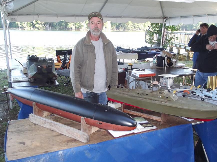

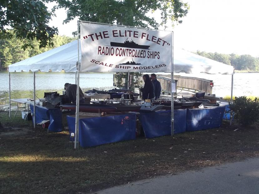

              The 1/96 SKIPJACK, the one featured in that youtube post, will go twice as fast as I showed -- though it torque rolls to the point of being uncontrollable. And I've broached out of the water with it, but usually that pops the linkages free of the SD, so I try to avoid that nonsense.
ID:	92219 Click image for larger version
ID:	92220 Yeah, it was a bit chilly. October in Virginia. But, otherwise, we had great weather for the event.
              No, no mixed-gas for me, I remained a second-class Diver -- air only, qualified to two-hundred feet. Only Helium I took was for fun at the MK-16 work-station at the Fort Story EOD Det. where I worked a few years as a support diver. This voice is original factory equipment.
              Yeah, those Projects guys (saturation Divers) burned out quick -- tough gig.

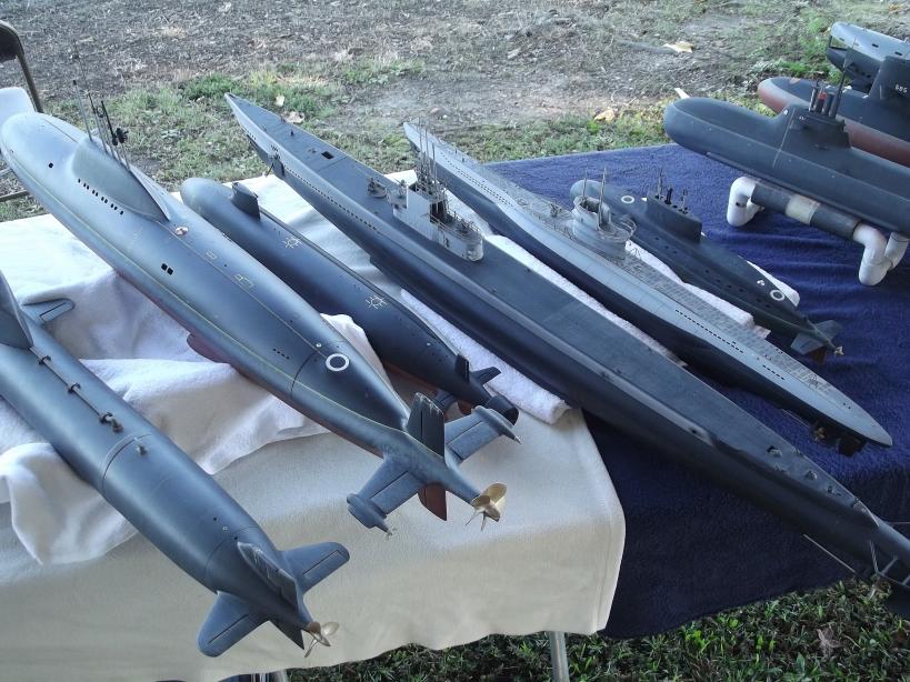

ID:	92218 Just some of the boats I have. Half of the fleet had to stay at home as I have only so much room in the van. All ran well and wowed the crowd. America, Russia, Japan, and Germany represented here.

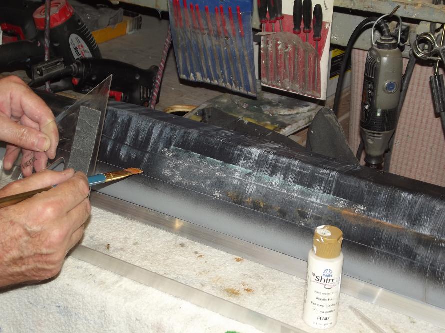

                        Here's some shots of the weathering process as applied to another 1/60 ALBACORE (this should make John nuts!).
ID:	92222Click image for larger version
ID:	92223 It's a good practice to practice on an unused hull first.
ID:	92224Click image for larger version

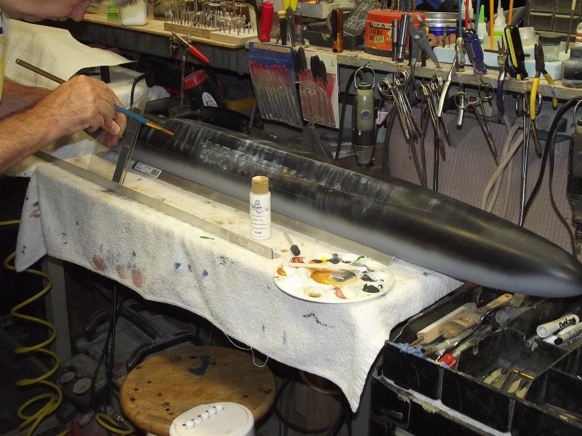

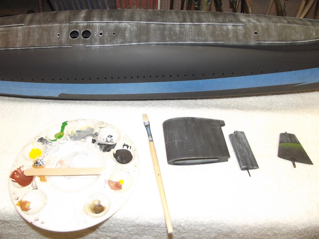

ID:	92225 The initial weathering step is to produce 'streaking' -- which way will running water track as it fall down from the upper rudder, sail, and hull? The answer dictates how you streak these three structures that spend most of their time in the air. I've provided a high and low exposure shot to illustrate the nasty looking streaking. Tomorrow I'll tone down the streaking with a misting of a very dark gray.
                        I cut my teeth in weathering effects dirtying down TV and motion picture miniatures -- where you had to overstate things so they would be captured by the electronic eye or chemistry clinging to film. Took me years to achieve a more subtle; more pleasing the eye version of the technique.

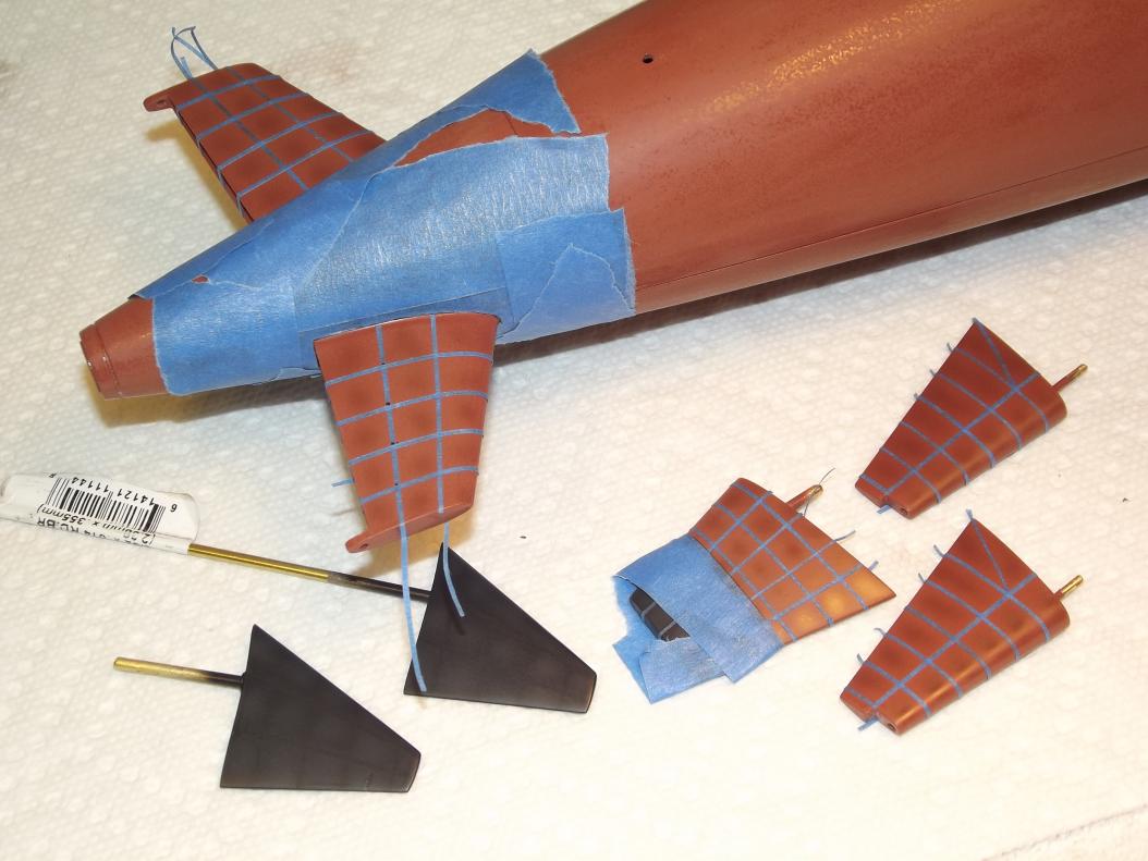

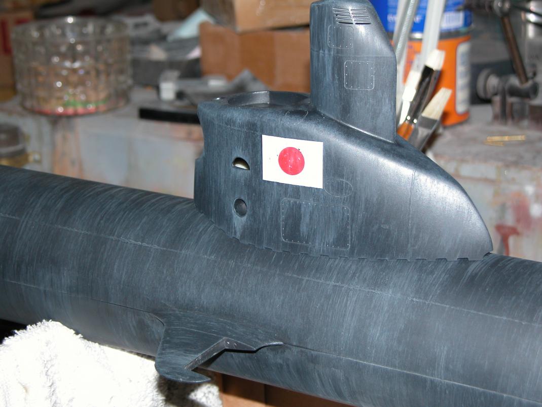

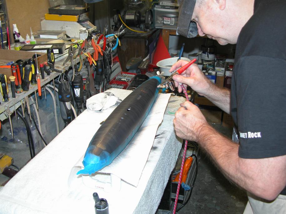

                              The trick is to lay down a clear coat between the layers that comprise the weathering job -- that way you can scrub off the current work should it not please you.
