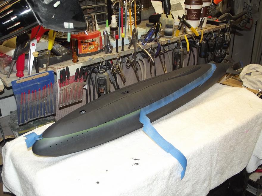

ID:	92232 The harsh white streaking before and after laying down a well thinned base very dark-gray 'color' to tone things down. Once this dries (which happens very quickly as I have switched to water soluble acrylics at this point), I lay down a protective clear coat (back to the two-part ChromaClear automotive grade product) to protect the work.
    There is total compatibility between the water soluble acrylics and Dow Corning ChromaColor and ChromaClear paint systems. This is not a happy accident -- it's the result of experiment and specification sheet reading!
    Not all paint systems got along with each other!

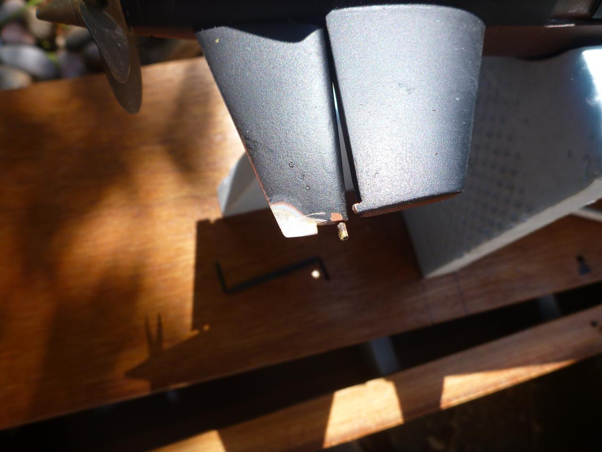

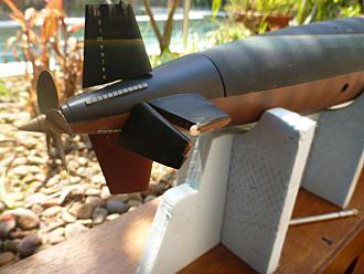

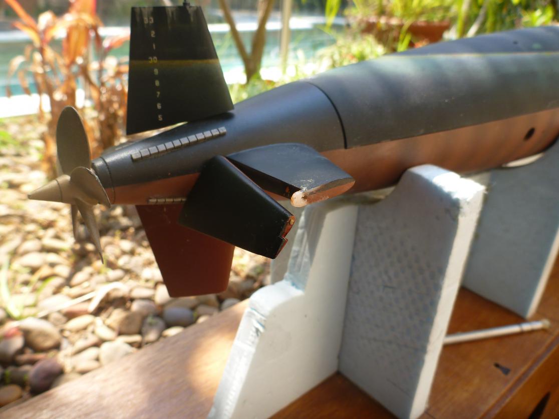

                  Little repairs on the 1/96 Skipjack. She sustained some slight damage on the trip south.Click image for larger version
