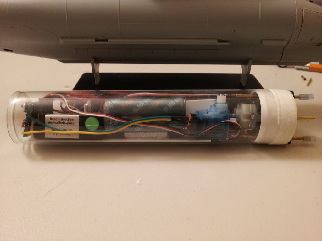

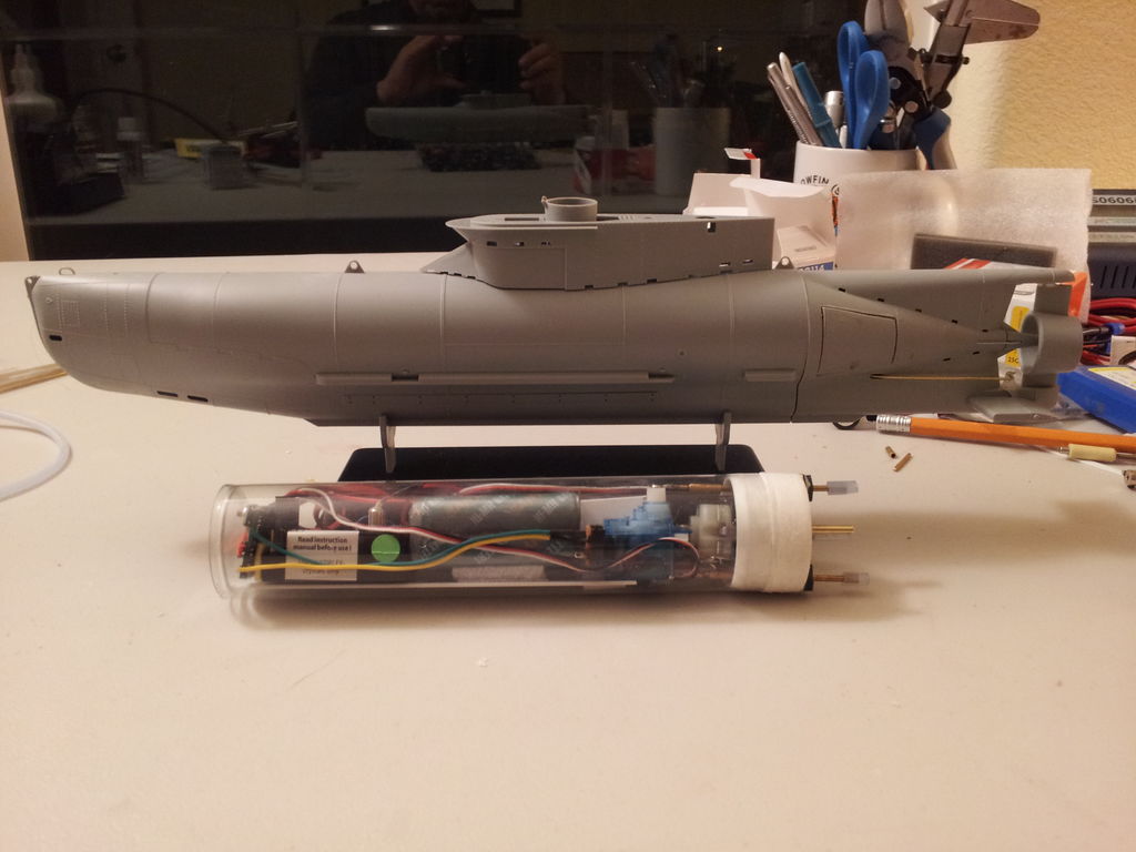

      Like this?
ID:	91741Click image for larger version
      This was made by Mr. Mark Jones. He's known as Small sub guy here, try getting in touch with him. http://forum.sub-driver.com/member.p...-small-sub-guy
