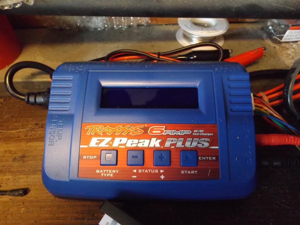

    Here is the Traxxas charger that I just got. It has the discharge feature.........which is good but it wont discharge to the recommended storage voltage but to 3.0 volts per cell. Too low. So you have to monitor it to get to where you want it. This charger(with the proper accessory) will charge two battery's at once the same as the ONYX. This one, however will charge up to 6 amps instead of 5 amps. A time saver. They recommend that when selecting a charge rate(usually 1c) that you take the Mah rating of the battery and divide it by 1000. So for my 6400Mah 3s batterys the charge rate would be 6.4 amps. Thats a GENERAL rule of thumb. Consult your battery label. Not bad for $89Click image for larger version
