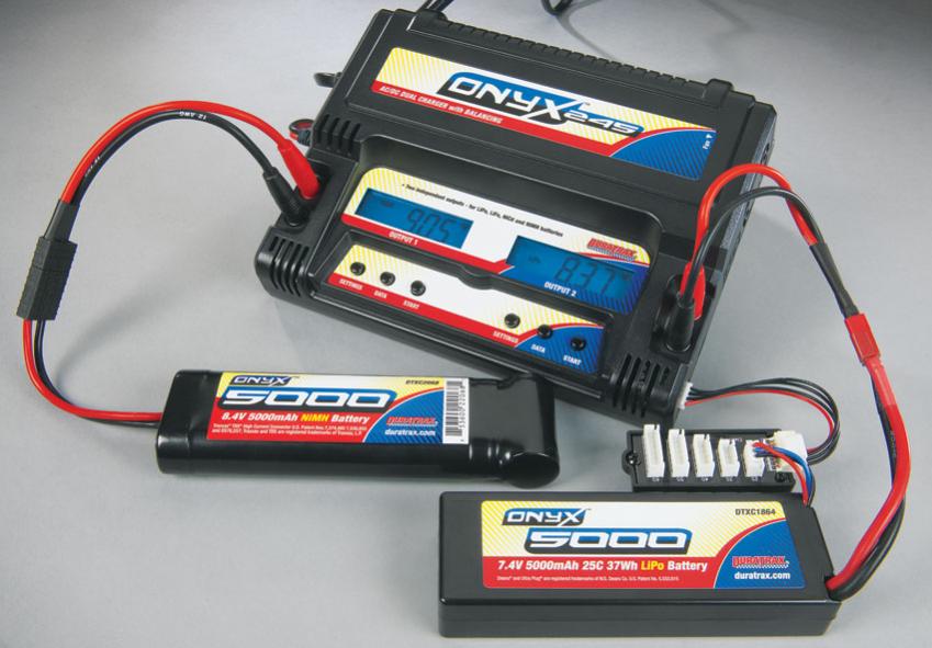

              Heres the charger I picked up about a year ago. Economical and works real well. A couple of features that I would have liked to see is discharge and storage charge settings.Click image for larger version

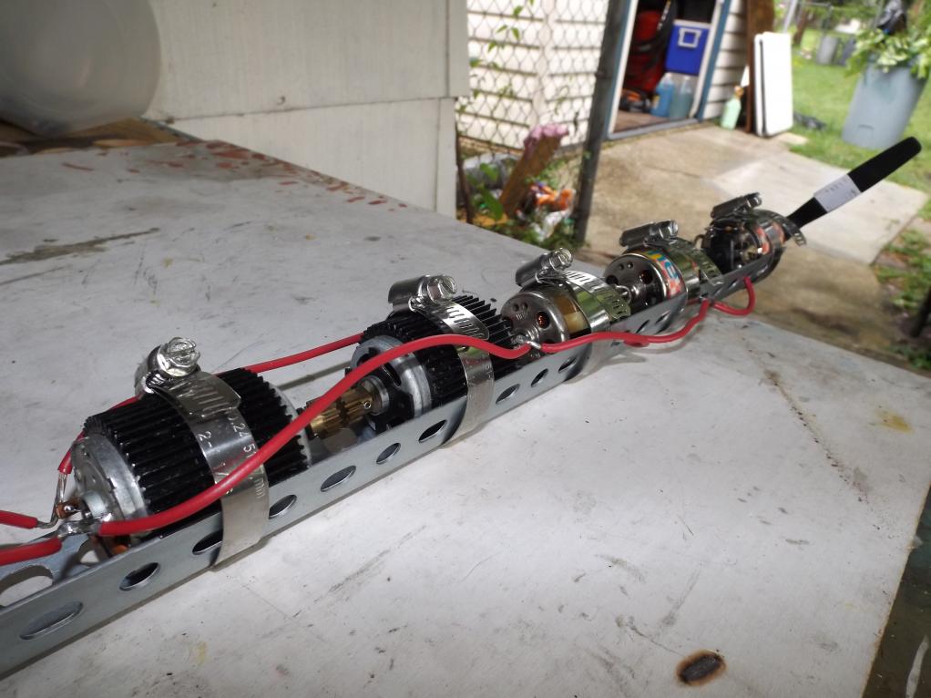

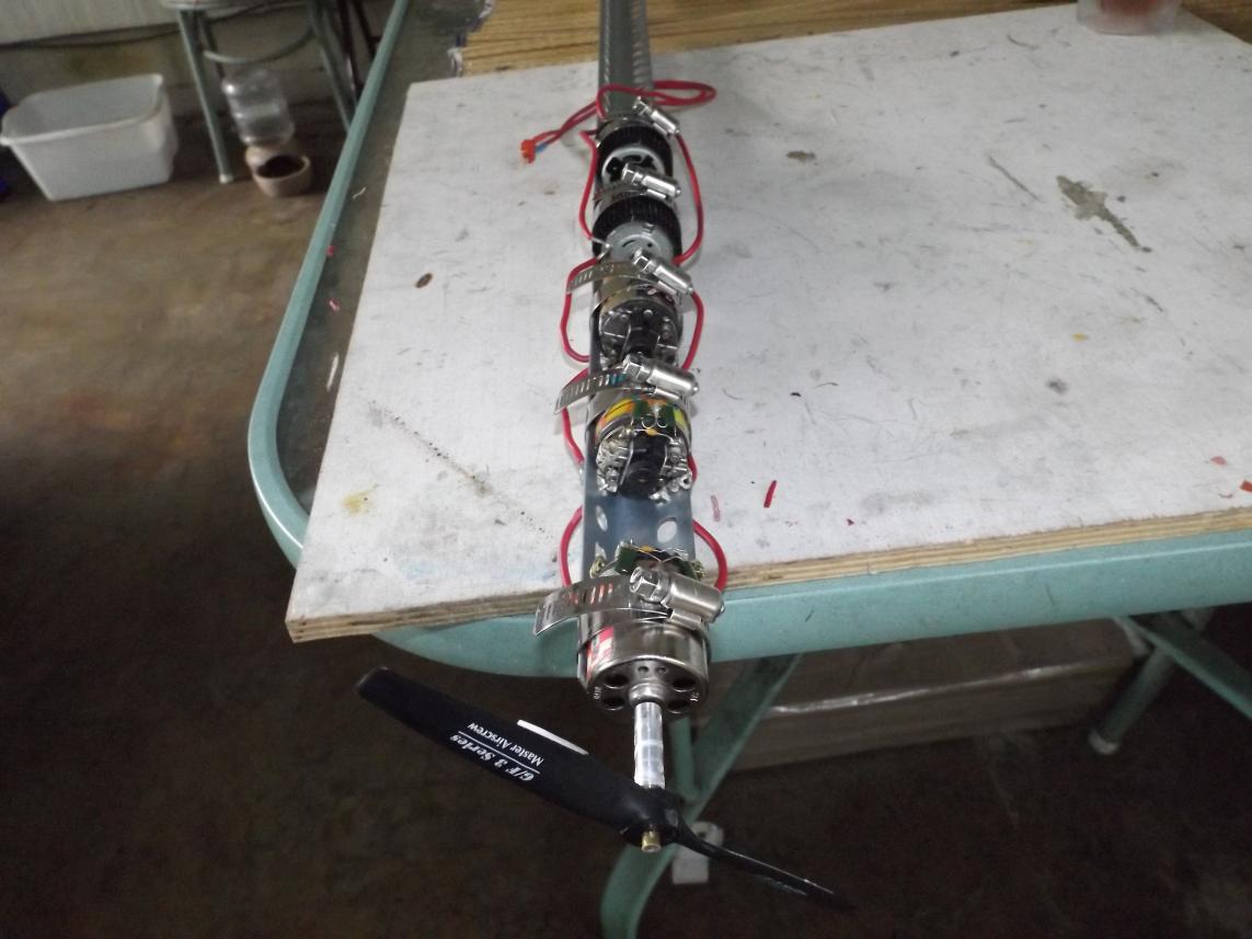

                I am making my own Lipo dis-charger. I bought a piece of angle from Lowes and attached five(5) 540 electric motors to it and wired it up to plug into a battery. On the one on the end I attached a small 7" airplane propeller to put some load on things and drain more quickly and provide some cooling. While the battery is discharging I monitor the battery using a Lipo volt meter plugged into the Balancing plug.
                I also ordered another charger that has a discharge feature to it. Pictures soon.

                      So, here it is. Unconventional.........abomination.......hodgepodg e.......can you think of anymore tags? Anyway, it works. And its aircooled to boot. Puts off quite a blast, especially on 11.1 volts 3s.Click image for larger version
