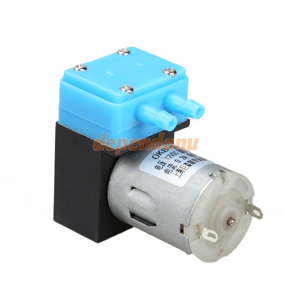

                Micro drain 12v pump for air or liquid, including fuel. In and out put. Most likely needs a capacitor, and a reverse polarity connection for R/C use and dual purpose suck and blow +<-----> -Click image for larger version
Name:	Micro-Drain-Aquarium-air or liquid-DC12V-200ml-per.jpg
