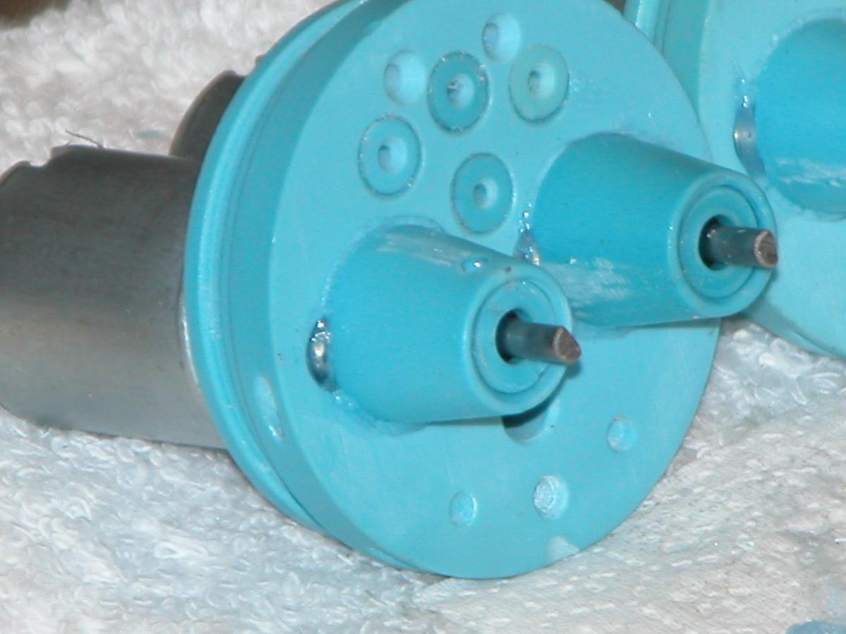

    I recieved the 1/16" rod seals. Thanks,
    I assume they have one-way V-cup type seals, correct?
    If so, is there a way to determine the proper direction of installation, or do I need to do some kind of test to determine which way they are facing? I didn't see a direction marked on them?
    Rick L.

    Nope. An encapsulated dumb old O-ring or quad-seal ... depending what I have in the bin at the time of manufacture. Point it either way you wish (two choices, unless you totally screw up the installation).

      Okay, Great!
      I can't think of a 3rd option, so this should be easy. :D

        No problems! :)
        I used a little RTV to seal them in the holes I drilled in end cap of bow WTC.
        I figured that would be easier to press out, if I ever needed to replace any.

          That's how I do it.

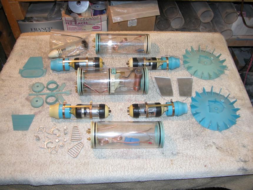

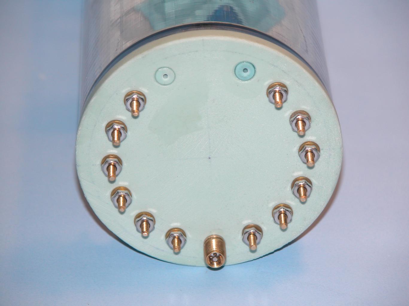

            what are all those nuts and screws on the endcap for:confused:
              • 13982
              Electrical contact lugs for the FS-1 propulsion/control system.

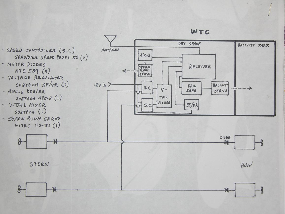

                Wow, I didn't realize it had 4 motors. :eek: (Somehow I got the idea there were 2)
                Very interesting system. I'll drink to THAT!
                I bet it takes a little practice to learn to control it accurately?
                That system needs Fly-by-Wire Computer control! :D LOL :D

                  Nope, easy as pie; I configured it to drive like a tracked vehicle (tank). Very stable, easy to turn on a dime at a stand-still, but takes forever to turn once some way is on. I'm re-configuring it for banking/coordinated turns.

                    I really like the use of the Mixer circuit to control 2 ESCs and 4 motors, and a separate WTC for each motor makes the system much more versital, allowing it to be put in other hull shapes if wanted. :)
                    Are you adding more control surfaces, like alirons, on a servo, to get the roll-control?
