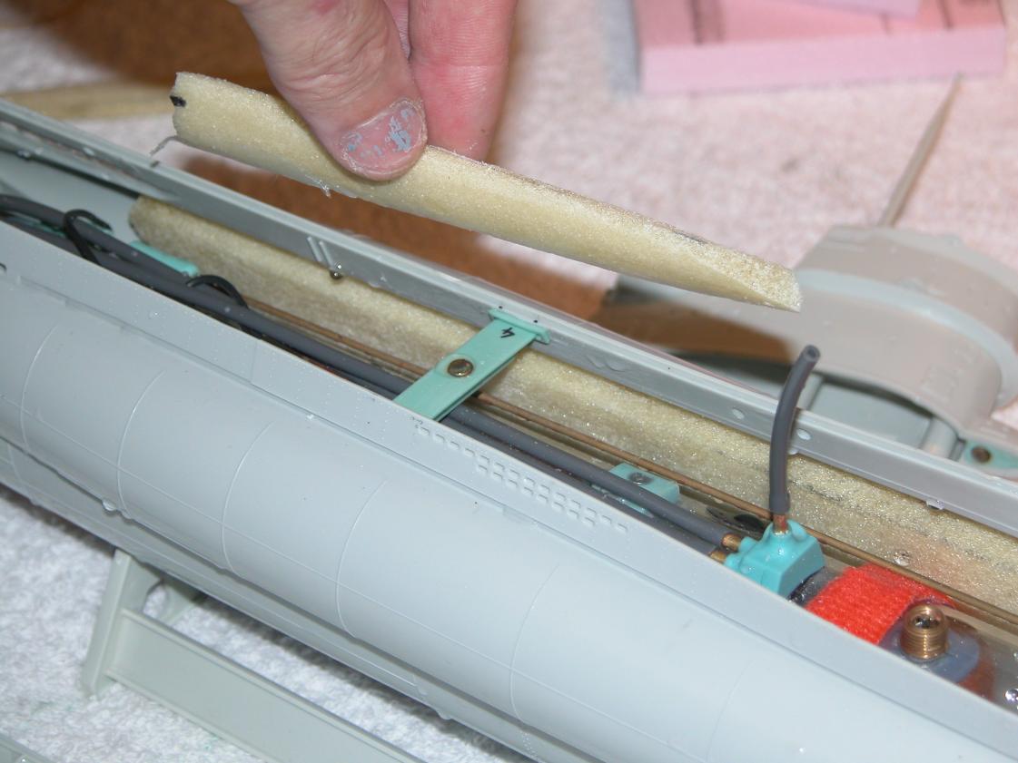

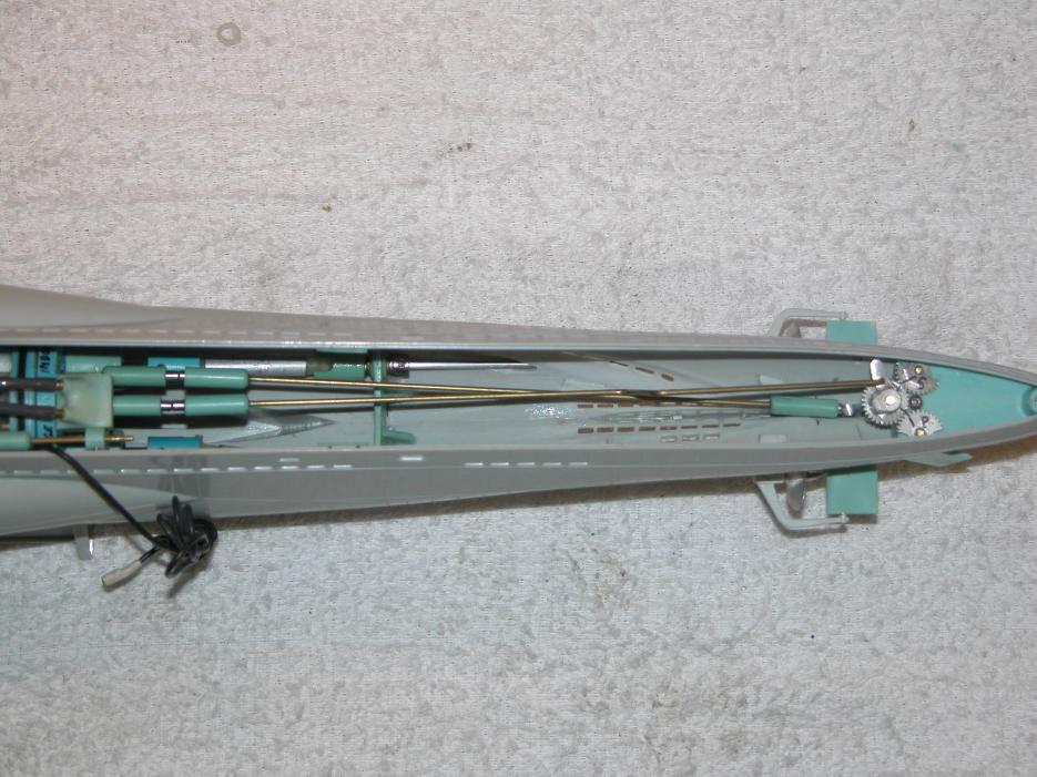

      OK, here we are, fresh from the Cave ...
      1. about ten ounces total
      2. CA, as the guys recommend -- you can break the bond with a twist, scrape off the CA residue so you can slide the pushrod through the bad seal
      3. Don't like the one I got so won't recommend it. Let's look .... this one looks promising, http://www.horizonhobby.com/products...er-THP610CACDC

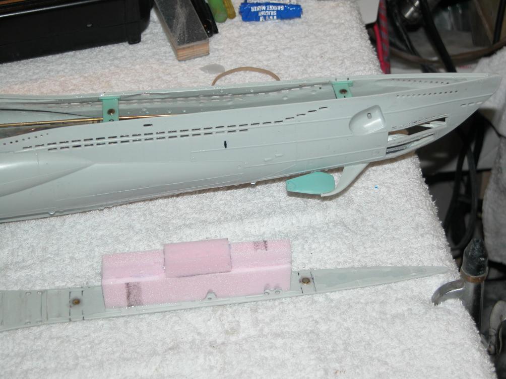

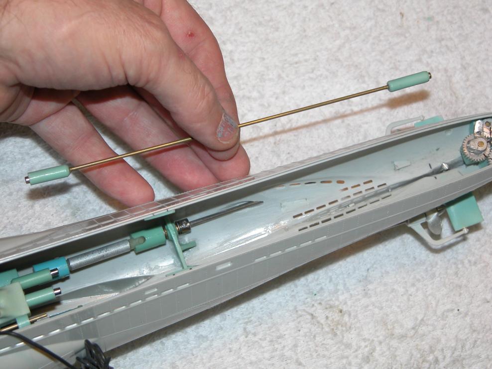

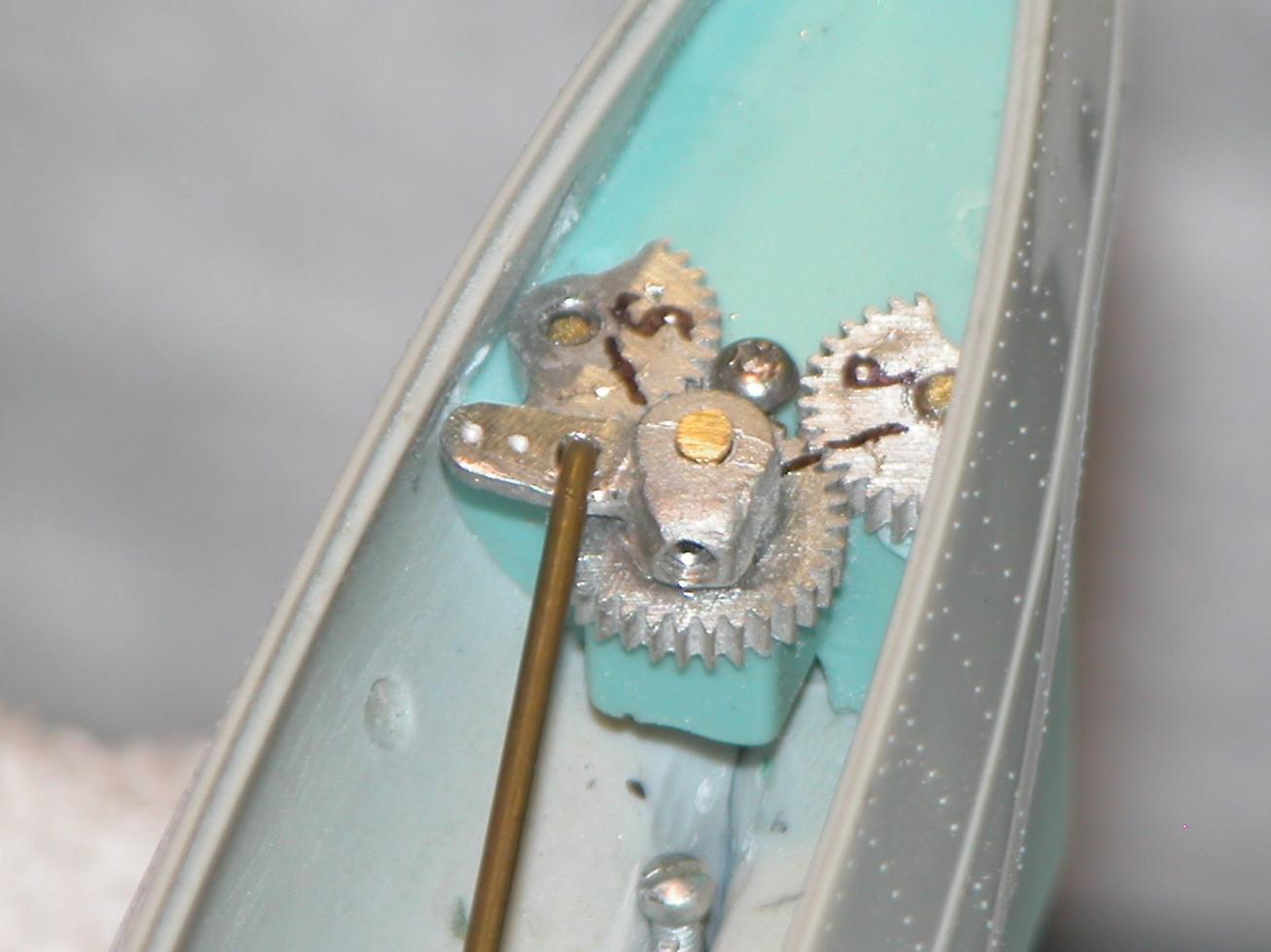

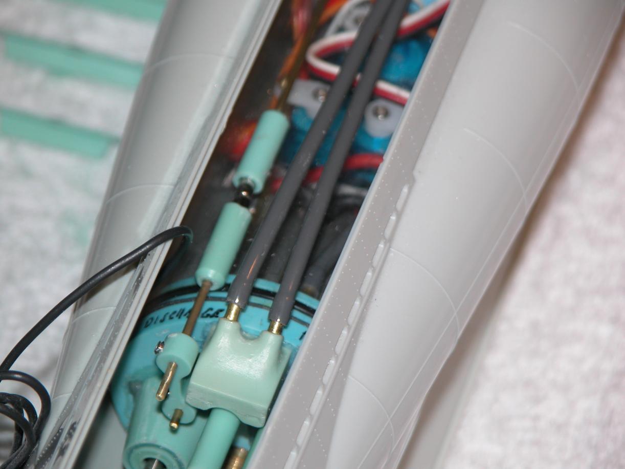

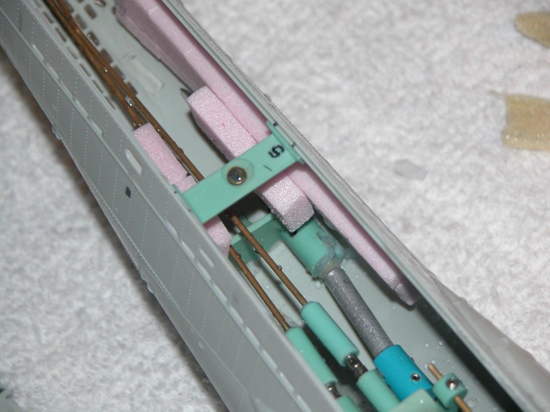

      4. Click image for larger version
ID:	81250Click image for larger version
ID:	81251Click image for larger version
ID:	81252Click image for larger version
ID:	81253Click image for larger version
ID:	81254Click image for larger version
ID:	81255Click image for larger version
ID:	81256Click image for larger version
ID:	81257Click image for larger version
ID:	81258 Sorry, best shots I got.
