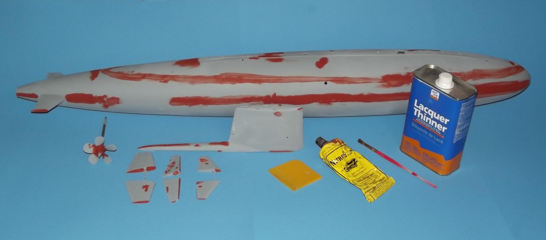

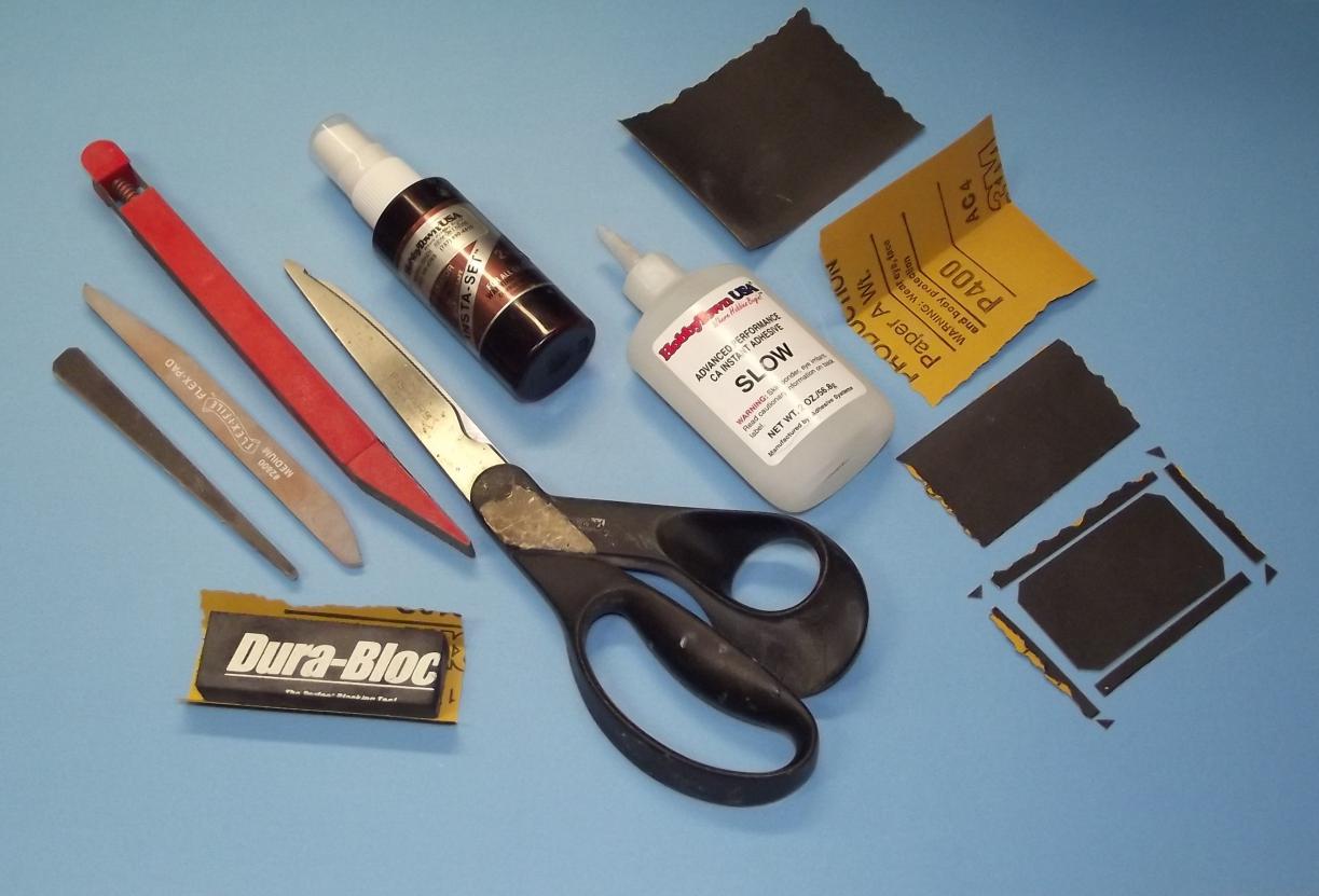

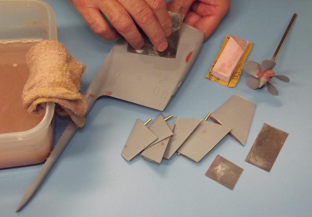

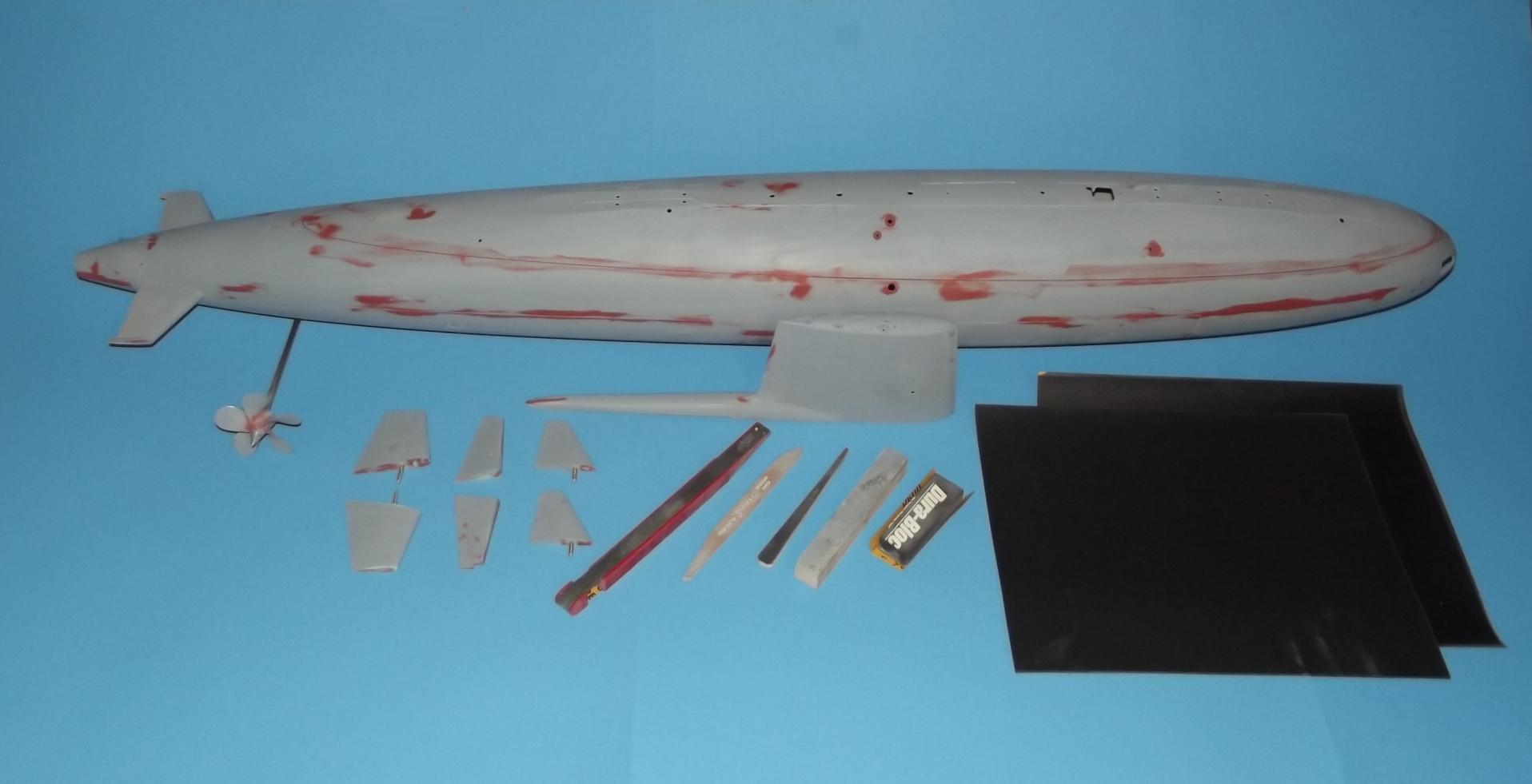

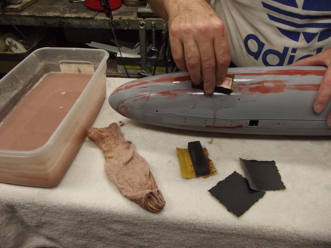

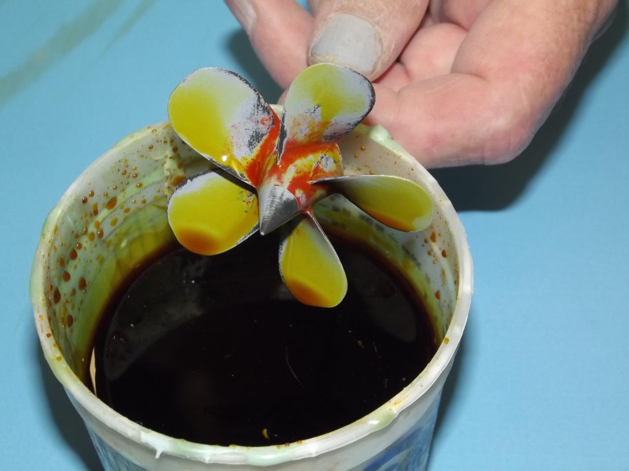

        Here's what I've been up to today:
          [ATTACH=CONFIG]16350[/ATTACH][ATTACH=CONFIG]16351[/ATTACH][ATTACH=CONFIG]16352[/ATTACH][ATTACH=CONFIG]16353[/ATTACH][ATTACH=CONFIG]16354[/ATTACH][ATTACH=CONFIG]16355[/ATTACH][ATTACH=CONFIG]16356[/ATTACH]
          Is that all??? Get back to work you bum Square hole - just because the boss has been on vacation doesn't mean you get a break. :wink: Now where is that new 3" SD - I want to be able to buy 2 of these pre Christmas.

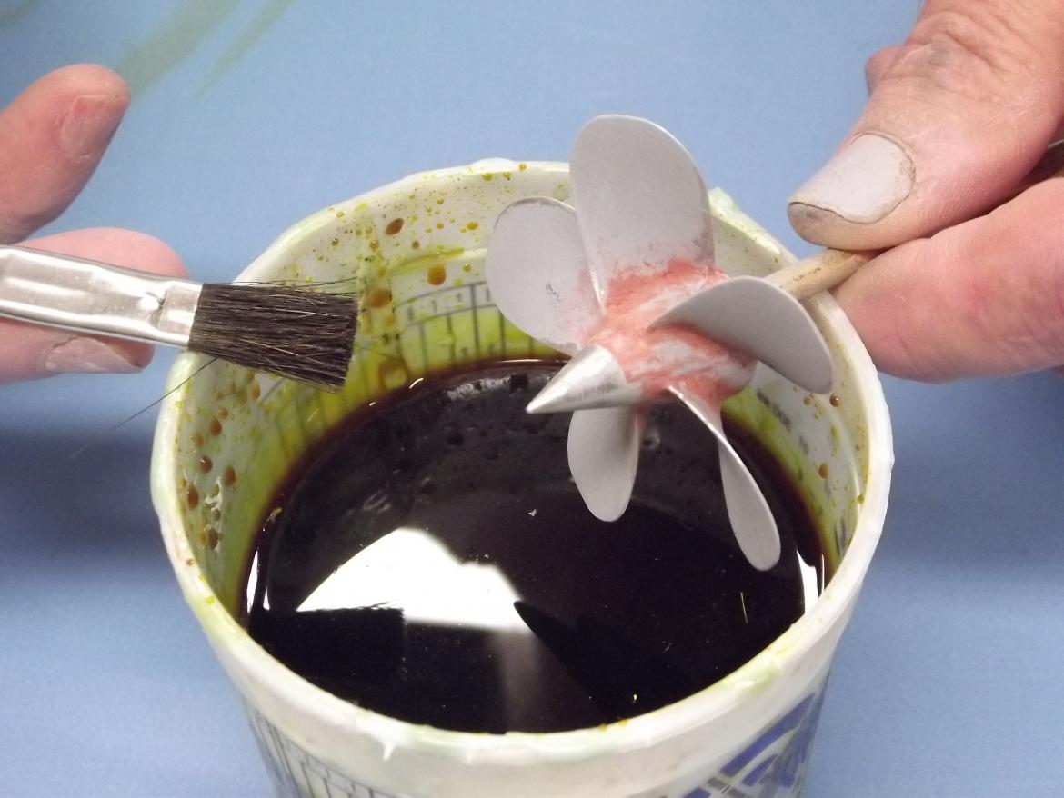

                  What are you dipping the prop into? Never saw that before.
                    • 2641
                    That's ferric Chloride- an acid used for etching pcb's etc. The acid puts millions of tiny hollows into the surface of the white metal, which turns it dark grey/black. This gives the paint something to latch onto. You can use this with any metal, the softer the metal, the more rapid the etching process, so white metal etches very quickly, so don't dip it in and leave it, else you might find you have no bits left when you return! Large metal surfaces are usually primed with an etching primer, which contains acid and etches itself into the surface.
                    You can get ferric chloride from electronics suppliers. We have Maplins in the UK, do they still have Radio Shack in the States? or Mike might carry it? Or try ebay for mail order supplies. It tends to come in pellet form, and you mix it up with some water, sometimes you can purchase it ready mixed. I store mine in a old plastic pop bottle, and decant it into an old plastic tray when using it.
                    Be warned it stains anything it hits, clothing, skin etc. Wear old clothes when using it and keep it well away from machine tools, as the fumes can be corrosive. An alternative etchant is sodium persulphate. Haven't used it myself, but it's clear, so you can see the etchant at work, plus it won't stain like ferric chloride.

                      The Radio Shack of today will probably not have it. It is a lot different than before. I went to Frys electronics. Here is a posting I did about etching white metal http://forum.sub-driver.com/showthre...-72-Gato/page3 about midway down the page.

                          Anyway ... if the guy can't find the acid (strong acid) he can dip the part in hot vinegar for a few minute (a lot of minutes) till it turns dark -- agitating the work with a brush while soaking to speed up the oxidation.
