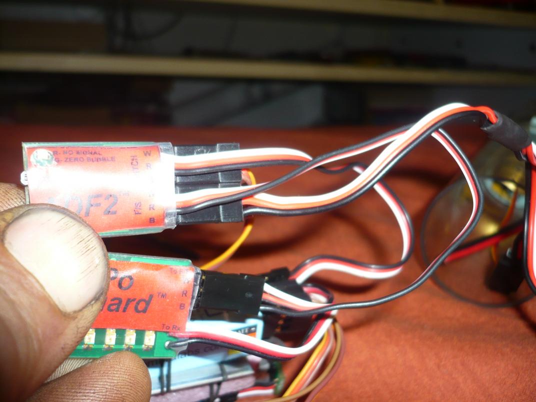

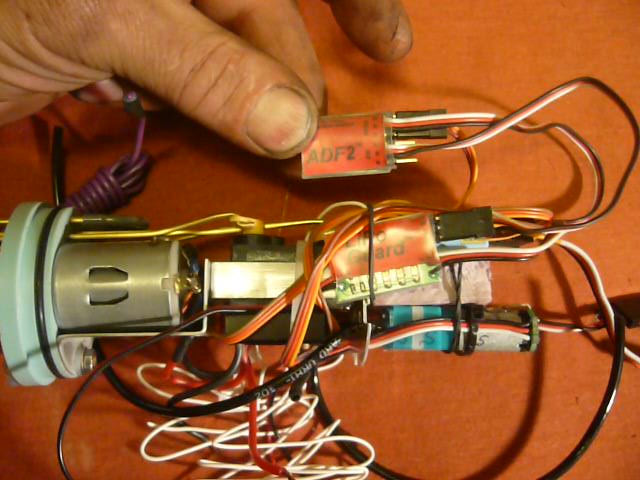

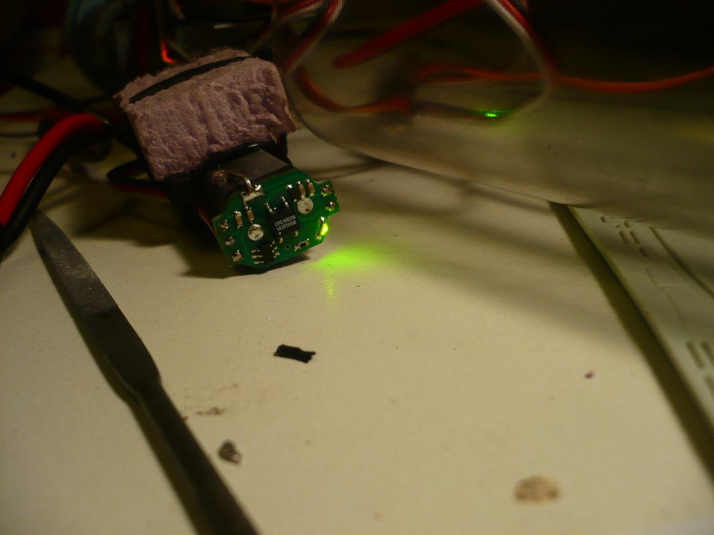

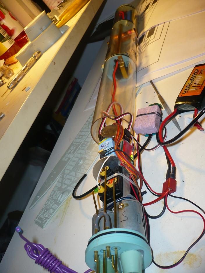

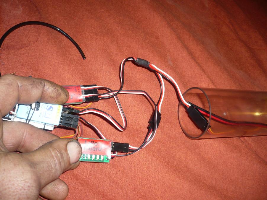

    ok still moveing along..battery room and mission switch compleate with strain block..haveing some issues getting the electrics right..here is what i have so far..the lipo gard adf2 interface along with the lpb/ballest tank servo y harrness.if you guys need better pics or different angles let me know and i will post them as i would be gratfull for all the help i can get in the black art of s/d's i have been pouring over the caball's and gazzettes and i remeber a pic of the type vIIc snort induction line in the tower but can't seem to find it again was it in the sky periscope forward or the attack periscope to the rear?...many thanks shaneClick image for larger version

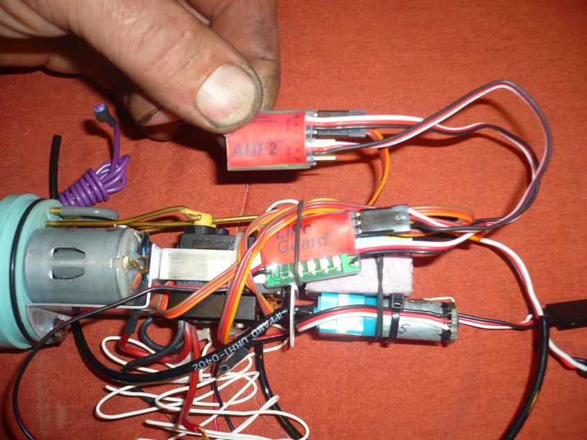

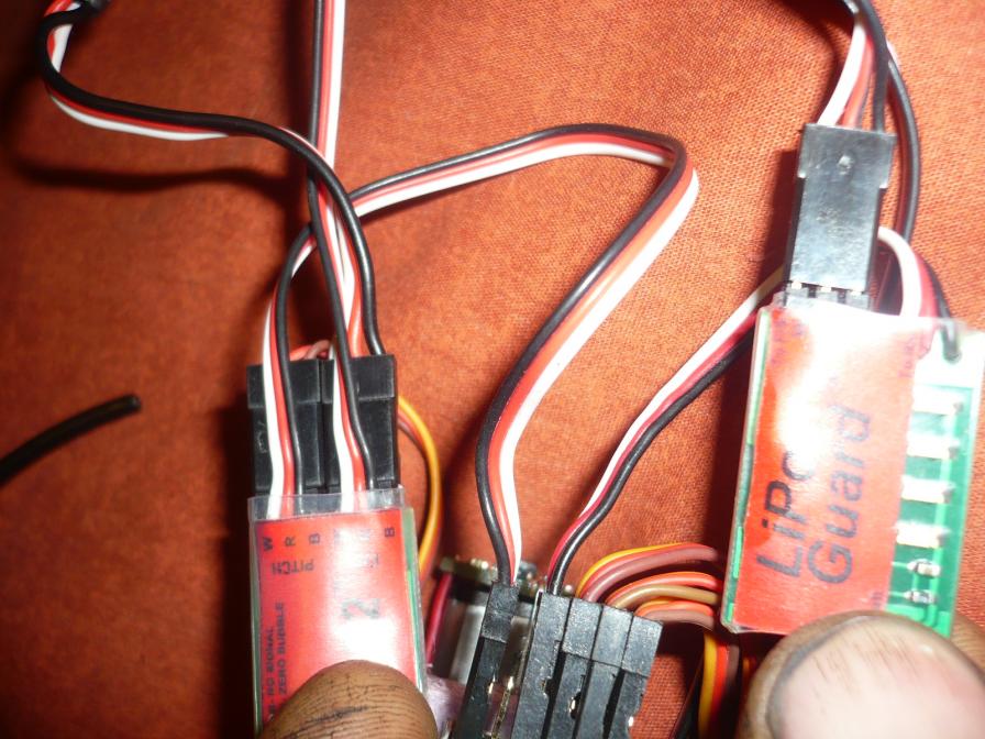

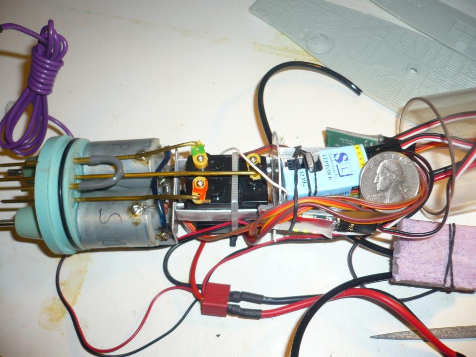

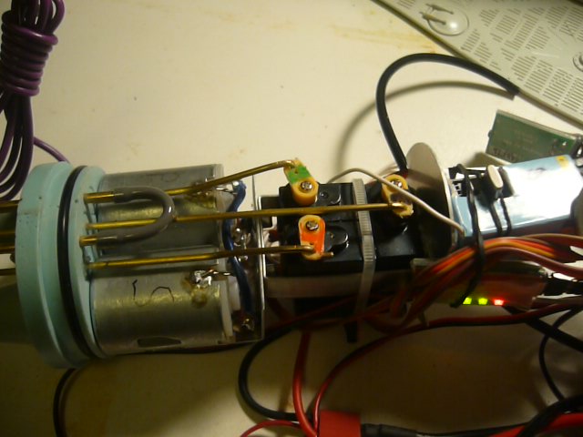

ID:	73646so i think i might be closer to figuring this out. so a little help from the senior captians would be great. as you can see i have the wyfly 6 and lepton 6..all of the hookups i have seen are for the 8ch receiver.. so i have it set up like this
      adf2 input to ch6 of receiver,stern plane servo to adf2 output..
      what am i missing?????
      lipogard to ch4 of receiver,input from adf2 fs side to lipogard..
      output of adf2 fs side to y harrness
      y harrness lead 1 to vent/blow servo
      y harrness lead 2 to lpb moter...
      but now ch5 is empty is that right??????
        • 13968
        You got it right.
        Why this gut-wrenching need to fill the receiver ch-5 port? You worried the Magic-Smoke will leak out of the receiver?
        Talk about anal-retentive!....
