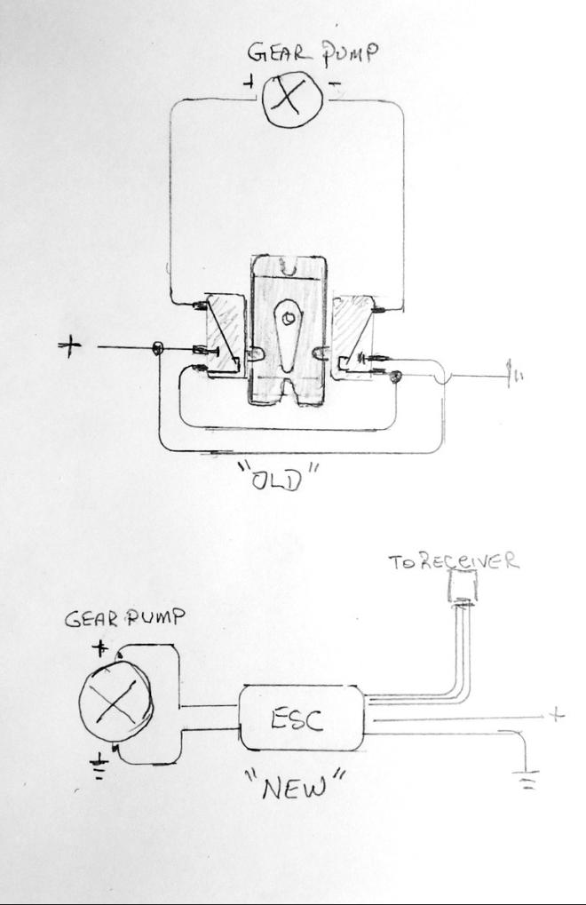

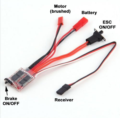

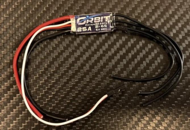

      After seeing these units discussed on the Dive Tribe meetings, I have used the 25 amp Escape 32 ESC from Aloft Hobbies for my geared water pump (brushed) and propulsion motor (brushless) in 2 models. They are small (12mm x 25mm without wiring), and easy to program if you buy their wi-fi link. The programming lets you setup for brushed operation, and you just wire in 2 of the 3 leads. Both my models are using a 70mm WTC, so they fit really well. They are also relatively inexpensive.
      Simpler than wiring in switches, and takes less room in your dry compartment.
