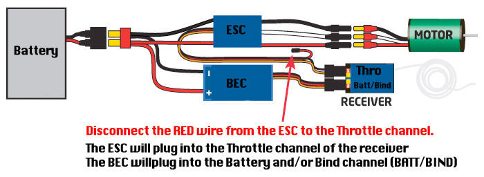

        Best to use a dedicated BEC board, dining off the main bus, qualified to carry a continuous 3-5 Ampere load; that board still a much smaller package than a dedicated receiver bus battery.
        This picture illustrates the small foot-print of a typical dedicated BEC board:

          If you don't want to use the onboard BECs, disconnect the red wires and run a standalone BEC. Those units can offer high output, steady current without the need for a separate battery.
ID:	196682 ...............
