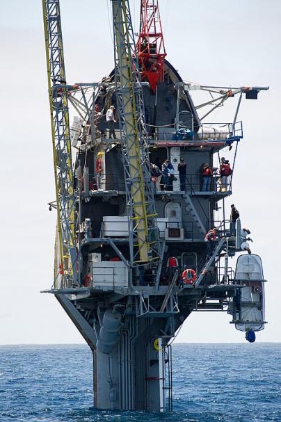

          I love it! I'm tossing around ideas to build a camera platform. I asked my "digital assistant" to create some plans for R/P Flip and this is what I got:
          Nice, H2S + water ballast is a killer combo for this.
          Here’s a complete plan for a ~4 ft (≈1220 mm) simplified, functional FLIP-style model, broken into segments that fit your Bambu Lab H2S (340×320×340 mm build volume). Bambulab
          1. Overall design & scaling
          Real FLIP:
          • Length ≈ 355 ft / 108 m
          • Max hull diameter ≈ 6–6.5 m Wikipedia+1
          Your model:
          • Target length ≈ 4 ft = 1220 mm
          • Scale ≈ 1:90
          • Hull diameter at scale ≈ 6.5 m / 90 ≈ 72 mm
