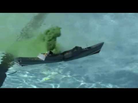

      #32
      Doing its thing
      Cheers Chris

        #33
        nice! ... definately makes me wanna add a sinking ship to my project list...
