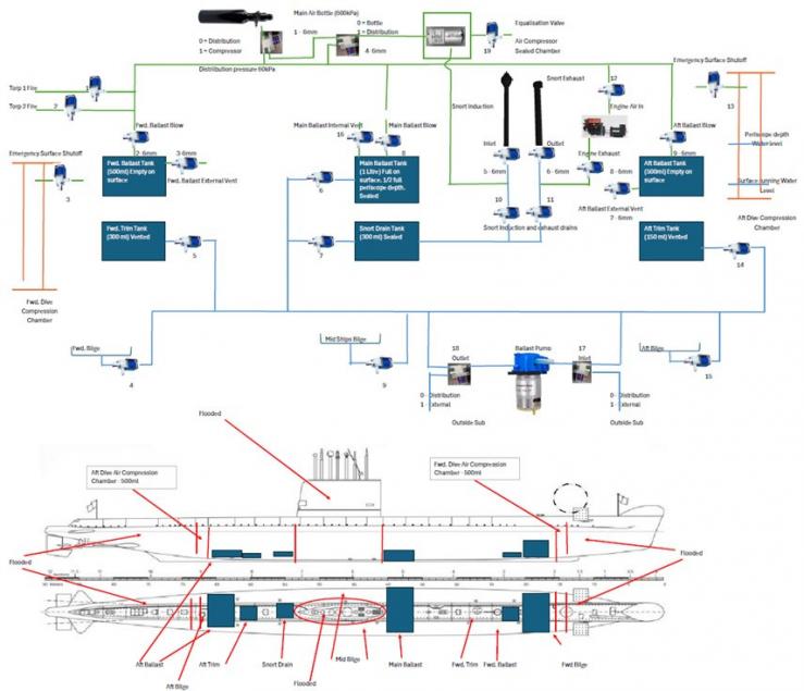

    RC Submarine "Open Diving Bell" Design
    Has anyone used the open diving bell design rather than WTC for a submarine?.
    I am in the process of starting to build one and wondered if anyone else has that could give me a few tips, rather than me reinventing the wheel.
  • Marylandradiosailor
    • Nov 2021
    • 75
    If the above diagram is on the internet could you provide a link as I can't clearly read the above diagram, thx.

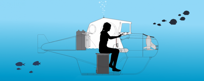

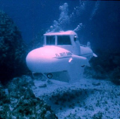

      So basically the Sportsub Click image for larger version
ID:	190987 Click image for larger version
        1. You're going to need a lot of ballast weights to bring that air pocket down and keep boat upright.
        2. Electronics constantly exposed to high humidity.
        • Johnny28
          • Sep 2025
          • 7
          The Submarine (Motors, Hull, battery's etc.) weighs approximately 6 kilos. Total air volume is approximately 8 litres; I will have 2 litres of ballast. I believe that with these numbers (And some lead and Styrofoam) i should be able to achieve a neutrally buoyant sub at periscope depth.
