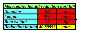

                  If you have Norbert Bruggens book, there's a formula in there which enables you to calculate the reduction in metacentric height for a part filled ballast tank.
                  I plugged the numbers for your boat, assumed 22kg overall displacement- same as Engel- and would get worse if the boat was lighter. Bear in mind that the metacentric height for a Typhoon would probably be 15mm if you're lucky.

                    Having two tanks half the length improves things quite a bit as you can see. Sadly another issue rears its ugly head if the tank is sealed- ensuring equal volume in each for correct longitudinal trim. The R&R twin pump system side steps this issue by locating the snorkel relief in the horizontal baffle, effectively acting as a limit switch for the pump.
                    Click image for larger version  Name:	mh2.jpg Views:	0 Size:	19.0 KB ID:	190734
