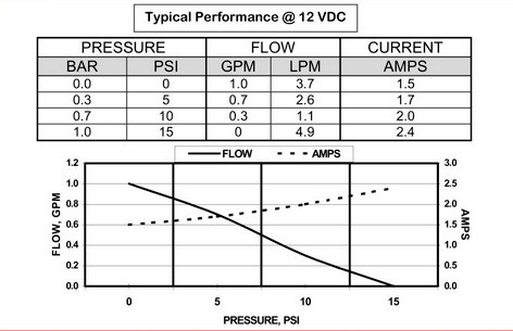

                The Shurflo Nautilus pump probably isn't a great choice if you're intending to run a system with a sealed tank. They max out at 15 psi, and flow is very poor beyond about 7psi. See the attached image.
                To half fill a sealed tank will require 14.7psi, I expect this is why the OTW system vents into the dry spaces to keep the pressure down, but then you need some electronics to monitor the water level. It would work fine with an aspirated tank with or without a valve/snorkel.
                For sealed operation you need a pump which can effortlessly make 15 psi pressure, which means either a gear pump, peristaltic or a good centrifugal pump- the latter of course not being bi-directional.
