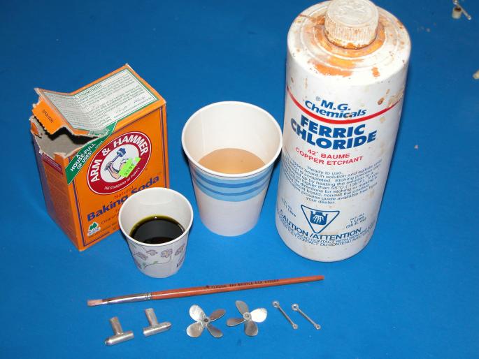

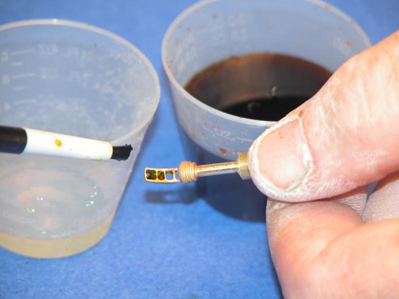

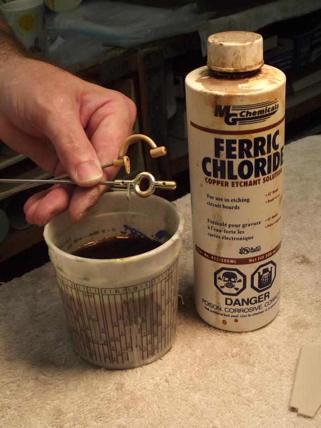

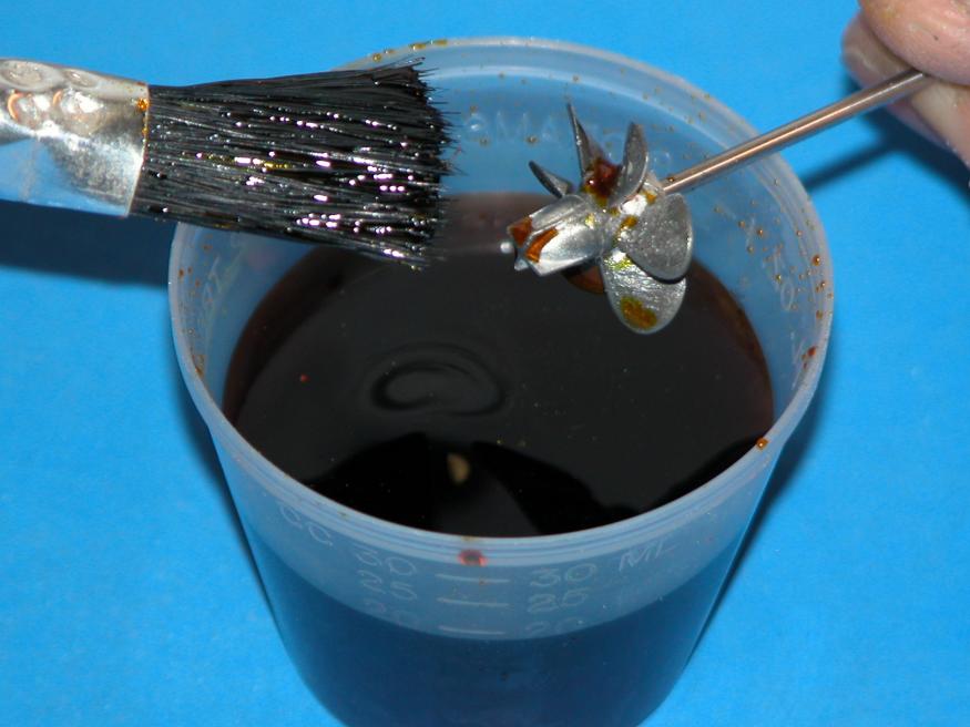

        I don't need an explosive fluid, Steve! That was just an illustration of fun stuff with a chemistry set! The f. chloride I inherited is very dark in the container, so I would like to know what percentage to use to pickle my metal parts. Anyway, I'm going deep!
          • 13674
          It's contaminated but still good for pickling copper bearing alloys. I have a jug that's almost black from decades of use and it's still viable for the job. Use with caution on aluminum based alloys though -- dilute the hell out of that mix before dipping.
