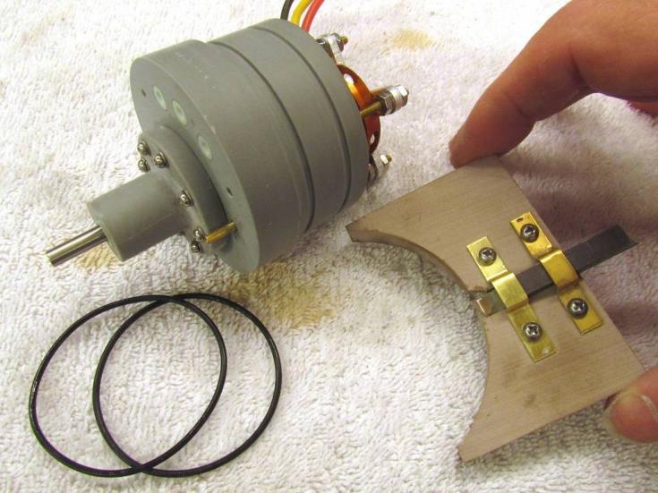

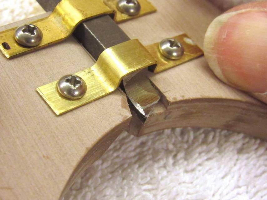

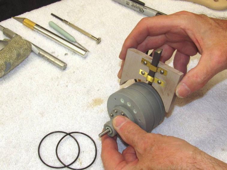

ID:	179510 Is this tool for;
          A. marking out the O-ring groove.
          B. cleaning up/widening/deepen the o-ring groove.
          C. manual cutting of o-ring groove.
            • 13976
            Click image for larger version  Name:	enAdyQ.jpg Views:	0 Size:	63.8 KB ID:	179508 Click image for larger version  Name:	szrGEk.jpg Views:	0 Size:	59.7 KB ID:	179509 Click image for larger version  Name:	udrMJW.jpg Views:	0 Size:	61.6 KB ID:	179510 Is this tool for;
            Yup. Saves me disassembling the bulkhead for turning on the lathe. This hand radial planer permits me to deepen the O-ring groove in situ.

              That radial planer...copy paste next diy tool! Got something like that, too, yet did never think of using a radial frame...
              Thank you for all those detailed pictures, David!
              So much can be done with simple hand tools, tend to use individual stuff on my projects, too!
