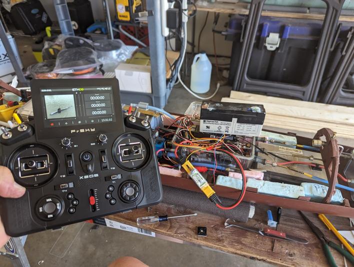

    The FrSky Dual Frequency install on the 591 appears to be a success! My first ever system using BOTH 2.4Ghz and 900Mhz simultaneously.
    Transmitter: FrSky X20S w/ETHOS OS

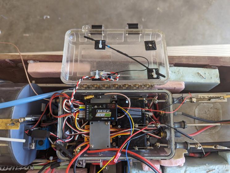

    Receivers
    Primary (2.4Ghz LOS at PD): ARCHER PLUS SR10+ 2.4Ghz (Gyro-stabilized receivers with a built-in 3-axis gyroscope and 3-axis accelerometer)
    Secondary (900Mhz Close aboard Deep Submergence) : R9 MM-OTA Receiver (connected via SBUS to the Primary)

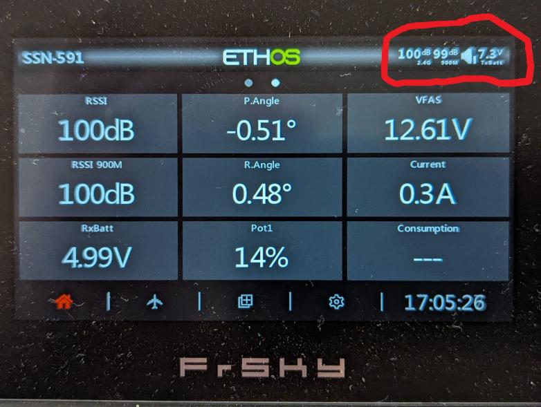

    Everything is up and running, still tweaking this and that (Dual ratyes/Expos) . Telemetry looks great!
    T-B, L-R
    RSSI: 2.4Ghz “Received Signal Strength Indicator,” is a measurement of how well your device can hear a signal. In other words, RSSI is a value for determining a good wireless connection.
    RSSI 900M: Same as above but for the 900Mhz
    RxBatt: Voltage the Receiver is operating at.
    P.Angle: The boats present Pitch Angle, aka her "Bubble", as you see sitting on her stand she's has a "Down Bubble" of ~ 1/2°.
    R.Angle: The boats present Roll Angle, aka her "List", she has a slight list to Starboard of ~ 1/2°.
    Pot1: Percentage of the Pot Dial I use as the throttle. 14% ~ A-A 1/3 bell
    VFAS: Main Battery Voltage ​​
    Current: TOTAL Current draw of the boat
    Consumption: Not sure yet, but I think it is the total current over time. If I ran at the .3A for 3 hours it should show the capacity that has been reduced from the battery IE .9A I didn't run it long enough to find out. Subtract that from my total capacity (7.5Ah) I have 6.6Ah Capacity remaining.
    I'm still playing with what I want on this screen, you can see in the area I circled that RSSI for BOTH receivers is diplayed anyway, along with the TX Voltage, so I may display something else!
