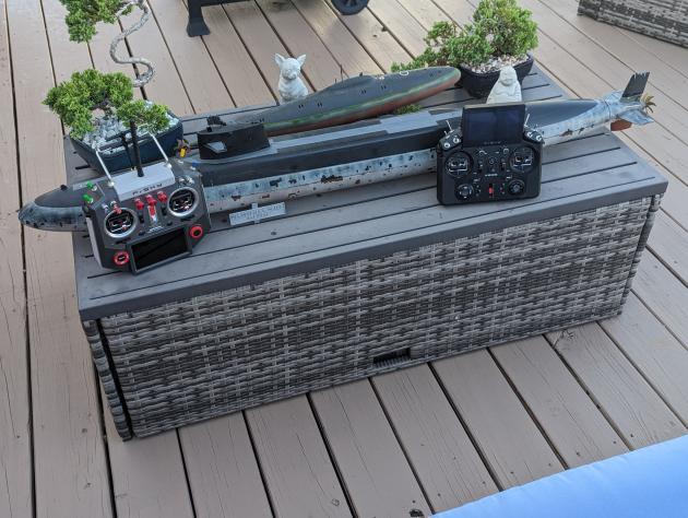

    For I have touched the future of North American RC Submarine Command and Control, and have found it….wonderful.
    FrSky Horus X10S Express 2.4Ghz with R9M 2019 900Mhz and Tandem X20S Dual 2.4Ghz/900Mhz. Both using the ETHOS OS.
    Do you want to know more?
    Attend the 2023-07-08 Dive Tribe Meeting!
    ​Click image for larger version  Name:	NUSG_BELUGA.jpg Views:	2 Size:	60.3 KB ID:	172021
    LR-FR
    Horus X10S Express and Tandem X20S Dual Freq
    USS ULYSSES S GRANT SSBN-631
    RU BELUGA CLASS: S-553 Forel

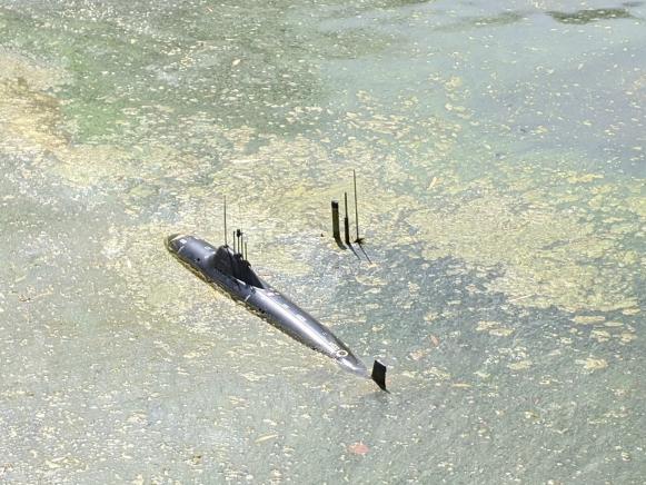

                    I would only run them in environments I can clearly see them, IE: A pool, and Event Like Cohutta, Groton or Carmel.
                    The rest of my Fleet, especially my go to boats, run in the an environment not suited for running below PD. It is this requirement I'm forced to run in 95% of the time. As you know I run every other weekend.
                    This is Texas Tea, with fast boats and sailboats. I need to run far (80-100 meters). I lose sight of my scope at only 30 meters, pucker factor peaks. She's about 2m off the dock here.
                    Click image for larger version  Name:	PXL_20230702_145024769.jpg Views:	0 Size:	57.3 KB ID:	172103
                    Kudos to those with clear water, I doubt they'd want to run here with me more than a foot off the dock submerged below PD.
                    So....
                    By sticking with say, a FrySky ARCHER PLUS SR10+ ($55) which has all those bells and whistles, and extending the 2.4Ghz antenna as I always have, I can run with no issues, and know I have no issues, as long as I can see the scope! Sailing at PD far from the surface craft shenanigans.
                    Murphy's Law is a "Clear and Present Danger" in my life. I've lost one boat, I won't lose another.

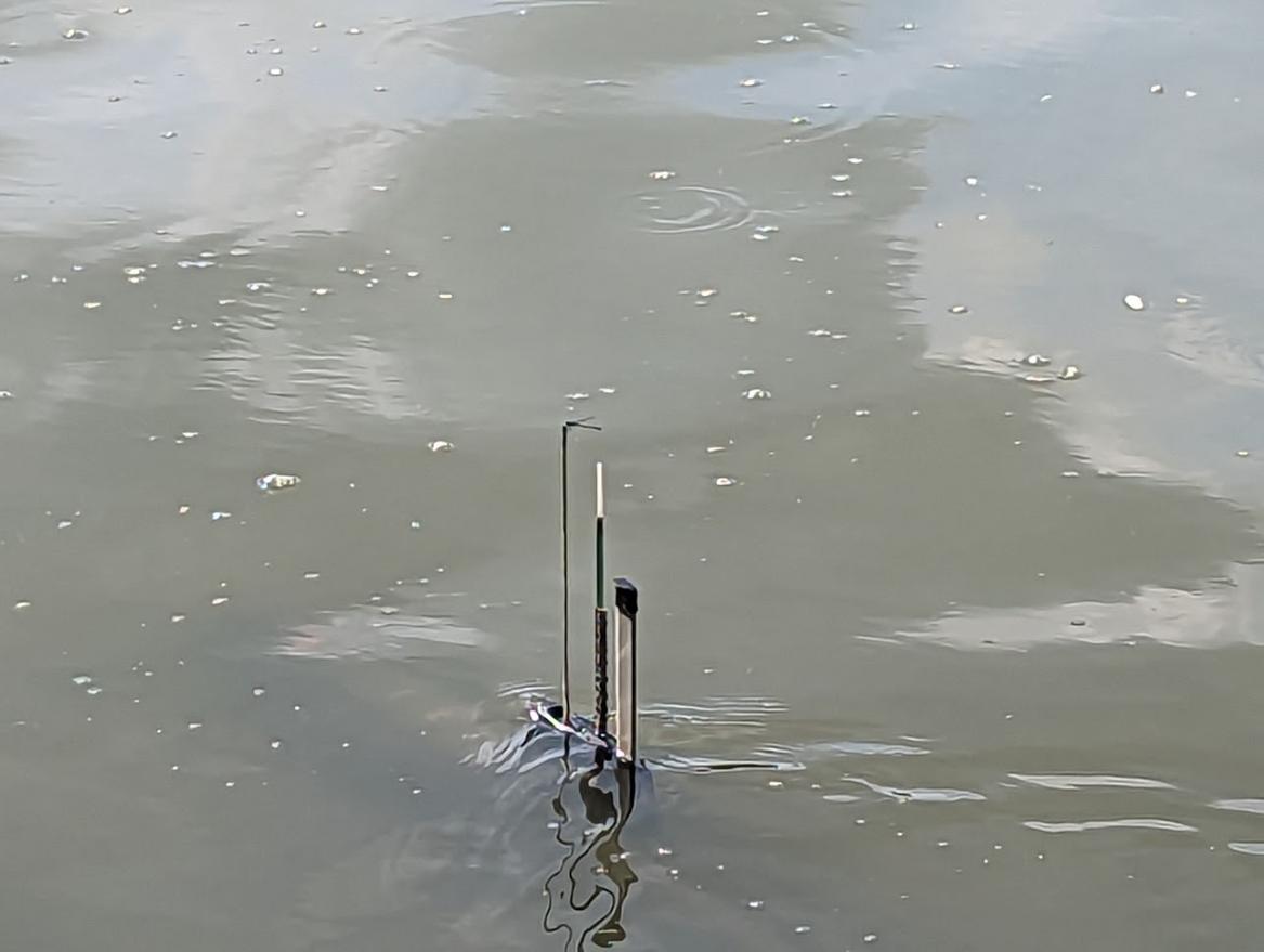

                    Remember the Buoyancy lecture I gave a few weeks ago? Keep the new boat, or boats out in the wild, positively buoyant. That's an inherent failsafe.
                    Well guess what? 2.4Ghz is an INHERENT failsafe for your $2k pride and joy! The system, and by definition, you, are forced to stay close to PD because if you drift below, the failsafe will kick in, gliding right back up, and if it's real trouble, blowing a tank 5-10s later.
                    In fact 95% of the time, for 75% of my boats, I probably WON'T need to bring the R9M at all.
                    The one day a year I hit Cohutta, Carmel, Groton, I can take those members of my fleet to Test Depth using the 900Mhz Redundant RX automatically. That btw is only 3 days a year for me. 2.4Ghz improves the odds for me
