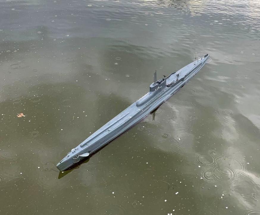

    As many of you know I own a large ass 1/48 Japanese I-19 submarine 7 1/2 feet long. The sub launch planes off its deck during WW 2. I was able to find a small RC Japanese Zero in China, Plane is tiny with only a 300mm wingspan. Is it a perfect looking Zero, no, but its close enough for what I want it to do. To take off my sub and fly. I will update this when I get it from China, hopefully it will work out

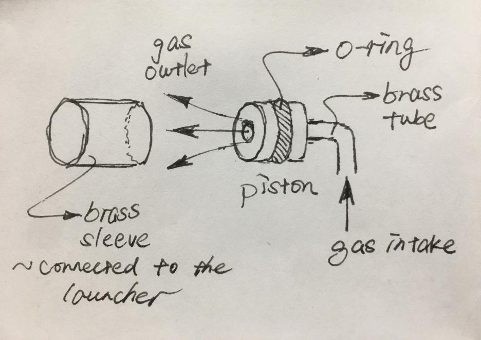

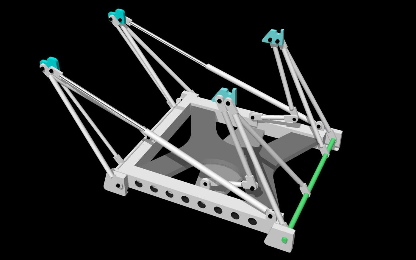

    I had this crazy idea of having a plane take off on a submarine, and there are a lot of factors to take into account when the submarine is running, like instability. So it might be a good idea to let the plane take off using pneumatic ejection, and the huge thrust from the compressed air could help the plane get the desired speed. We can fix a small copper sleeve on the launcher, sealed at one end. The open end could be inserted into a piston (with a little hole to let gas out) , and when compressed gas is ejected from the piston's hole , the launcher could be launched along with the aircraft. Of course, you want the launcher to stop at the bow, which might be another problem.
    V
    The launcher (from I-400) :

    Launching mechanism, you may need a poppet valve connect to the piston so as to release some gas at the moment.

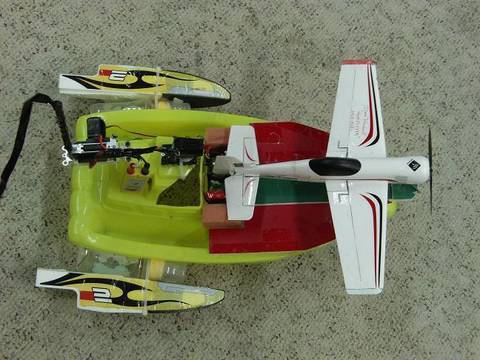

            The plane hardly has any weight to it. So it can take off in like 5 inch of space. This first plane will be alittle bigger then is should be. If this does work, I will get someone to make a perfect scale RC plane for me. But the Sub does have the room.

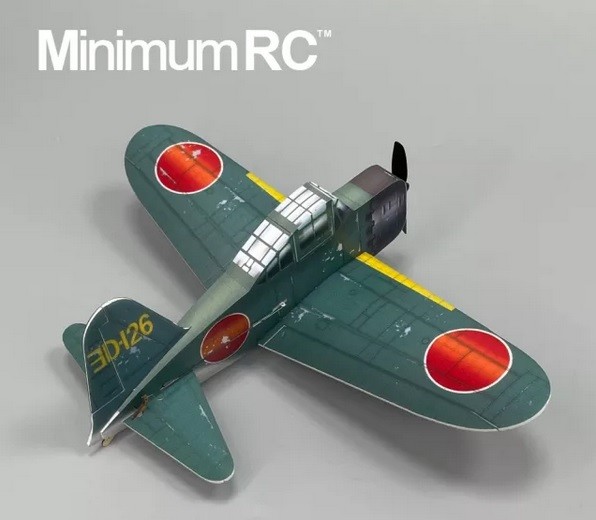

                              Here is a picture of the little plane I bought. It weights 33grams.
