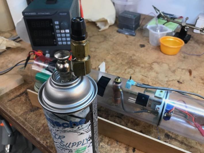

    Need some help. When I invert the airbrush can and apply to the schrader valve, the liquid spews forth between the canned air valve and the value on the SD. Nothing gets into the pressure container. The valve on the pressure container seems OK. I'm guessing the canned air valve is not able to press down far enough on the schrader valve and not filling the pressure container.

    Is the core-valve atop the emg. gas bottle jammed?
    • Bob Gato
      • 898
      It doesn't take much gas to pressurize that little capsule-are you absolutely certain that there is no pressure fighting the liquid gas fill-80psi of gas on the inside and 80psi of liquid on the outside trying to get in and it wont happen
        Touch the valve with a pen. If nothing comes out, go get a new valve and replace. Try again.
        • wlambing
          • Nov 2020
          • 402
          Ken,
          You need to put a tire valve stem extension on the Shrader in the WTC. Your can nozzle is not seating because it bottoms out before the seal in the nozzle can seat. I've used one for charging for years. A couple of bucks for 4 at the local auto store should fix you right up!

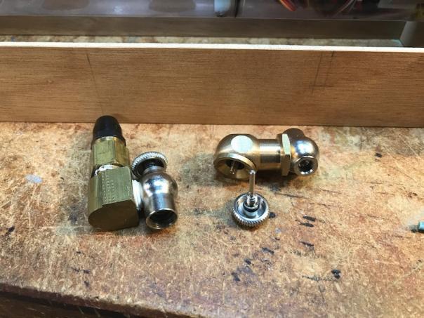

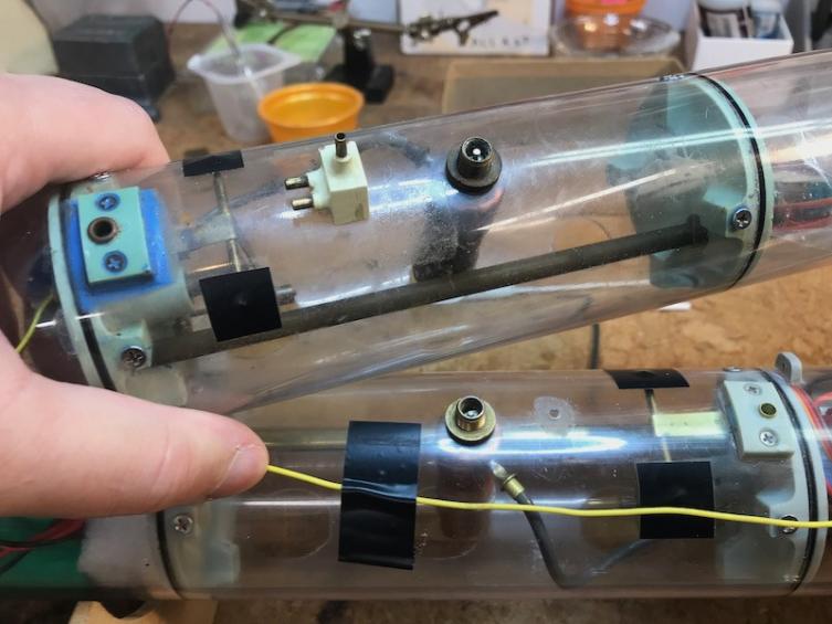

            Had bit of CF's going on here. All resolved!!!

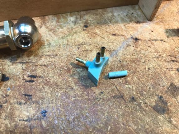

            I knew I had a second filler valve around, found it in a toolbox. I tried both valves on a broken SD that David replaced for me. They both worked OK. Then tried then on the Marlin SD. Both worked OK. Must have been my technique. But in doing so I just touched the manifold next door and it just plopped off. Can the coldness of the propellant cause the CA glue to give way? I sanded the surfaces down and glued the manifold back into place. When David sent me the replacement SD he inadvertently left the rubber plug in place to glue\locate the manifold, so I had that to help. It pays not to throw anything out!
            Next to water test this SD. But now I need to run to the store and pick up more propellant as now I'm out. And will pick up an extender like Bill mentioned. Trying to get this done for an event I'm going to on Sunday out in Shrewsbury PA.

              One other thing, the Marlin SD, once filled with propellant, leaked. So I cut brass tubing to fit the schrader valve so I can tighten it up.

                CA glue is great in tension as seen on TV(the guy with the hardhat glued to the beam) but not so good in shear load (I use it to hold pieces of metal together for drilling-then a knock with a small hammer and they shear apart) I do believe that as the plastic shrank unevenly it could have sheared itself off.
ID:	156683 $1.98 amazon
                  I used RTV to mount my manifold when I did the same thing you did.
