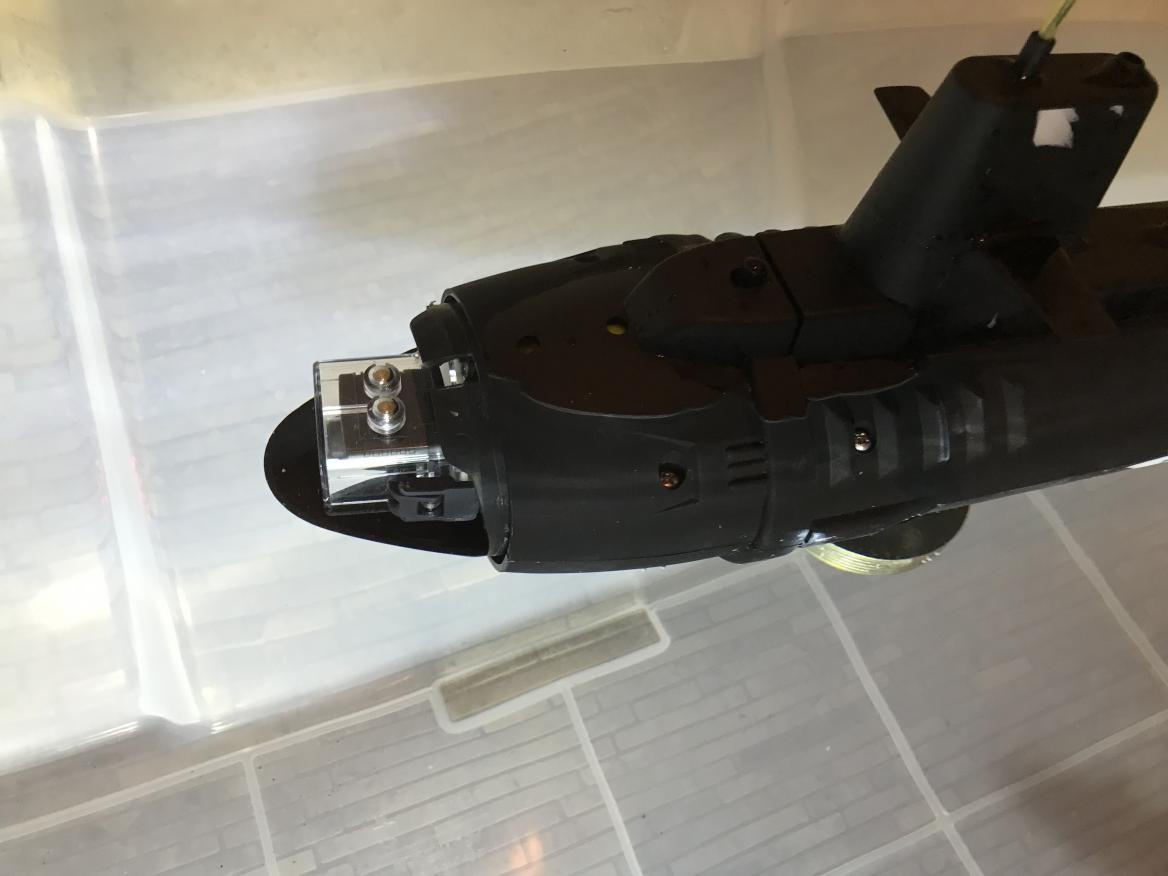

    Turns out modifying the boat to adopt the camera is fairly easy: Just had to flatten the crew's backwall, then leave out the instrument panel (comes out easily) and glue the compartment to the backwall. Also left out the dome as it would have to be cut anyway to not distort the lens and give access to the camera. Used just double sided tape to mount the camera (slightly misaligned). So far so good, doesn't even affect the forward/rear balance of the boat.
    That said I don't have a video to show: Turns out the fully charged batteries from a week ago have self depleted meanwhile. The camcorder is also fairly prickly about storing video footage: It seems that it needs to have at least a 5 minute duration to auto store. Anything before that (as in my case a dying battery) and it will not write it to the card. You can of course manual force a stop, but that's tricky with the waterproof casing. So I have to charge the batteries and try again.

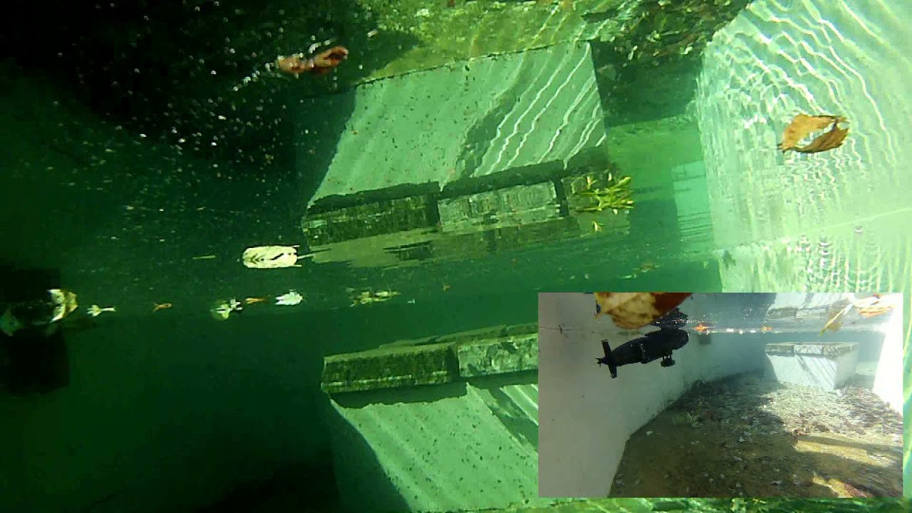

              Here is a brief video that shows some of the footage from the fountain, onboard camera as well as exterior view:

                              Succumbing to peer pressure I finally had a chance to make a longer version. Here are two minutes of it until the boat gets caught by the deadly sea weed. Nah, was easily retrieved, but did wrap itself around the vertical prop, which prevented any further dives until I had all the bits and pieces removed.
                              The technical issues I had originally were due to a different format of the cube camera compared to the gopro. My video editor software got all confused. Once I made all the footage the same resolution, it was smooth sailing putting it together.
