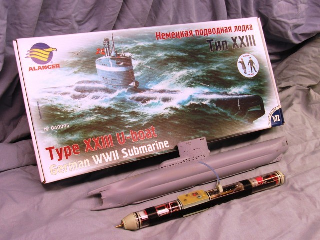

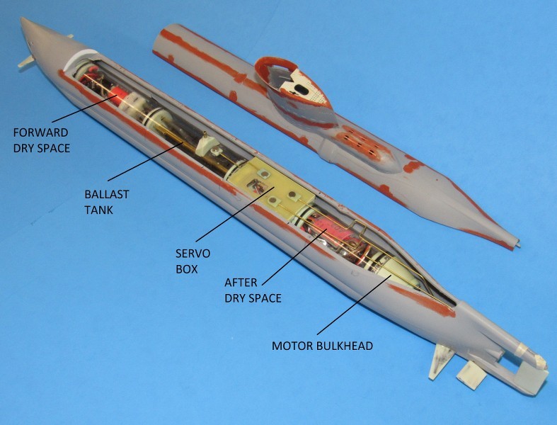

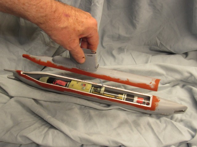

            I was looking for some additional info in other sites and forums about David's 1.25 Subdriver and I stumbled across this 1/72 Type XXIII he was fiiting out with a small diameter static diving subdriver https://www.theassociationofmodelsub...type-subdriver. Click image for larger version
ID:	152803Click image for larger version

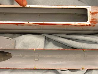

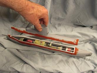

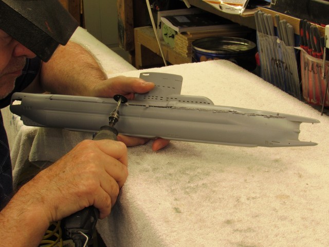

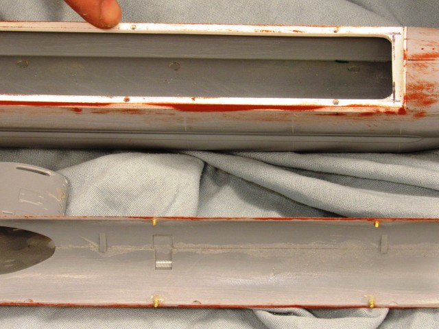

            That indexing pins and flange along the longitudinal cut is a great idea that can be used on the X-craft. Click image for larger version
ID:	152800Click image for larger version
ID:	152801Click image for larger version

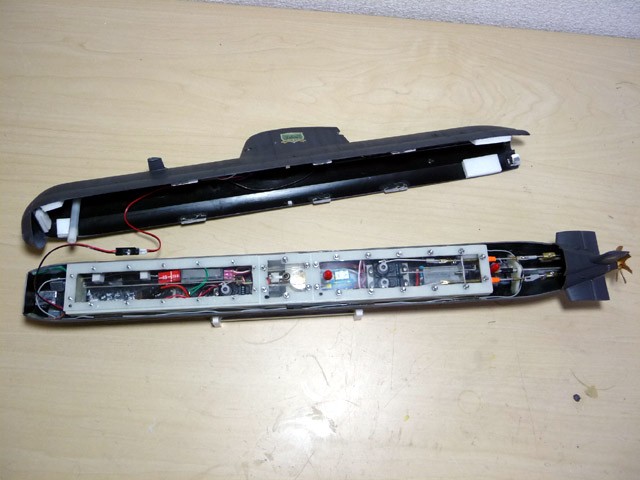

                    Not mine but nice.
                    Regards Gantu
