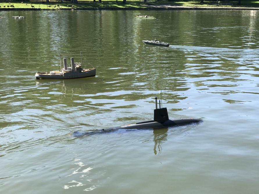

                  Whenever I hear 'tethered buoy' I think, fouled propeller.
                  ...word.
                  Comes to mind with the so often talked about "24Ghz 'trailing antenna"
                  NOT with the crowd Bob and I run with!!Click image for larger version  Name:	2019-08-11 10.30.11.jpg Views:	0 Size:	102.7 KB ID:	147111
