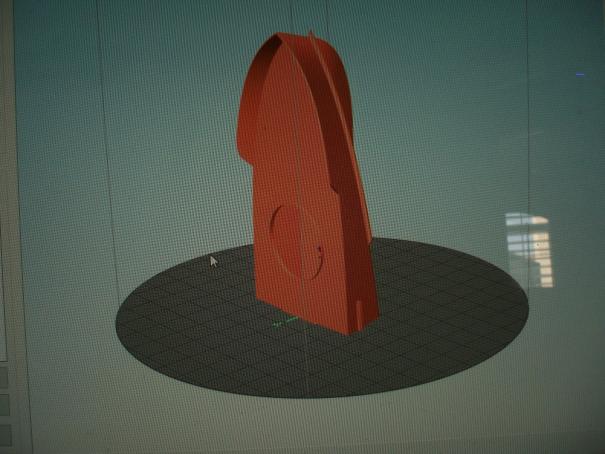

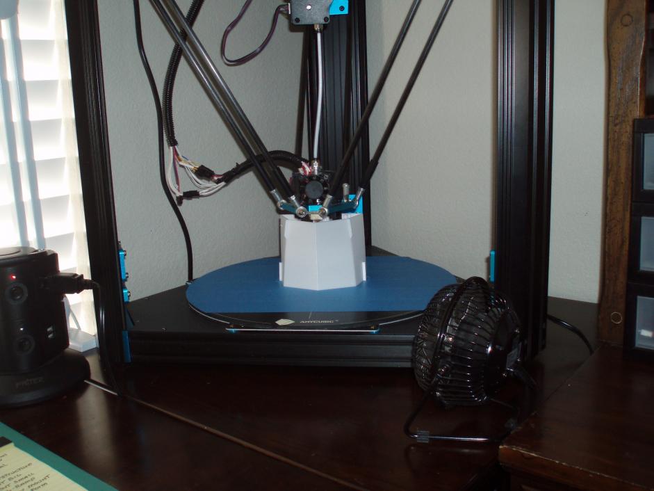

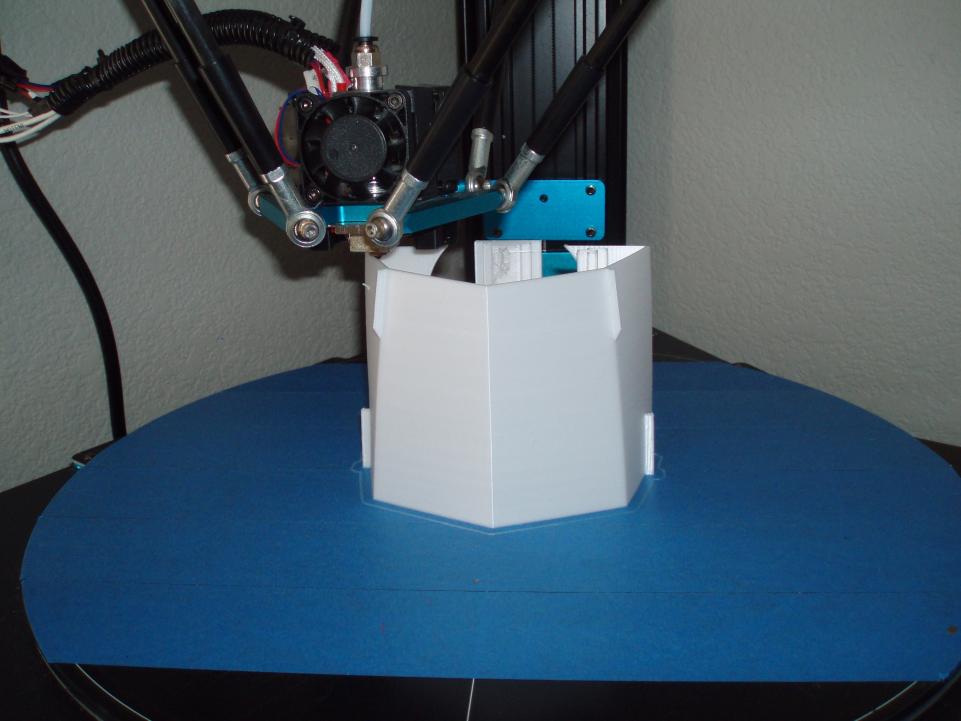

    I am having to use my Predator on this first hull section because it is a little over 12" long! The next sections will be in the 5" to 6" range! I am using 100% infill on the hull in order to help in the sealing process.

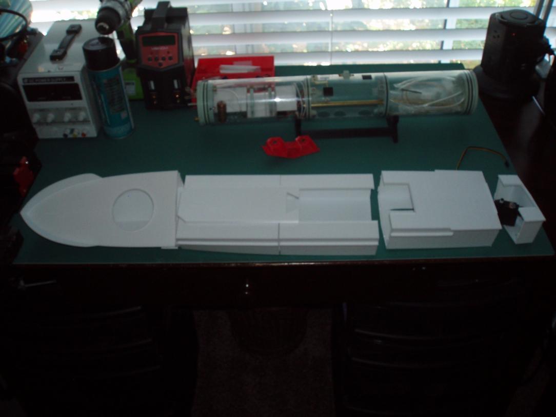

      I have completed the 3D printed hull pieces on my Sub Chaser.
ID:	143391Click image for larger version
      Now we can move on to some fabrication, and working on the interior RC systems.

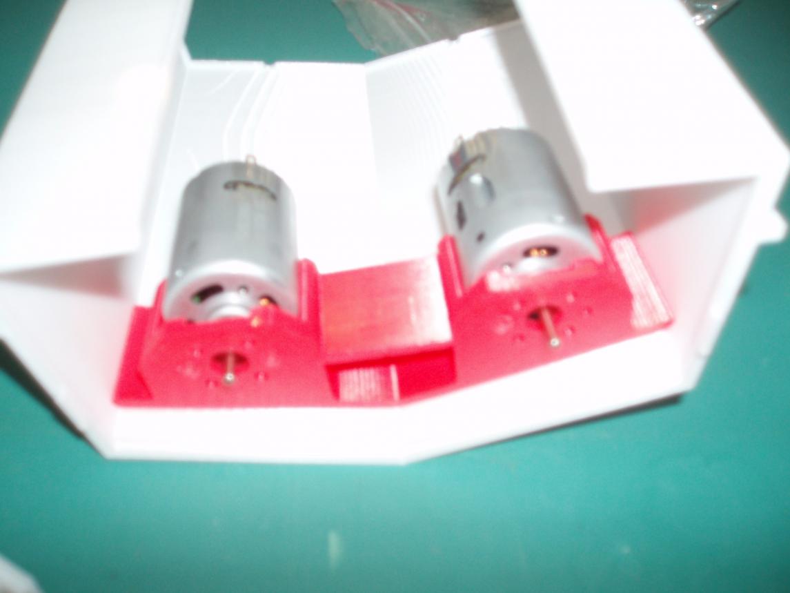

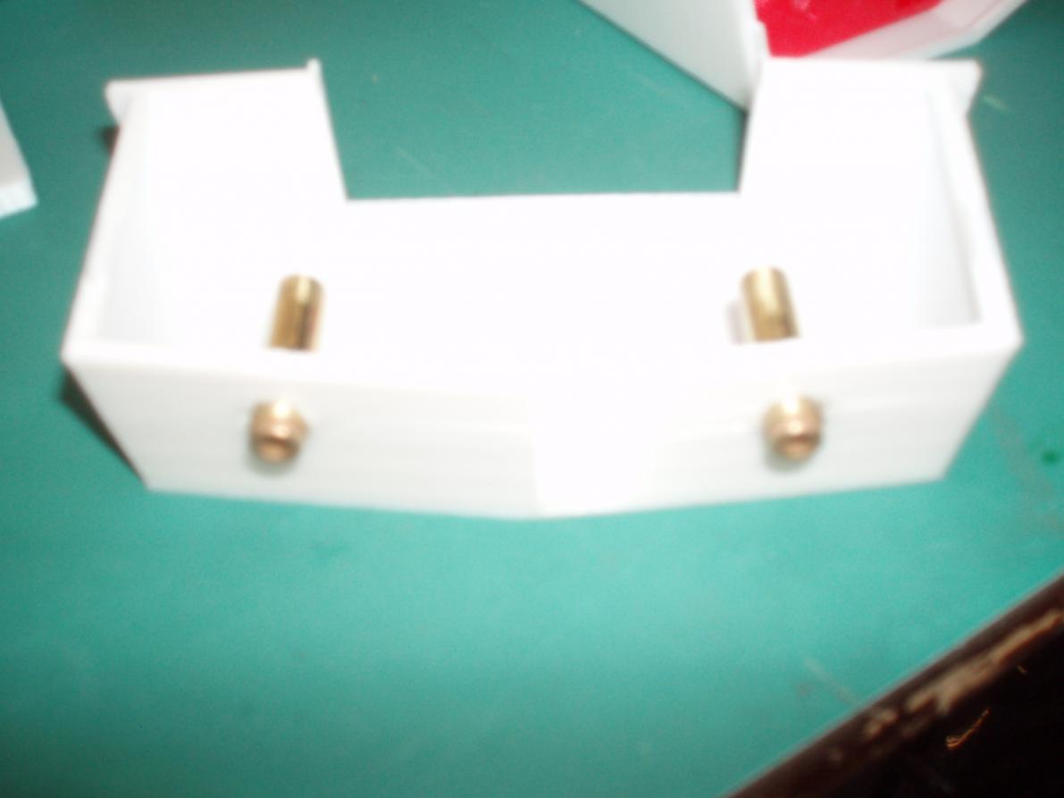

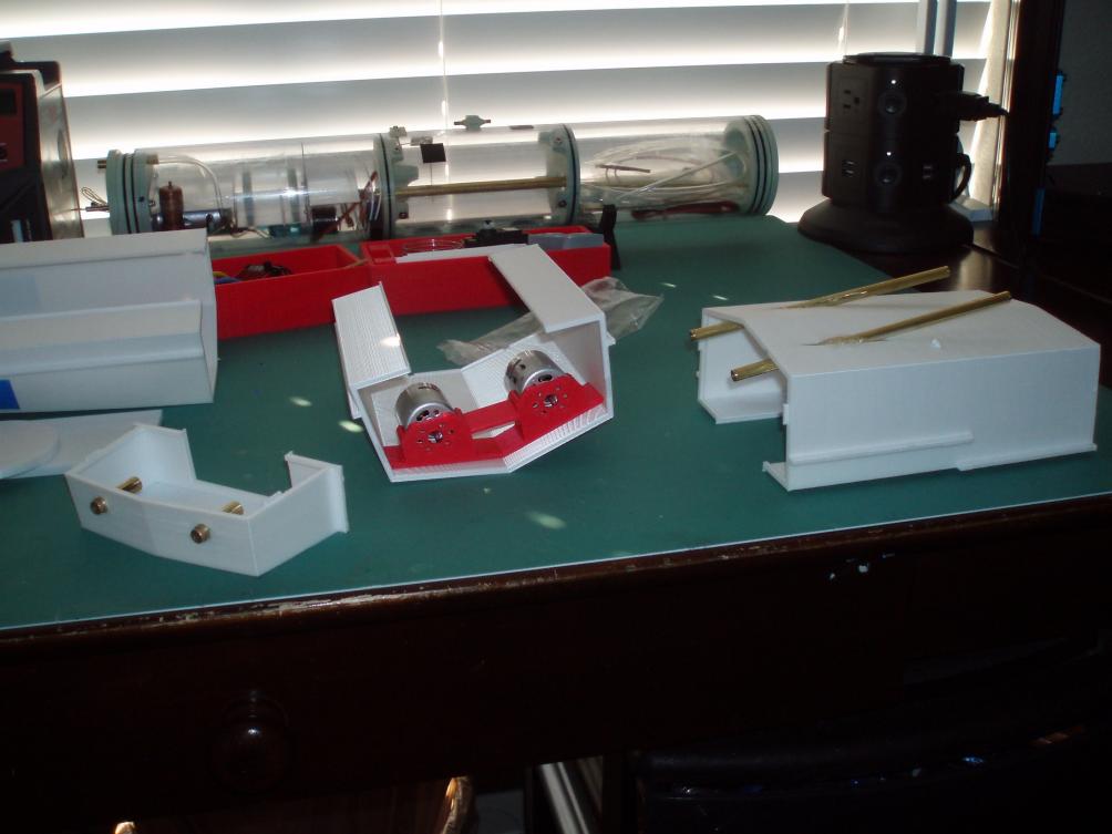

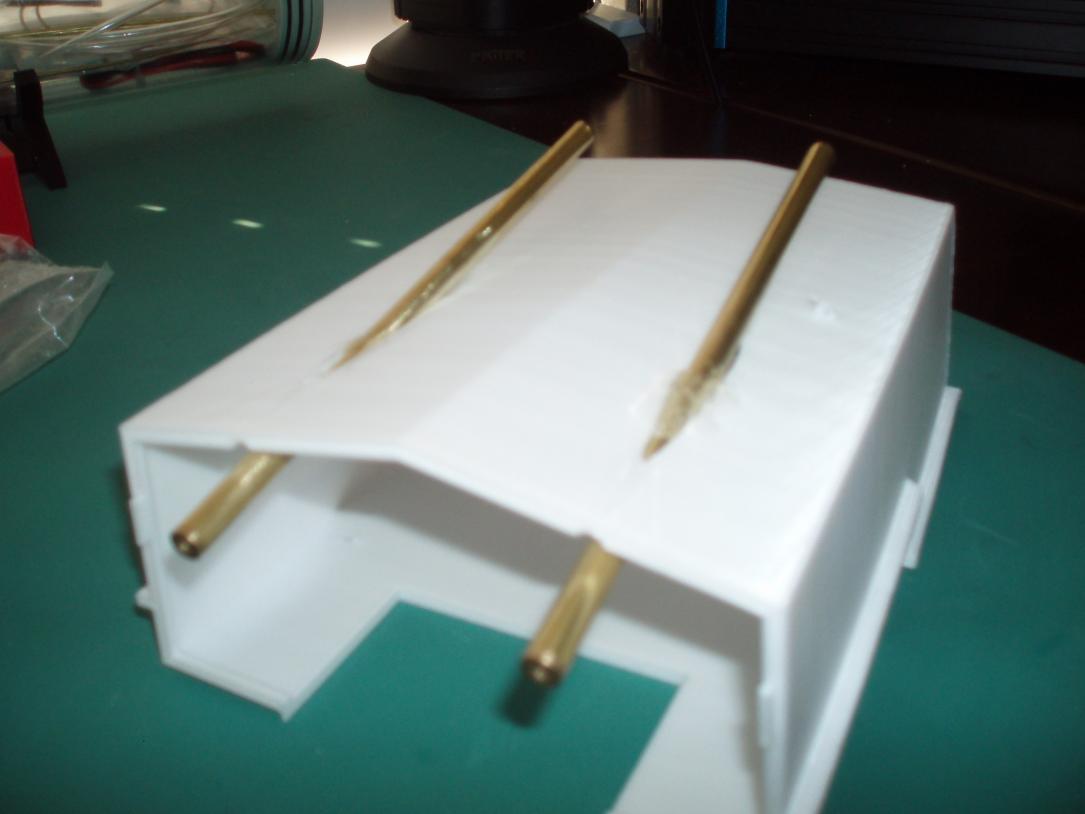

        Today I have made some headway on the control and propulsion system.
        Click image for larger version  Name:	P9080001.jpg Views:	0 Size:	61.8 KB ID:	143432Click image for larger version  Name:	P9080002.jpg Views:	0 Size:	48.6 KB ID:	143433
        On the Rudder bushings I used a simple build your own water tight seal application that Bob Martin (Nautilus Drydocks) put together on a YouTube on how to do it for Submarine application and in this case a Surface runner Boat.
        Click image for larger version  Name:	P9080003.jpg Views:	0 Size:	53.5 KB ID:	143434Click image for larger version  Name:	P9080004.jpg Views:	0 Size:	46.2 KB ID:	143435
        On the propulsion system, I am using two small brushed motors that will be installed into a cradle I designed on Simplfy3D Cad works! The prop shafts are two extra 1/8" shaft Stuffing tube kits that I got from Harbor Models Inc. Everything is tact glued in place and will be secured in place with Z-Poxy fiber glass and resin ounce lined up!

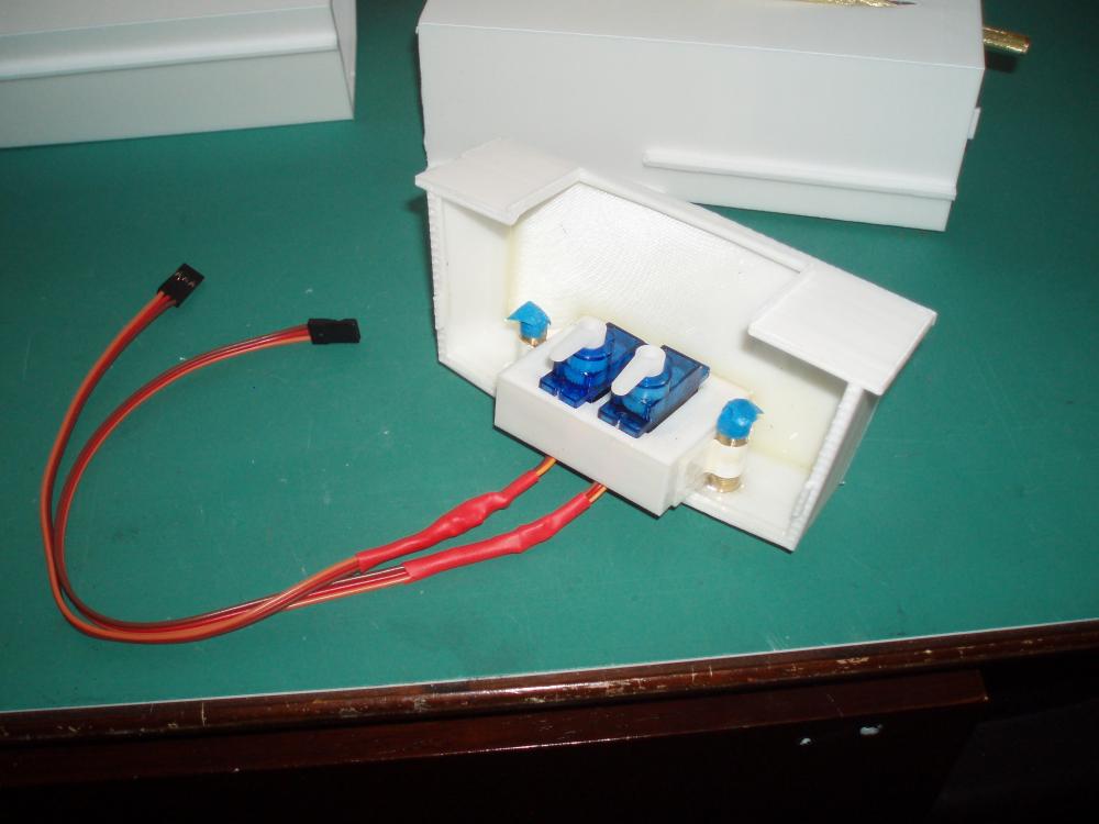

          A little more progress today!
ID:	143502Click image for larger version

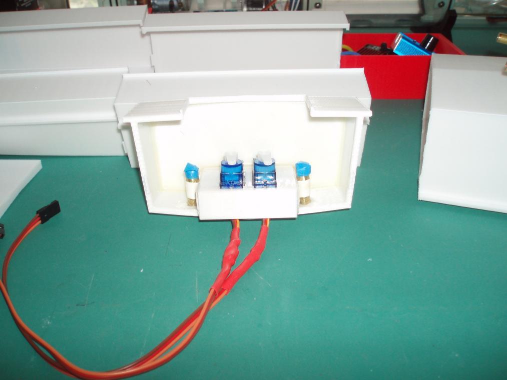

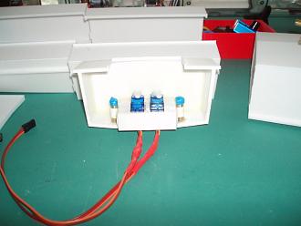

          I fabricated a servo tray to house two 9g servos, one for each of the rudders!

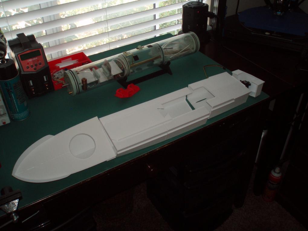

                        The Sub Chaser is in it's final stages! Starting to put the deck together along with my first coat of primer on the hull.
                        Tomorrow I will begin the final finish work on the hull! (sanding, more primer, and more sanding) I did put primer on the interior of the hull as well. I may or may not put a seal coat of resin on the exterior of the hull!?
                        I think with a couple more primer coats and then the final enamel finish it should be enough to seal out the water. This boat was built for swimming pool operation only, and if it hits the pool ounce a week for 30 min. at a max. I do not think leaking will be a problem. (NOT SURE WHAT THE vBulletin MEANS)

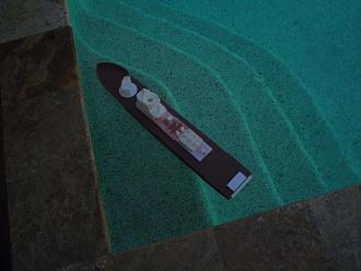

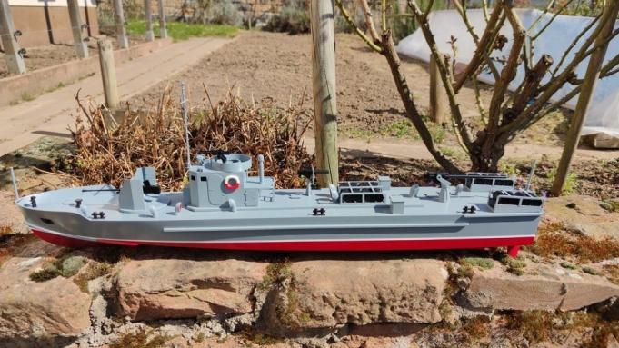

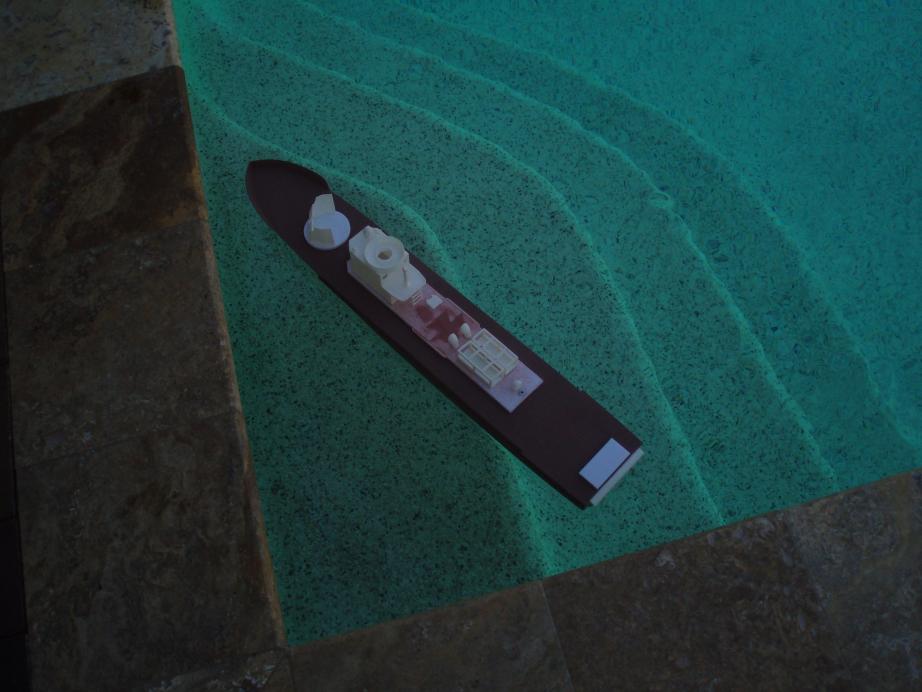

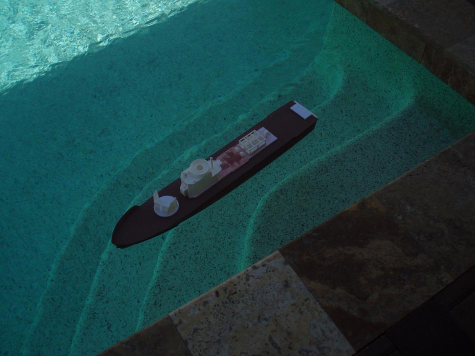

                          Today I put the Sub Chaser to the water! The water line was right on with all the electronics and battery on board. No leaks after 30 min. on the water!!
ID:	143963Click image for larger version
                          Sorry the photos are so dark! I kept it close and into the shade to make sure it did not leak and go down!! Very pleased! Now onto the finishing up of this project!
