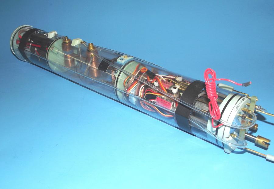

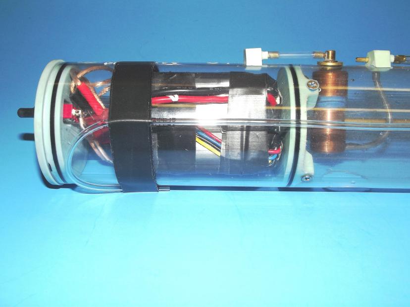

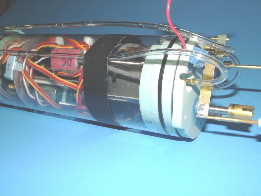

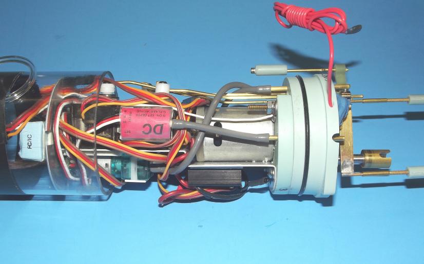

    Evening All. Would anyone with some experience using Kevin McLeod’s Depth Cruiser mind sharing their thoughts / opinions of it? Seems like a slick setup. How did you go about fabricating the pressure pick-up tube? I was considering mounting a 2.25” vertical length of 1/8” or 3/32” brass tube to the exterior forward bulkhead of my SD, then connecting it via 1/8” urethane tubing to a nipple that will penetrate an unused depression in the after bulkhead, and onto the DC inside.

    DC only needs access to the exterior of the cylinder. No need for extensions. Just a hole. A simple nipple made from brass tube is all you need.

      Oh really? Interesting.... I saw a picture of a SD that David had a depth cruiser installed on and that’s what I thought I saw. I’m very excited to get this hooked up and see how it does.
