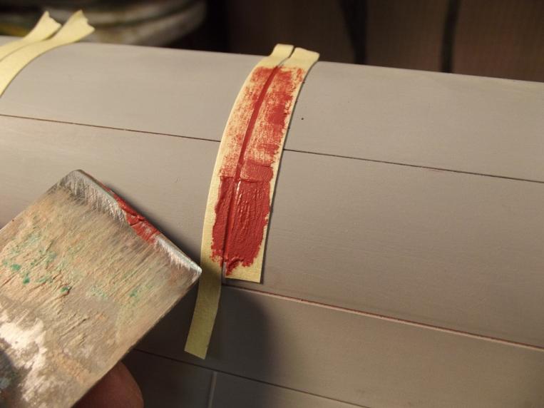

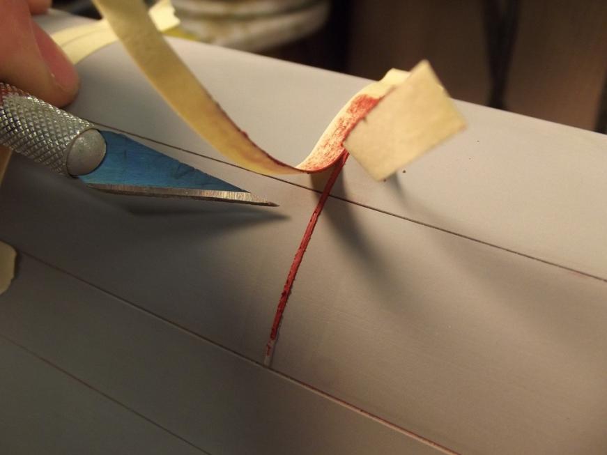

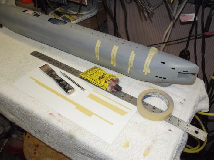

          There is another trick to restore weld lines that might be even easier. You place masking tape left and right from the position you want to restore the weld, laving only a tine gap with the width of the weld line. Then you apply the putty, scrape it flat removing the excess putty and then peel off the tape. Easy....
            • 13990
            #3320
            great minds think alike:

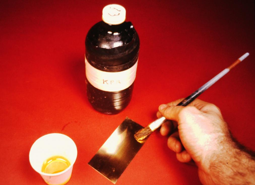

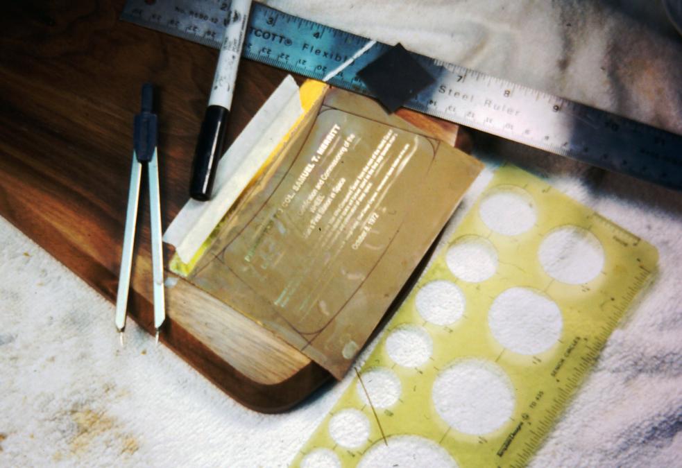

                  Do you flush the brass parts after etching them with ferric chloride?
                    • 13990
                    #3324
                    Yes. Fresh water spiked with a little baking soda to kill the acid.
