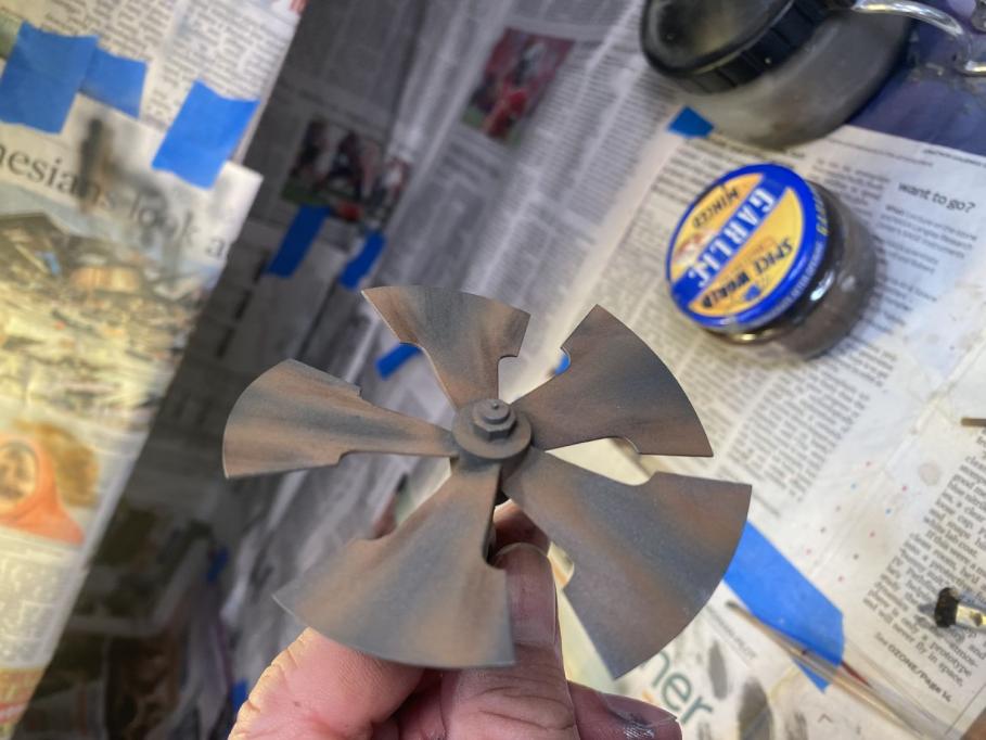

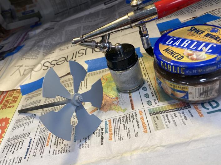

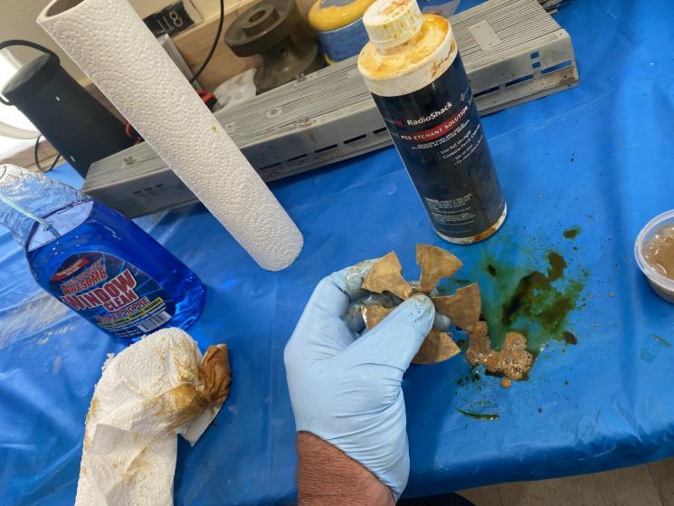

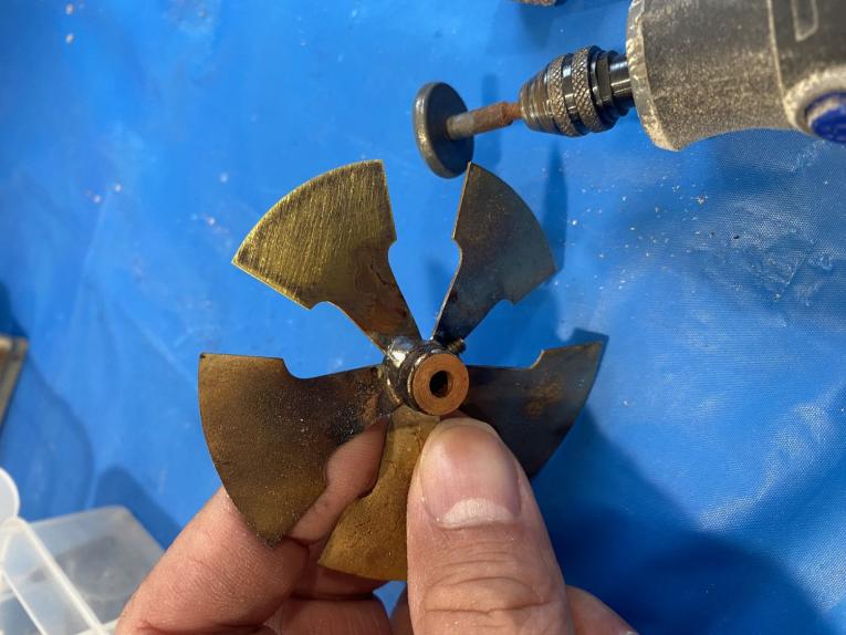

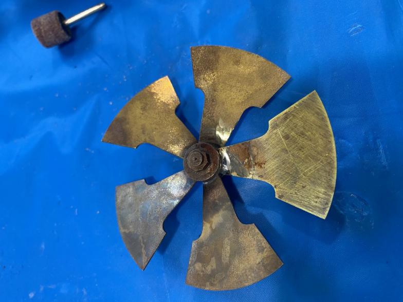

                            Took a metal-impregnated rubber disk to clean up the solder and made short work of clean up. Pickled it, then primered with the latest Dupont automotive primer. Finished with Tamiya acrylics, dry-brushed a metalizer, three coats of flat clear coat. Hope this one will hold up. Photos of course are out of order. Figure it out.Click image for larger version

                              Hey!... dumb-ass: your pictures are out of order!

                                Makin' sure you're not slackin' over there...or sleepin'. There'll be a test later. See you in the AM.
