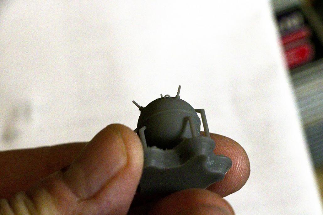

    I know someone will cringe at the thought of a 3D printed anything, but I wanted some mines for an aquarium redesign I am thinking of with a Type VII submarine.
    There were a couple of mines at Thingiverse, and I modeled my mine after one of them. I wanted mine to float so it is hollow. It is not the most accurate, but fun to put together. If anyone has plans of a real WWII mine, I sure would like a copy.

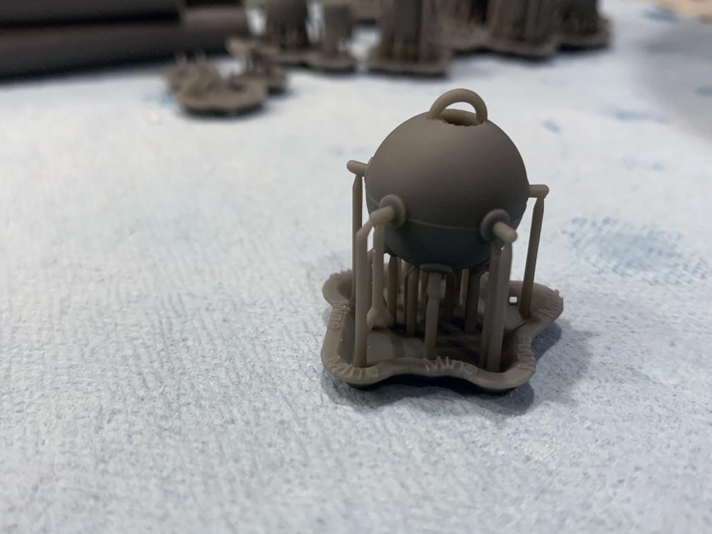

    Here it is out of the printer (upside down)

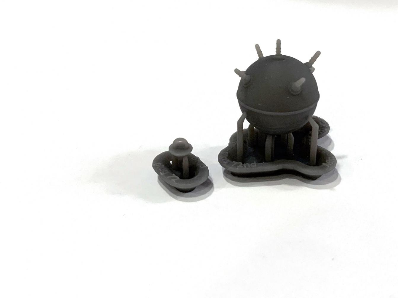

    Here it is removed. I broke a couple of prongs off the mine by carelessly removing the sprues.

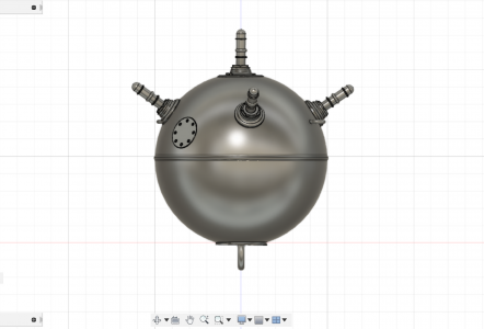

        i am currently re-doing the mine to be a German accuratish (that is sorta accurate for you word police) mine. I will use images and drawings. I believe they are 44” in diameter in 1/72 scale that would be .61 inches. Although once done I can make it in several scales.

          Newest version, how does it look?
          I am going to print this up and see how it comes out.

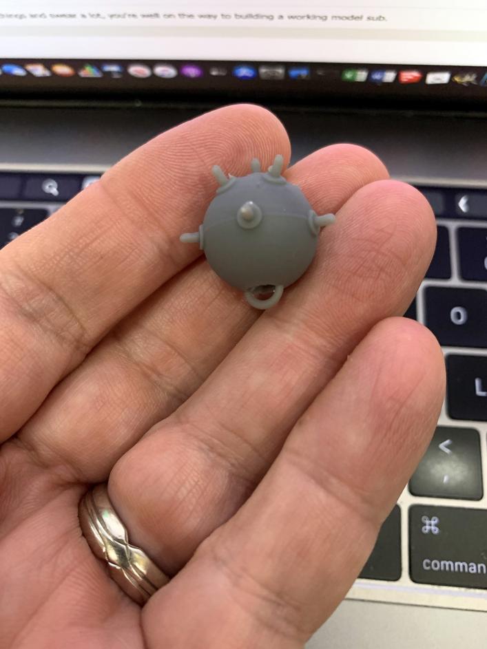

            I went through a couple of revisions. Went for accurate.
            The pins on it were/are very delicate and were not Hollywood enough for me.
            So, I made this one:

            I will stick with this one. The larger pins show up better and offer a stronger resistance to my clumsy handling. The plug will sit in the bottom of the mine and be tied to a cable or fish line or chain. This gets CA'd together sealing the air in the mine.
            The older set has been/is being water testing and so far the absorption of water is about 4%. Still floats and does not loose any properties that I can tell. I will paint some and test again.
