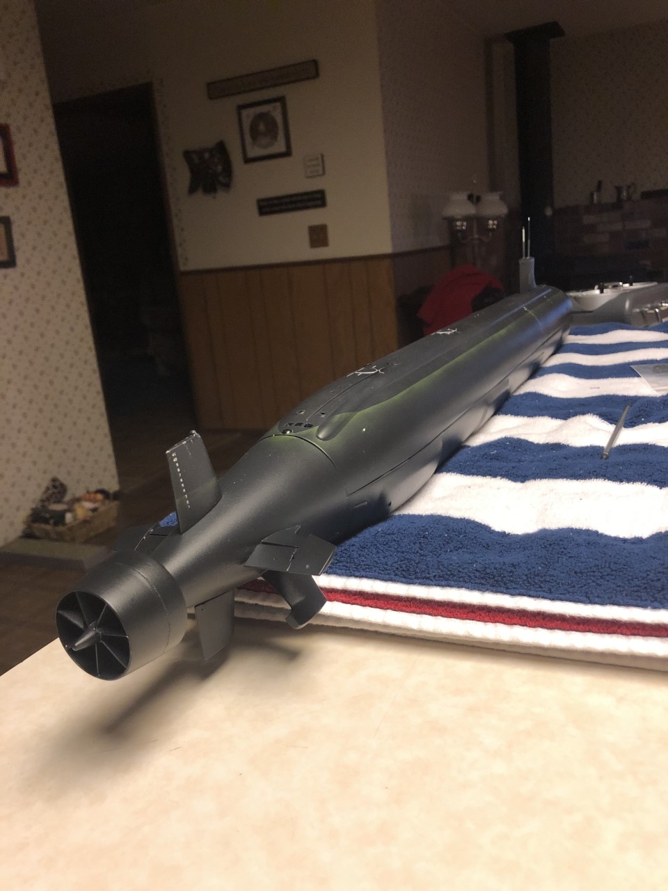

                    #39
                    Been hard at work getting things back together. Some pics...
                    Non working things
