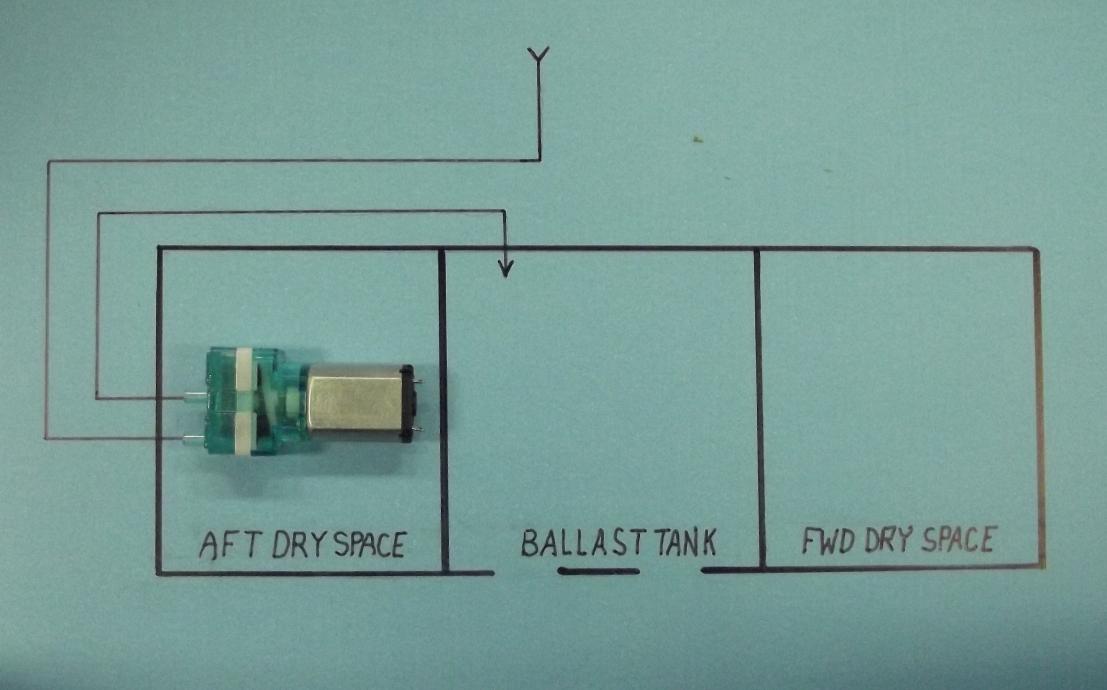

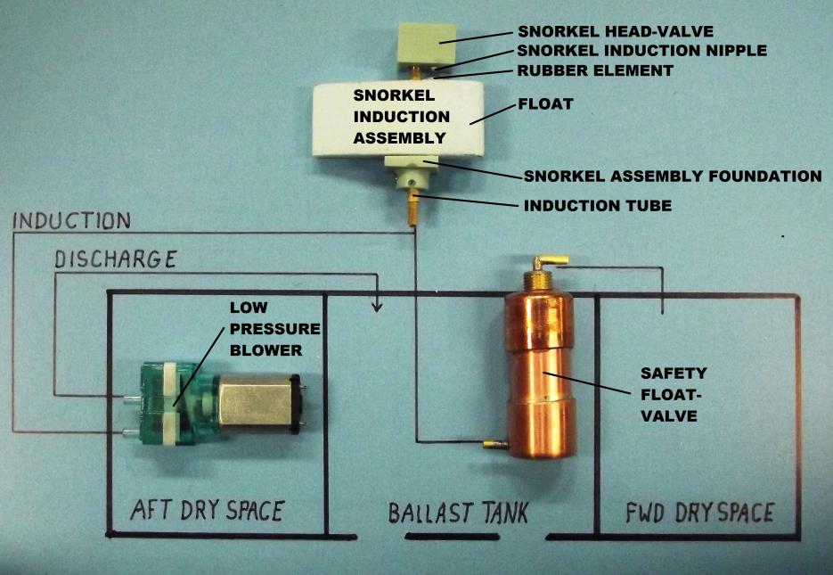

          I am at the YouTube of the Groton Fun-Run 2019! The reason I am looking at all the fun- runs, I am trying to make my mind up about as to how most of you are operating your boats! Most of this YouTube was of your truly David M.
          I do not see a lot of fully submerged boats! Sails under slightly, but a vent tube just above water! It seems to me this is the most popular form of running your boats! I am experimenting with the low pressure pump system using a vent tube, or going with the 70% liquid volume system without the vent to be able to dive deeper and not needing a vent above the water line!
          Advice appreciated!
          "Firemen can stand the heat"
          The 'vent tube', often associated with my SAS ballast sub-system, need not be above the surface (with my boats all of them have this induction tube within the sail where you can't see it) unless you want to lesson the burden on the low-pressure-blower (little diaphragm pump) by taking ballast blow air directly from atmosphere. With the SAS ballast sub-system, illustrated below, the model can start the ballast blow at any depth -- the pump initially takes a suction of the air within the SE to start the blow, but transitions to atmosphere the moment the sail broaches the water.
          Most guys are afraid to operate well below periscope depth. Not me. Demonstrating that these boats need not be married to the surface is this 1/96 SAS equipped SKIPJACK. And, yes, this boat is trimmed just a tad positively buoyant in submerged trim.
          But never count on that slim margin... which goes away if you spring a leak or descend below the point where box compression reduces your displacement to the point of making the submarine negatively buoyant. Bad ju-ju!

          This particular 1/96 SKIPJACK uses the less capable 'snort'. Same as the SAS but without the ability to pull ballast blow air from within the SD. With this one you have to first broach the sail before you can pull air in to blow the ballast tank dry.
