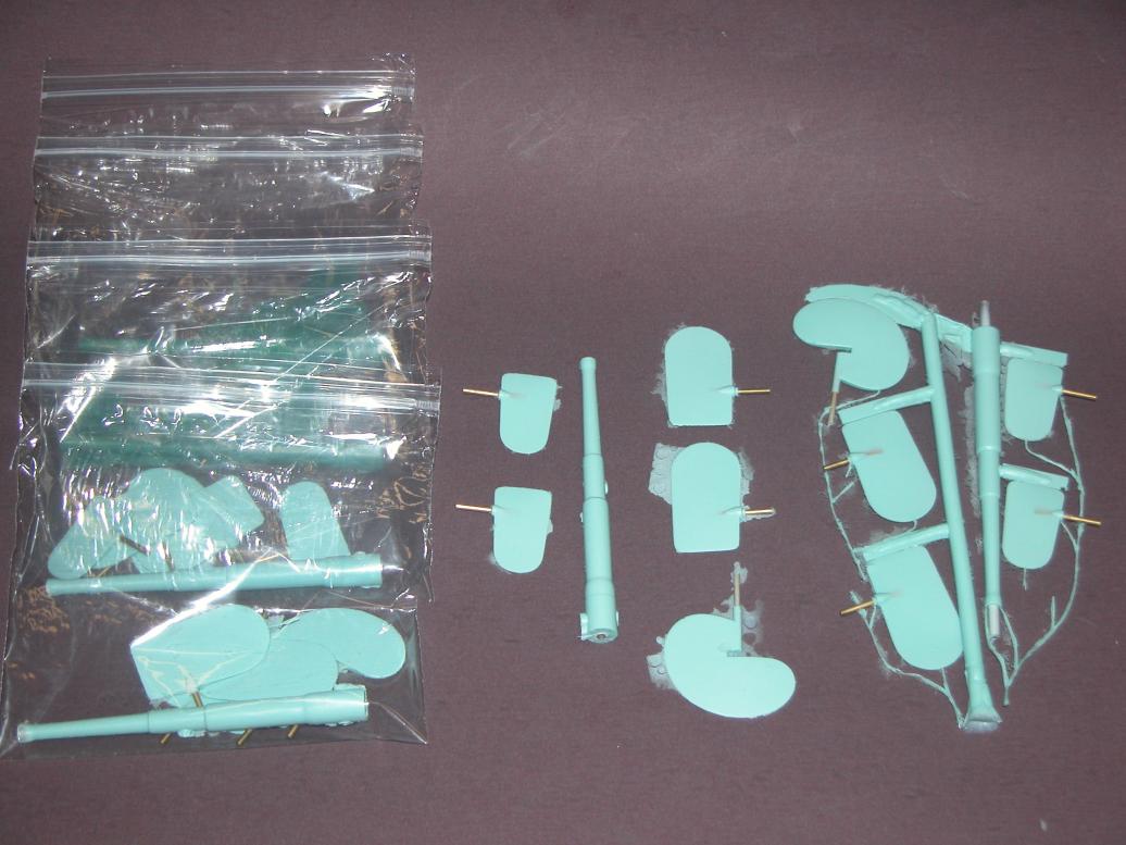

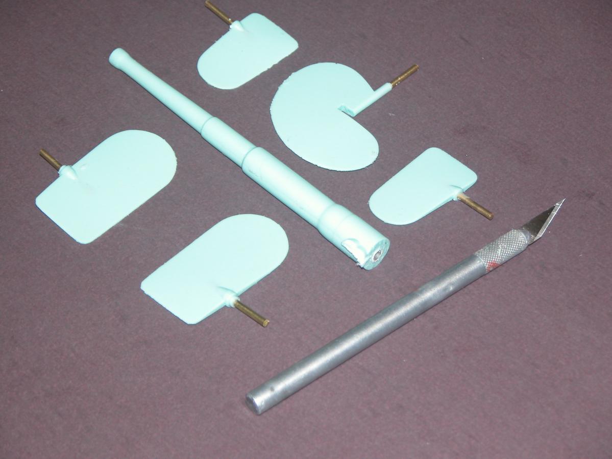

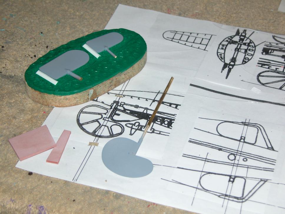

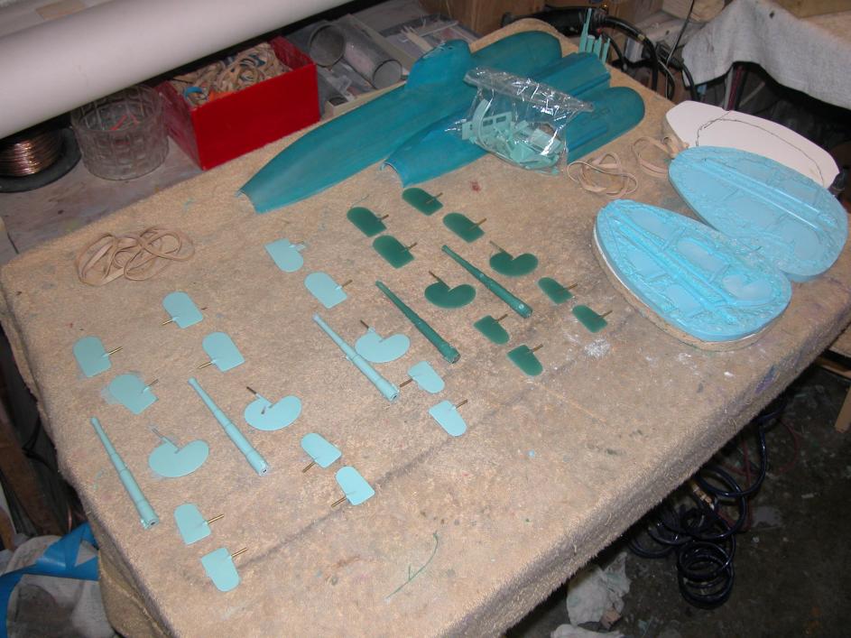

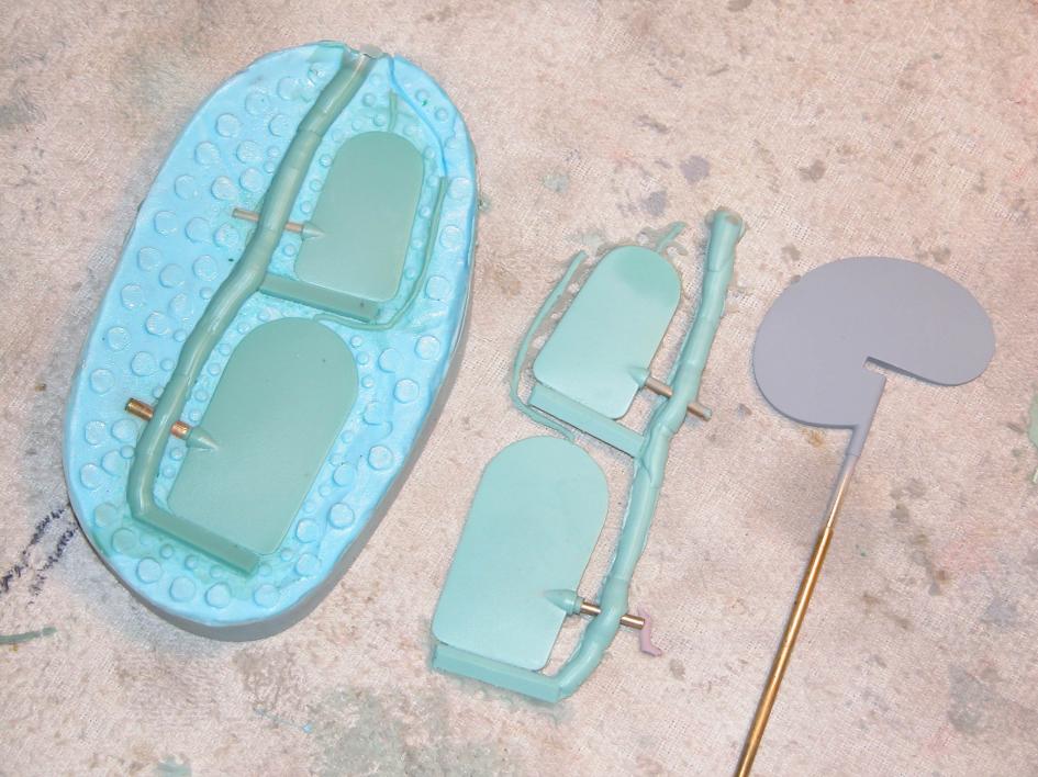

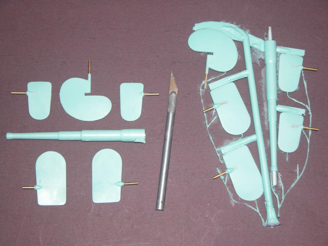

      I produced the fittings kit for the 1/72 M-1 about a half-year ago. Kevin Price had turned a nice brass canon master for Mike and he sent it to me. I then used some of the pictures and plans gathered between Mike and me and went abut the task of making up masters for the bow planes, stern planes and single (big-ass) rudder. I then produced tooling off those masters and from that sold Mike ten fittings kits for a kit who's hull had not yet even hit the street (from Caswell, anyway). I assume Mike is selling those fittings kits to guys who bought hulls from the Canadian guy (sorry, don't know his name, but he does outstanding work!) some twenty-years ago -- basic hull kits sold to guys looking to enter their M-1's at local BB gun shoot-'em-ups.
      (What kind of NASCAR hat waring, tobacco dribbling, sister-banging, toothless, coon-hound breeding, nose-picking, Rebel flag waving moron builds model ships and submarines who's sole purpose is to be blasted to splinters with CO2 projected, big caliber stainless steel ball-bearings?!).
      Anyway ...
      ... Now that I have one completed M-1 GRP hull in hand and another one being laid up in the tools as I write this, I guess I'll have to knuckle under and produce the other fittings needed to make this a worthwhile project. That means I'll have to work up masters for the two propellers, rudder skeg, deck fittings, secondary gun (well aft of the sail), primary gun muzzle door, and whatever other items should be provided to make the package a proper fittings kit.
