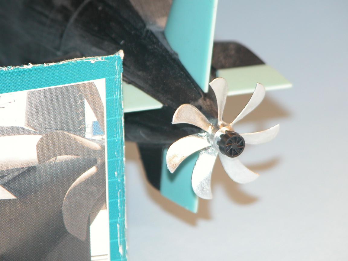

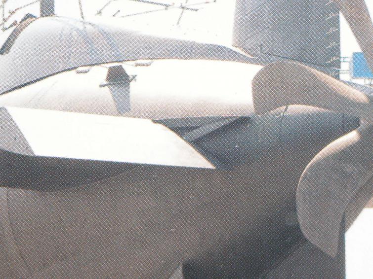

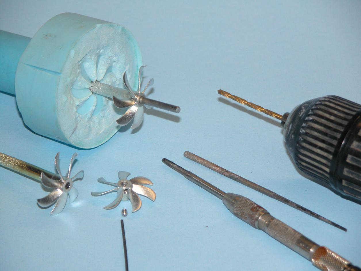

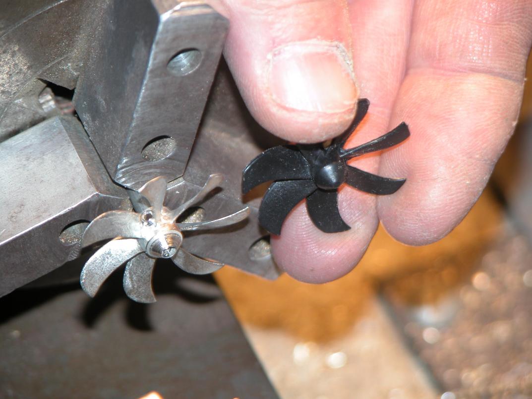

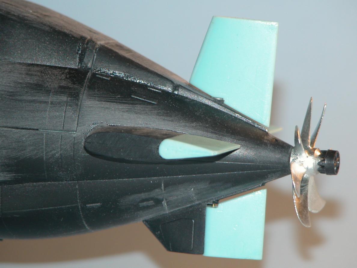

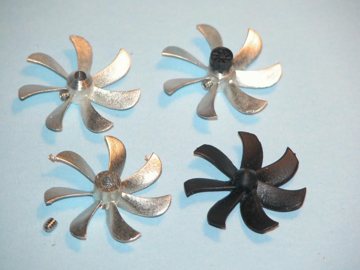

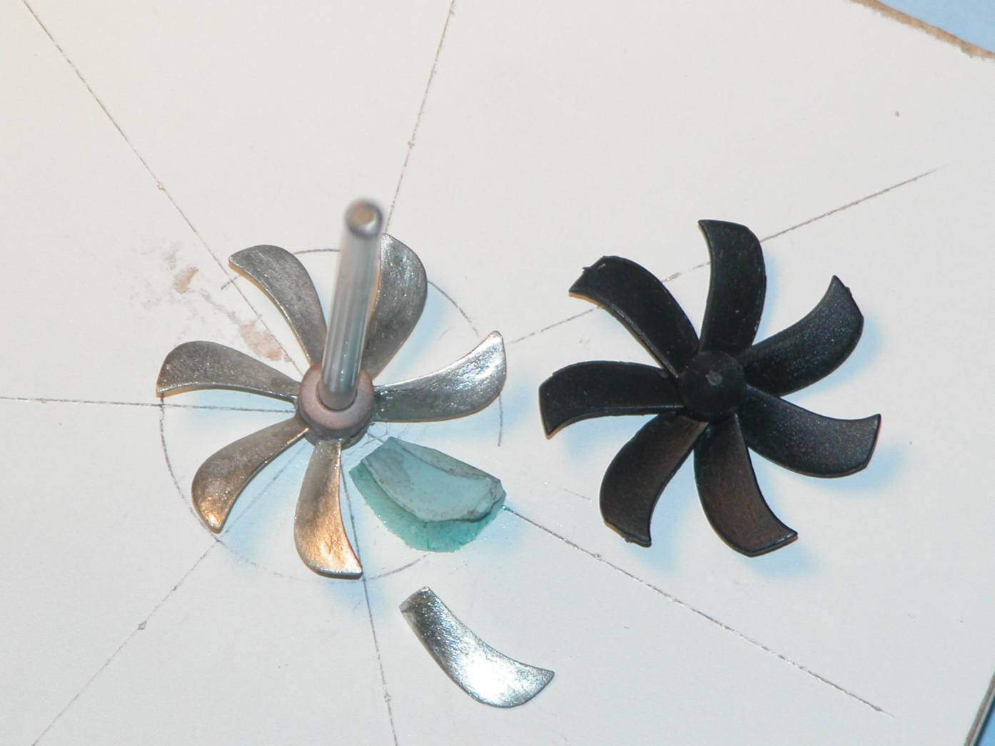

              Just to shut Jim up I finished the basic work on the new 1/144 Revell Type-214 submarine replacement propeller master.
              The kit propeller, though close to looking like what hangs off the ass-end of the prototype does, on closer examination, have way too much cord thickness near the hub, and the blades are way too thick. Yes, the kit supplied propeller will produce some thrust, but a lot of that torque energy will be lost as turbulence and the excessive blade area gives us a propeller that would excessively load down the direct-drive 280 size motor used in the little SubDriver needed for this tiny model kit. Bite me, brushless motor people!
              God! does this mean Skip will jump this thread and hit me with the gear-your-drive-train speech? Again! Somebody, anybody: kill me now.
              Anyway ...

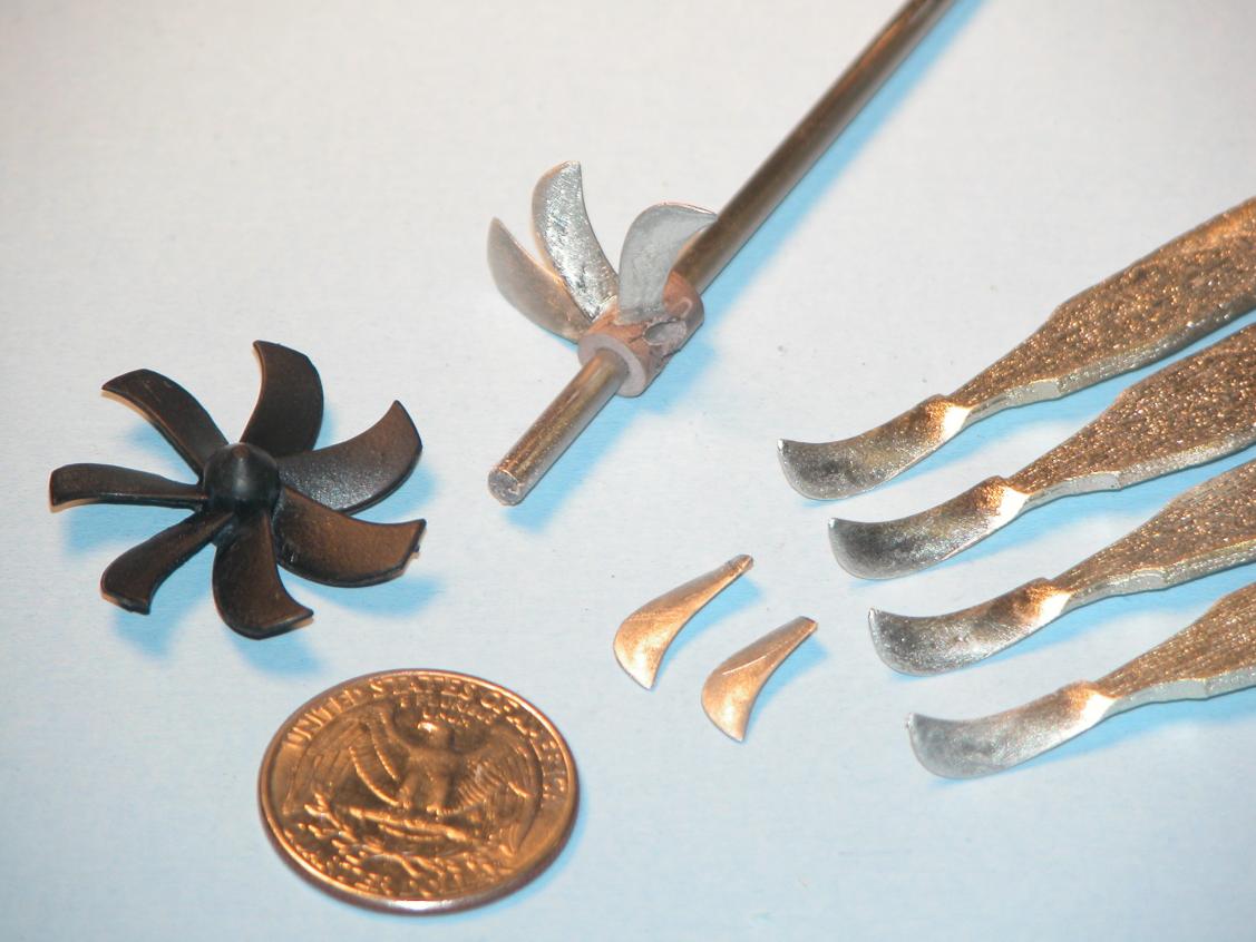

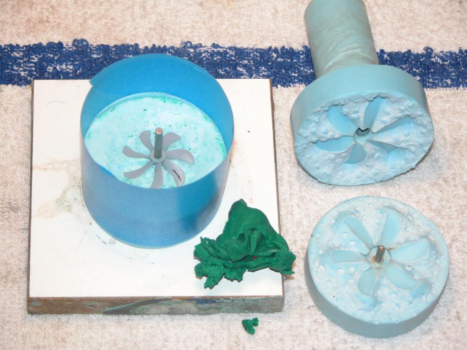

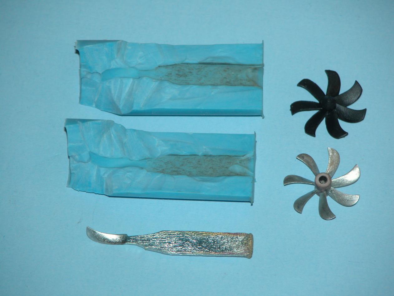

              To make the propeller master I first had to come up with a sketch of the propeller blade -- one with substantially less cord, yet capturing the shape of the propeller blades seen on the kit box (some great reference material there!) and in videos of the real boats you can catch on YouTube. For some great video of this boat out of the water, start with this one: http://www.youtube.com/watch?v=1j9LY...eature=related
              I then plotted out a blade chart to determine the degree of helical twist needed for a blade possessing a pitch 1/2 of the propellers diameter -- I went with this very low pitch (typically I make my marine propellers with a pitch that about equals the propellers diameter) to further unload the motor. The objective of the entire exercise is to achieve a replacement propeller that will be reasonably efficient and will present a much lower load on the motor than the kit supplied wheel.

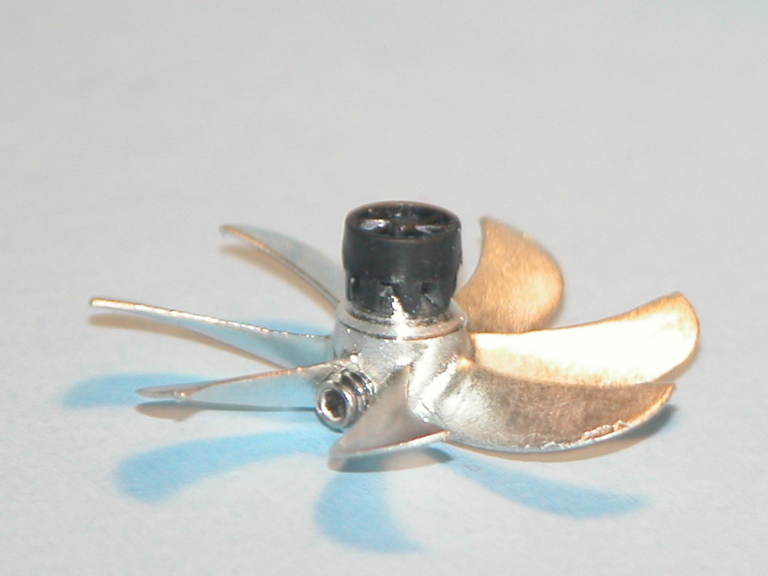

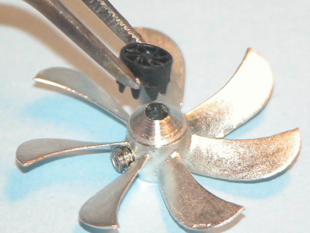

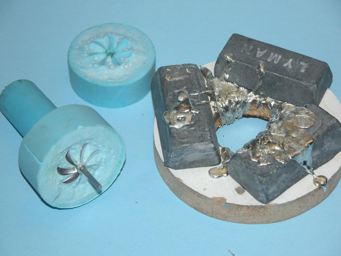

              I carved a single blade master out of RenShape, made a high-temp RTV rubber tool from it, cast up a bunch of white-metal blade blanks, assembled those blades to a RenShape hub, and wa-la! a new propeller master. Tomorrow I build up small radius fillets between blades and hub, clean things up, prim the beast, then make a production RTV tool from which fittings kit white metal propellers will be cast. There! Happy, Jim?
              Nothing to it.

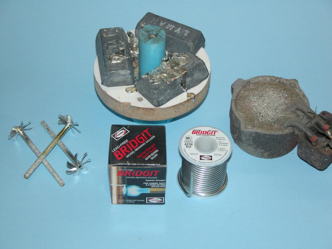

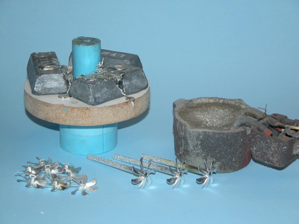

                          I cleaned up the propeller master, used it to make the production tool, and went about the task of casting up a bunch of production white-metal propellers for the little 1/144 Revell, Type-214.
