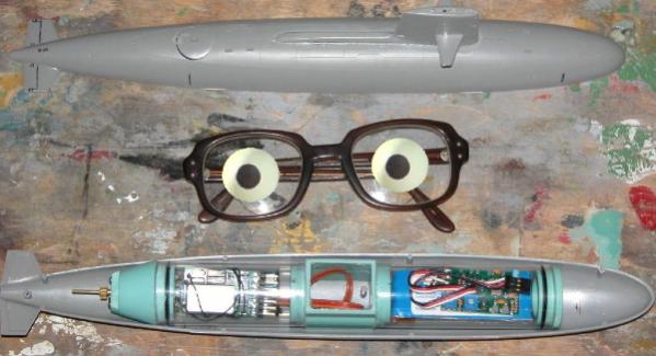

          Arghh! It's those glasses again! The way they look at you!
          Then I realised, Merriman is also employed by Geico - The insurance company.
          15 minutes could save you 15% or more on your car insurance.
          No wonder those torpedoes are taking so long!
