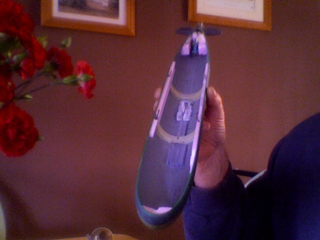

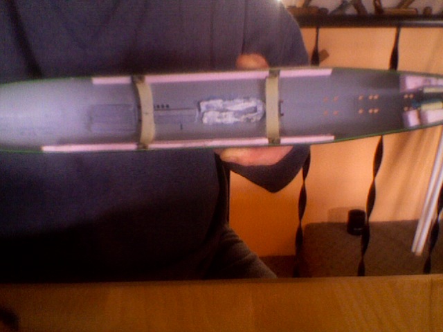

    I am fiddling with my model Kilo, getting ready for a pool run, and in the bottom of the hull, Mr. Merriman had written the weights down. I thought this might be useful to members.
    Forward 5.43 oz
    Center 1.1 oz
    Aft 0.5 oz
