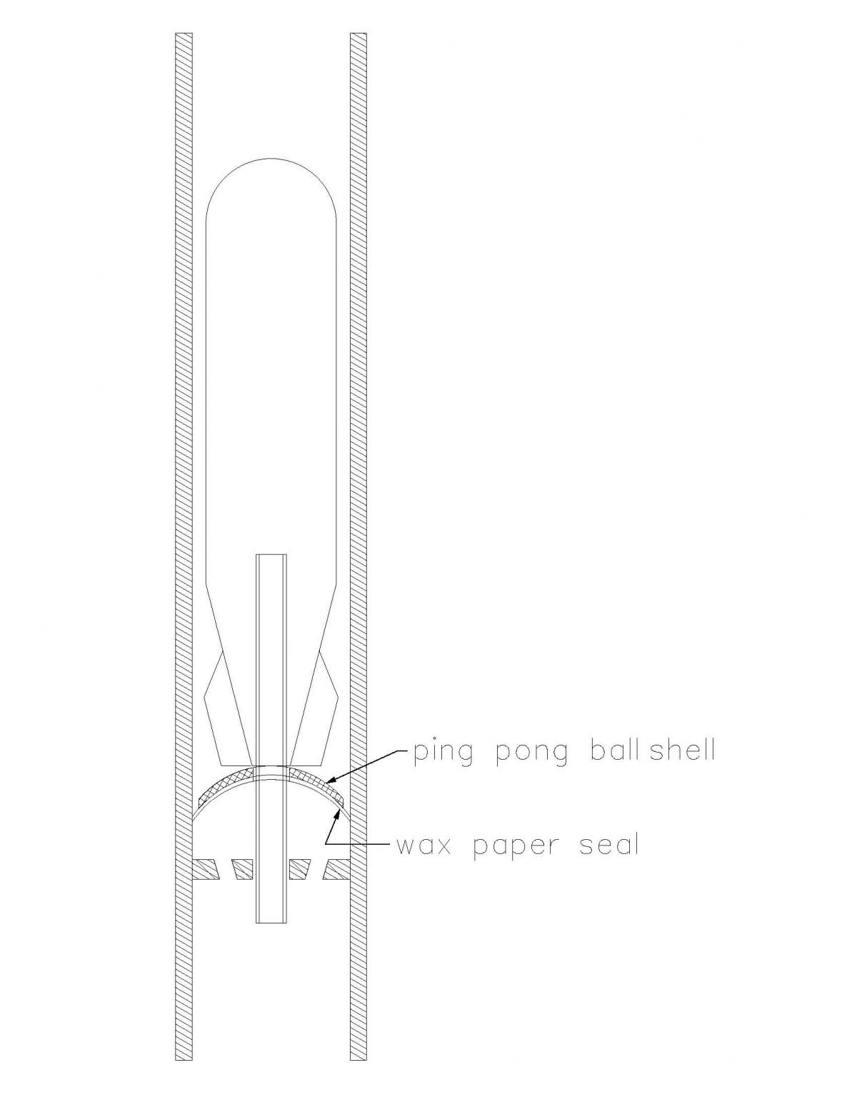

ID:	60834A circle cut from a ping pong ball might make a sabot for firing a torpedo. Cliping the edges might make a flexible fringe to engage the cylinder walls. Or wax ring see illustration.
      Or use the ping pong ball circle attached to a stick to make a ram to insert a wax paper
      ring with the correct shape.
      Scott T

        Originally posted by Scott T
        [ATTACH=CONFIG]5722[/ATTACH]A circle cut from a ping pong ball might make a sabot for firing a torpedo. Cliping the edges might make a flexible fringe to engage the cylinder walls. Or wax ring see illustration.
        Scott T
        Keep it simple. A sheet of .005 styrene plastic, two punches (one for the outer diameter of the dist, a non-interference fit to the tube bore, the inner hole to fit around the torpedoes nozzle tube) and you have a sabot disk, ready to slip over the torpedo nozzle tube and up against the trailing edge of the fins.
          It would be good to see a photo of this, us 'Great Unwashed' are having 'visualisation problems here!
