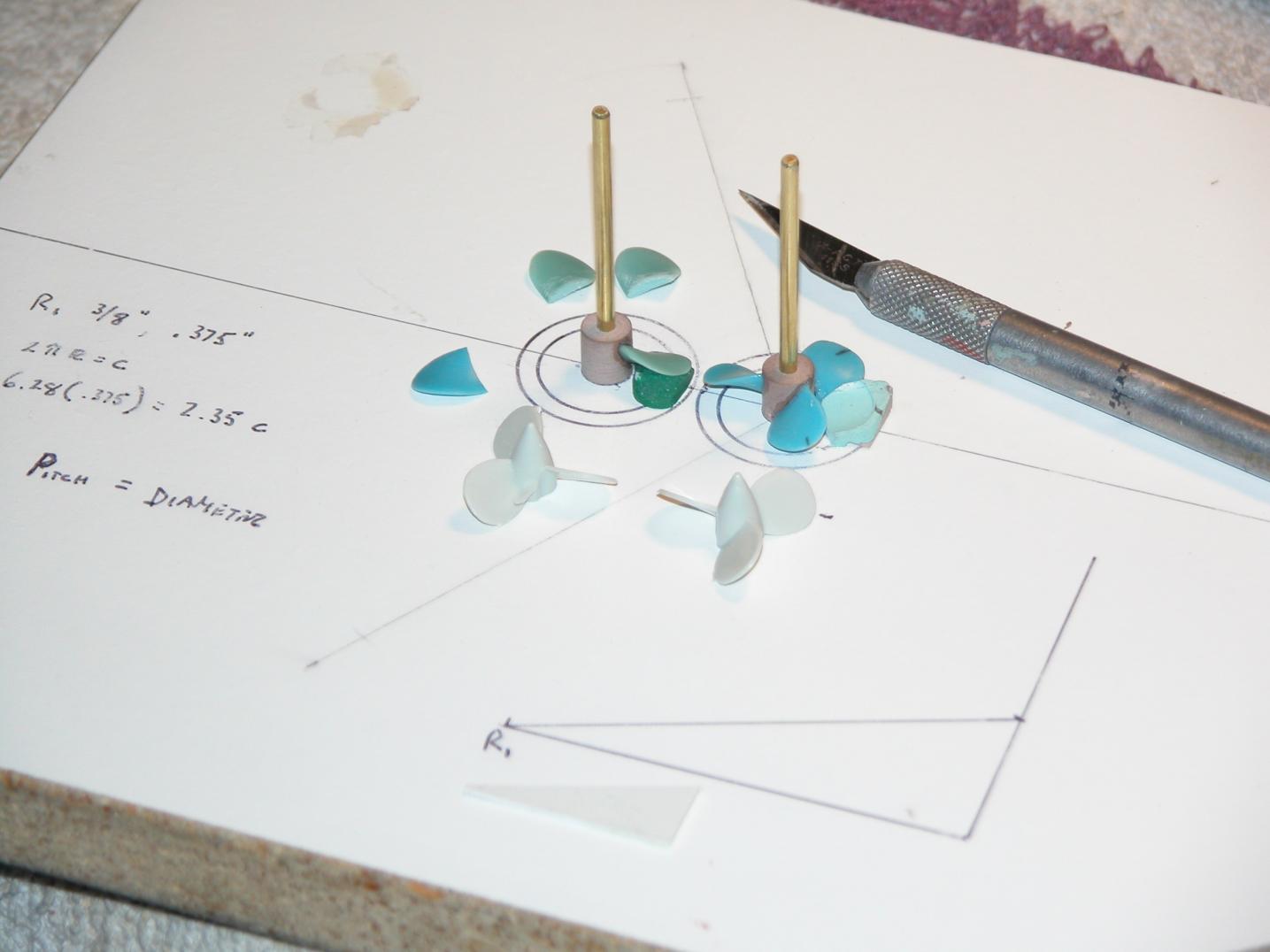

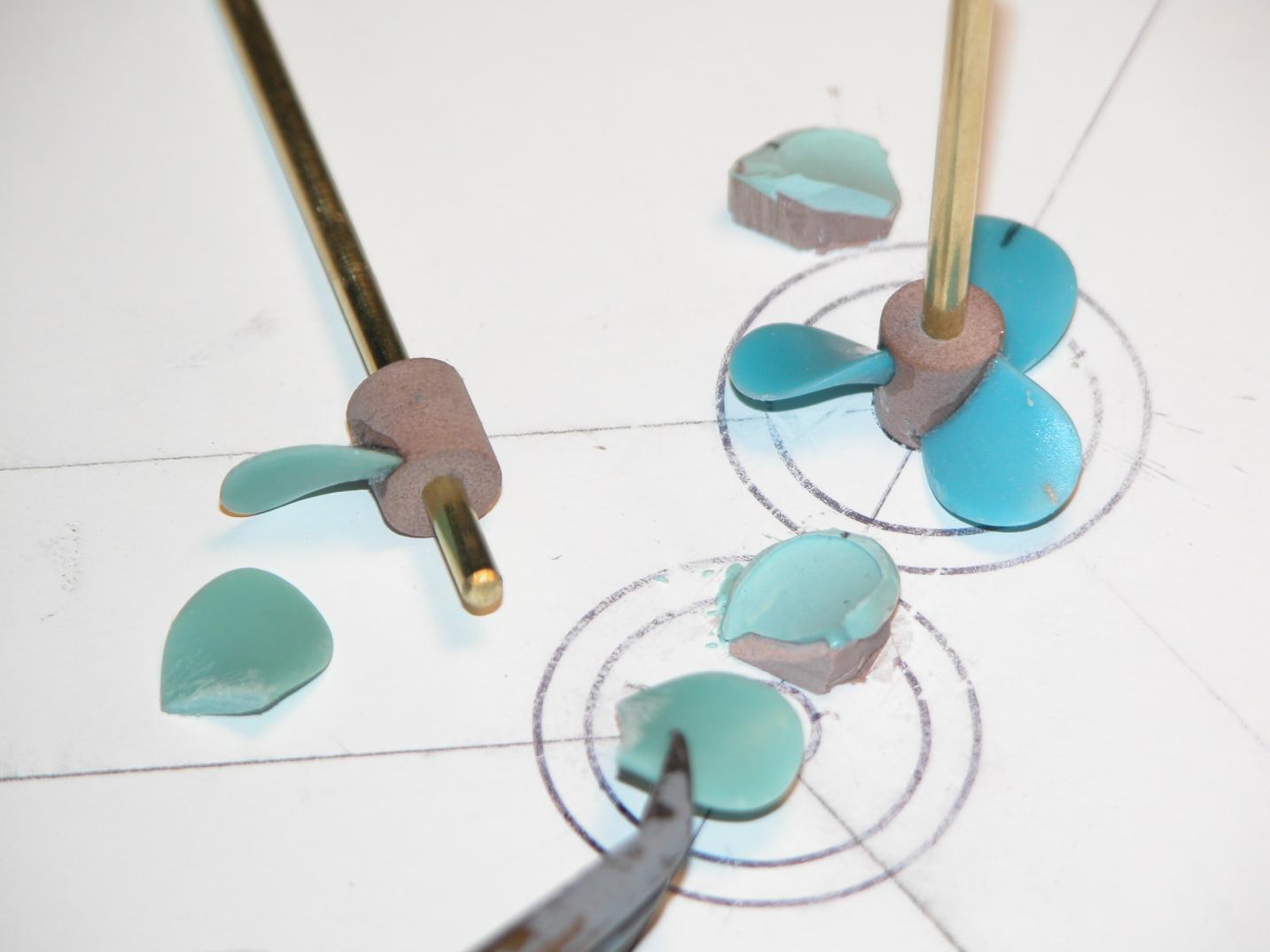

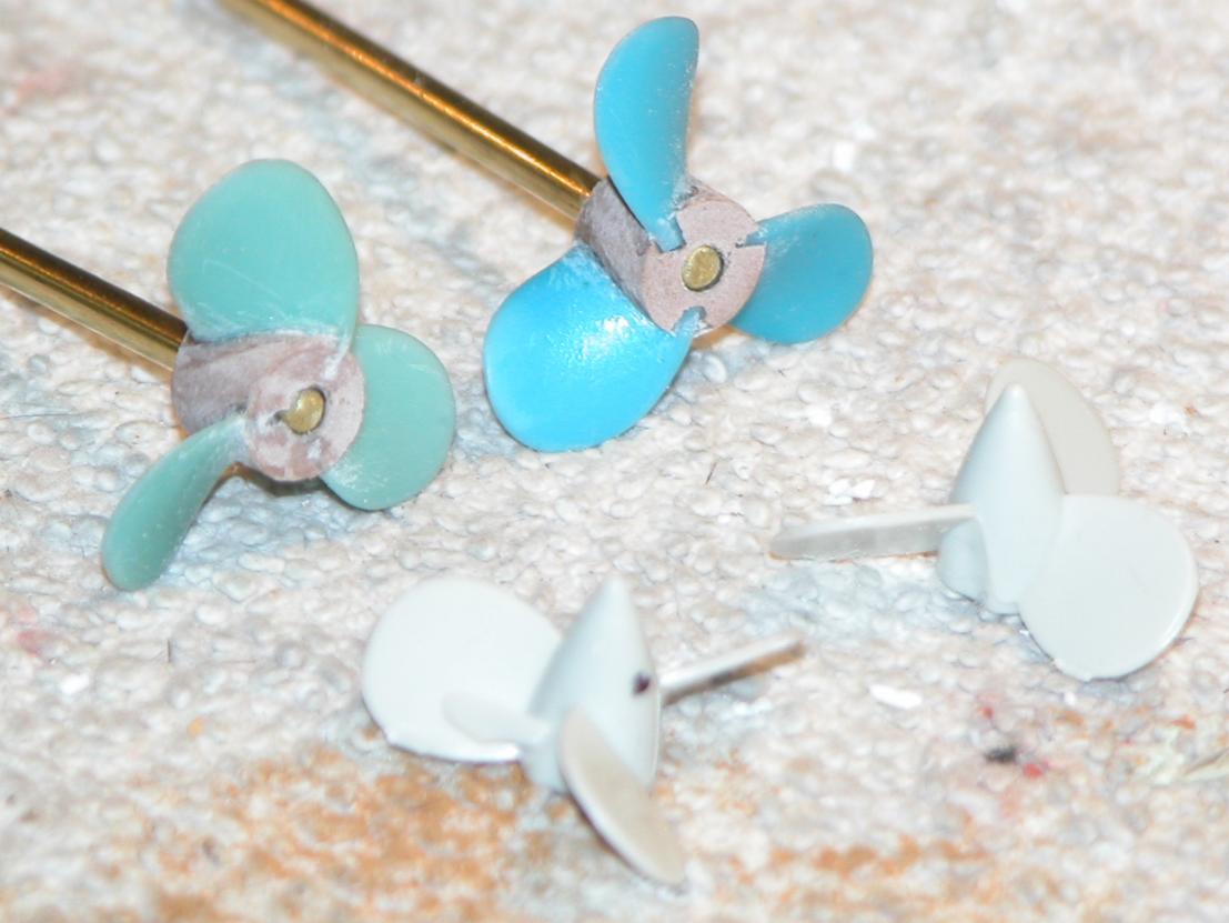

              Just finished the replacement propellers on the Type-7 fittings kit. I've finished the thrust bearing foundation and am well along with the rudder linkage foundation. Tomorrow I make the masters for the magnet foundations that will be used to hold the deck down onto the hull.

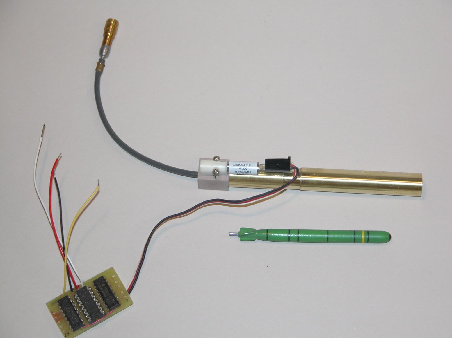

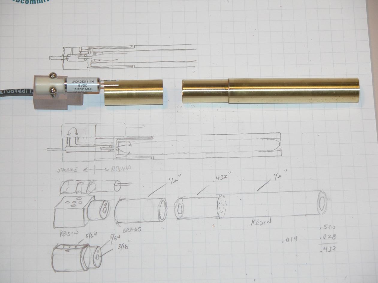

              Concurrent with the fittings kit work I'm working up the prototype of the latest version of the torpedo launcher -- I've test fit it into the bow and stern of the 1/72 Type-7 and am pleased to report that not only is there room in there, but plenty of room left over between the torpedo tubes and SubDriver! Wow! Same with the 1/72 GATO.
              What's made all this possible was Mr. Caswell's identification of a new source of solenoid actuated valves that can be directly mounted to the breech-block of the torpedo tubes -- eliminating the need of a separate (and bulky) torpedo launcher gas distribution network. Film at 11.

                Thanks for that Torpedo update.....
                does that mean that the electronics linkage shown on the tube will have to be waterproofed within a separate WTC?

                  I would like to keep the switch in the wet, that would mean potting the board and the plugs where they make up to the solenoids. Still playing with various waterproofing schemes.

                    Based on the length measurements of the whole assembly (i used the servo plug as a reference and proportioned the length) this system would fit into a 1/72 Permit with 10 degree angled tubes and snugly fit against a 3.5" SD OD.
                    I based the angle opening on tube OD of half an inch.

                      Good sleuthing, John.
                      Yes, .5" tube diameter (bore is about .25"). Length of the launcher is about 4.5", but what you are looking at is a functional mock-up, subject to length change as I work out the launching mechanism details. Yet to be installed is the muzzle door and interlock shaft that runs between breech-block and muzzle door.
                      I'm going to provide the forward tube portion with foundations that will permit vertical stacking of tubes and interconnecting of the port and starboard nest groups. The objective is to produce a single torpedo tube (launcher) that can be stacked and packaged with an adjacent stack to make up an entire torpedo tube nest that can be removed from the submarine and serviced in mass.
                      Torpedo loading and charging chores are done with the nest in place, removal of the nest done only for maintenance or repair.
                      I won't be giving up any detailed looks or drawings till Mr. Caswell secures patent protection and completes some word registration and trade-mark tasks. Stay tuned, sports fans.

                        With all the excitement about the torpedoes, no mention of the props. They certainly look good and it's interesting to see how your prototype construction methods (individual blades with roots embedded in the hub) mirror that of full-size construction.

                          Well thanks anyway David for the sneak peak.
                          I can only imagine then that the forward compartment of the SD would be used also for connecting the firing mechanism -switch etc to the RX through a conduit in the BT (back end of the 3.5" is rather busy)?
