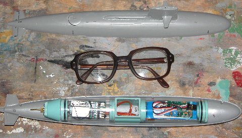

            It's Here from The Wizard's cave!
            He's a GIANT! Just look at the size of his specticles!
              We are not worthy! We are not worthy! :D
              Can you give us spec about this new sub-driver.
              In cabal report section you mentioned that this is a dynamic diver.
              That center section sure looks like a ballast tank to me.

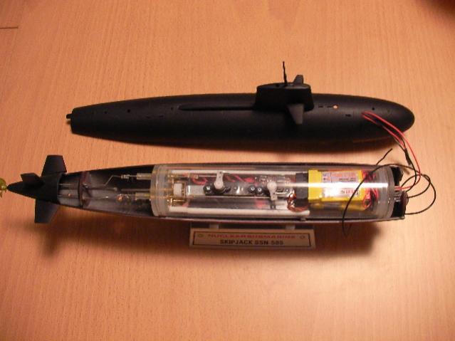

              Much better looking that this Japanese version.

                I really Like the Servo linkage shown in the video. Tho more difficult to fabricate, it eliminates the sideways force caused by the ark of the servo arm, which causes a lot of drag in linkage. With those Micro servos a little extra Drag at the seal can cause a big problem, but that design fixes that problem. :)

                  Nope! No specs yet!
                  Yes, it does look like a ballast tank, because it is. Concept is that with ballast tank full, the boat is trimmed to be slightly negative with the tip of the sail out of the water. Once in that position, forward thrust will make it dive deeper. No forward motion will allow the boat to almost surface, and the Snort system will bring it to correct waterline position.

                    So it operate the same way as the previous 1.5" micro snort sub-driver, using a solenoid valve to vent the ballast tank and a micro airpump to blow ballast.

                      Mike,
                      Let me step in here: If they're talking about the little SKIPJACK 1.25" SubDriver then, no, there is no ballast sub-system -- it's a dynamic diver. The box looking affair is a 'servo box', that's what it does, forms a containment for two little servos to operate the rudders and stern planes. This particular boat will be trimmed only for submerged operation, decks well awash.
                        • 14011
                        The SKIPJACK will not employ a ballast sub-system aboard its SD. And those ballast sub-systems I do employ do not use solenoids! Servo actuation only.
