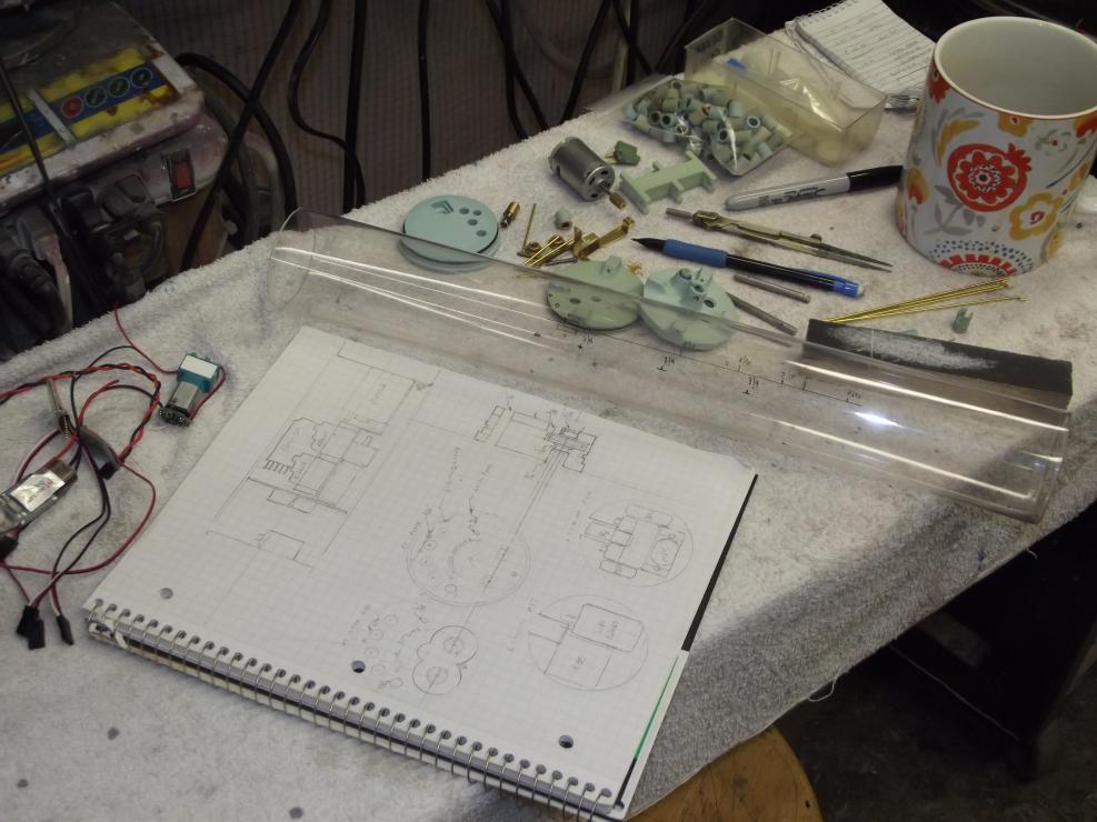

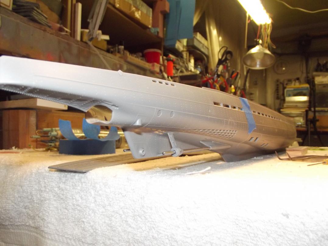

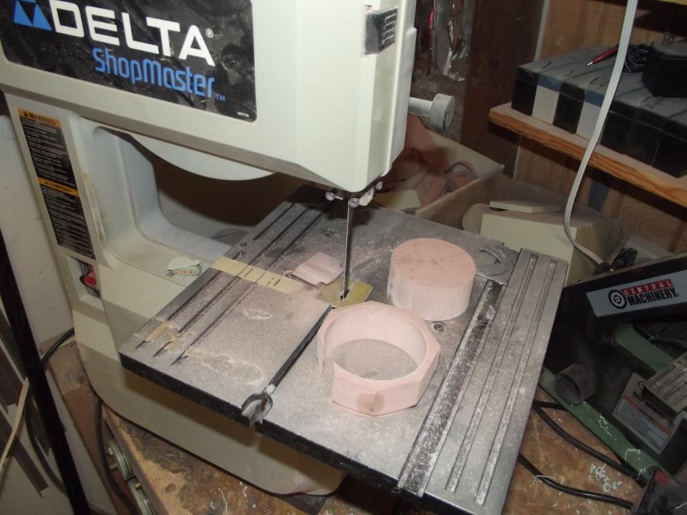

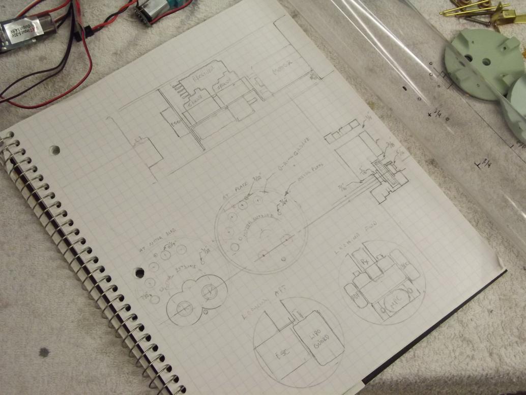

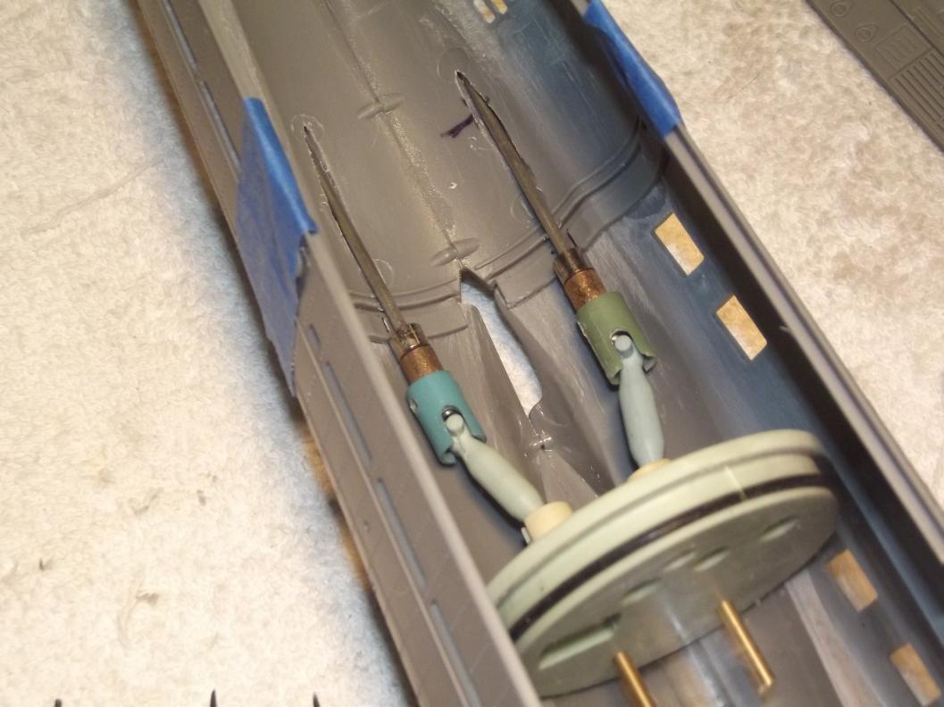

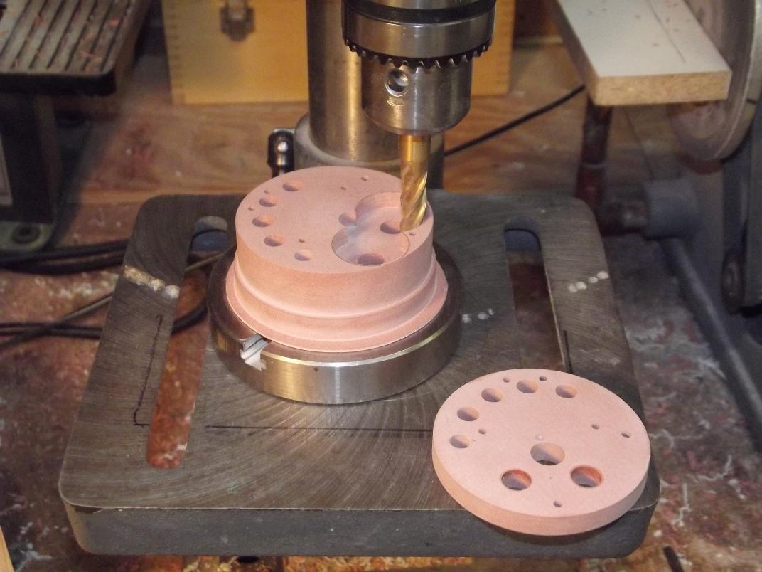

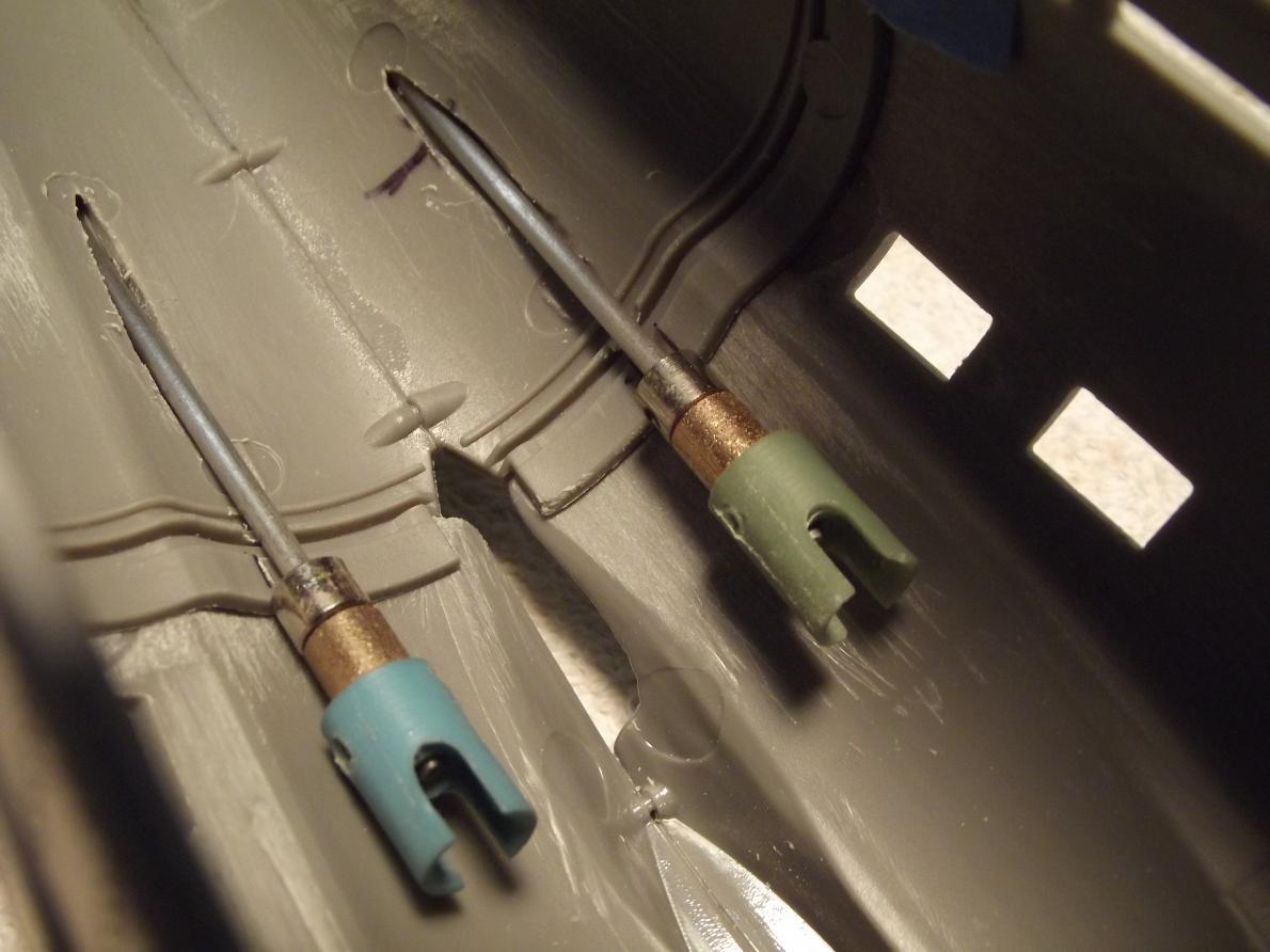

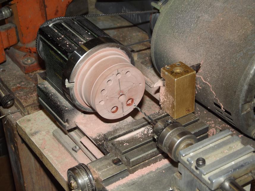

      Meanwhile ... back in the Bat-Cave:

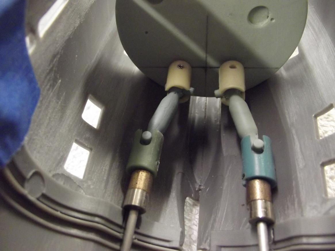

        [QUOTE=He Who Shall Not Be Named;30903]Meanwhile ... back in the Bat-Cave:
        pretty tight angle onto the props, is that going to be noisy?
          • 14012
          And I expect to loose at least 20% of the available torque to the gears and universal. Screw it, it'll work.
            Its a bloody awful alignment David. the torque loss is one thing, the increase in fuel consumption (battery life) via additional amps that arrangement flicks up will be interesting.

              Just about, John.
