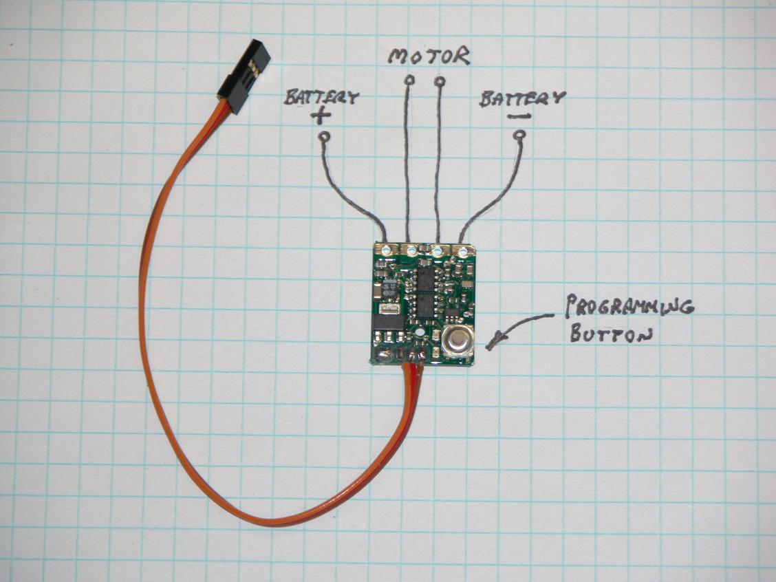

    So, I got the Micro ESC, and there are no wires attached to it. I have looked at the documentation, and cannot figure out which of the 4 solder pads are for what> I really don't want to fry this thing.
    Any ideas, if I am looking a it, with the button facing up, and the Rx wires facing to the right, the four pads are along the left edge of the esc. from top to bottom, so...... um..... which is which?

    After I get back from the run I'll lay one of those ESC's on graph paper and I'll draw lines leading off the edges and pointing to the pads, and then denote what wire goes where and does what.
    And, yes, the breaks (radial cuts) occur at the raised 'weld lines' on the hull. When I do the ESC markings I'll measure those cuts and give you a weld line count, fore and aft.
      • 13984

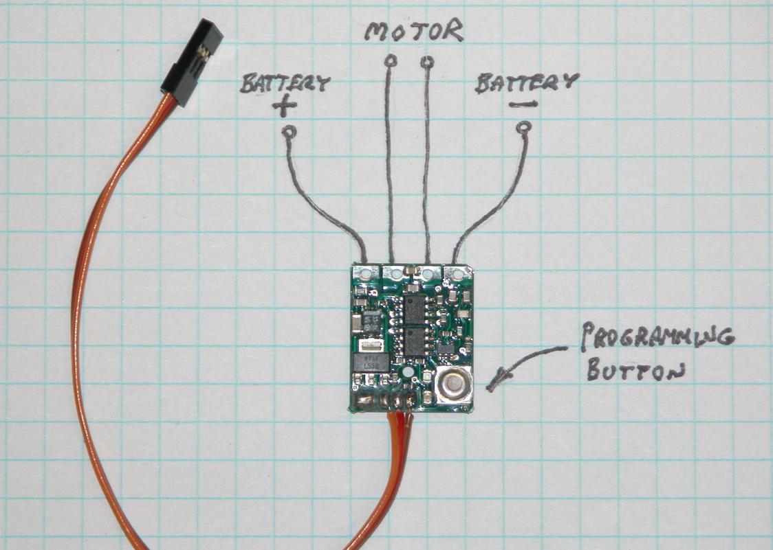

      Here's the promised illustration on how to hook up the little ESC for your SKIPJACK.
      You'll note that this is the identical circuit that comprises the MTronics Mini 10 marine ESC, but without the aluminum channel heat-sink, epoxy potting block and attached wires.
      The ESC switch pads have already been soldered 'closed' so when you make up the battery to ESC, everthings 'on'.
      Isolation of the entire SD system is through the single mission-switch located in the forward bulkhead of the SD. That switch wired in series with the battery and ESC.

        Thanks very much. I had figured that was the pinout, but I did not want to fry anything. It's cheaper to ask.....
